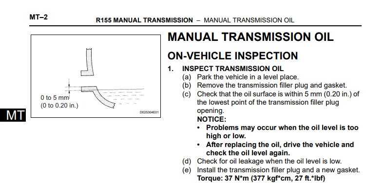

    If you place the sensor where the plug goes, temp would not be accurate...

    Edit: I'm taking the reading off the drain plug, not the fill plug.

    @caribe makaira was probably thinking you would install the temp sensor in the inspection plug, which might not have good contact with the oil. But then again it might when everything is in motion.

    Gotcha. I agree that would not do me much good unless oil happens to be splashing up at the fill plug, but that's not my plan. Planning to replace the drain plug on the crawlbox and trans with one that has a temp sensor so if I'm not coming in contact with oil I have a very different problem.

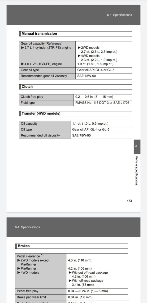

    Trans currently has Redline MT90 GL4 75w90, but I will be swapping that out for Redline's GL5 rated 75w90. The tcases are just running regular valvoline 75w90, but they will both be getting the MT90 GL4 swapped in when I drain them. So after I do the sensors it will be redline GL5 in the trans and Redline GL4 in both tcases.

    Please correct me if I’m wrong but GL4 is required for the MT, due to the brass syncros?
    Also, correct me if I’m wrong again here, but GL5 is required in both the diffs and transfer case?
    I too run RedLine:
    MT-90 in the MT
    75w-140 GL5 everywhere else

    I've read that too, but my service manual says GL 4 or 5 in both trans and transfer. :notsure: Our resident toyota mechanic here in the CO threads suggested I look at the GL5 rated stuff last time I put the MT90 in.
    I have been running GL4 in everything...diffs, cases, trans since I've owned the truck. Nothing has blown up yet. :fingerscrossed:
