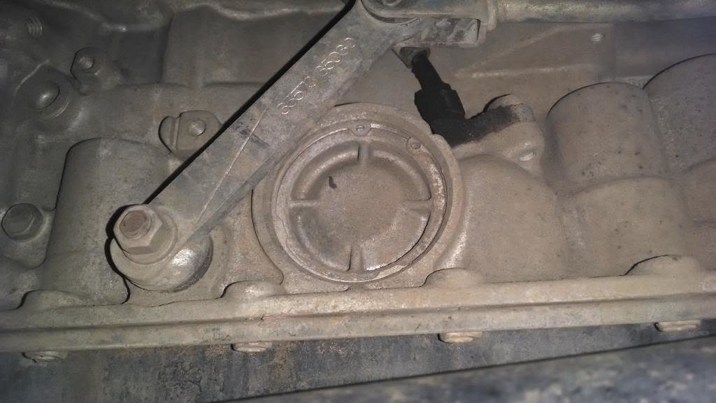

    I'm guessing this is it?

    Using the picture above , there is a test port at the left rear . Looks like the manual linkage will be in the way .
    The round cover behind the manual linkage is a servo which in a nutt shell applies the band .
    The black plastic cable is used to tell the transmission how deep you have your foot into the gas pedal
