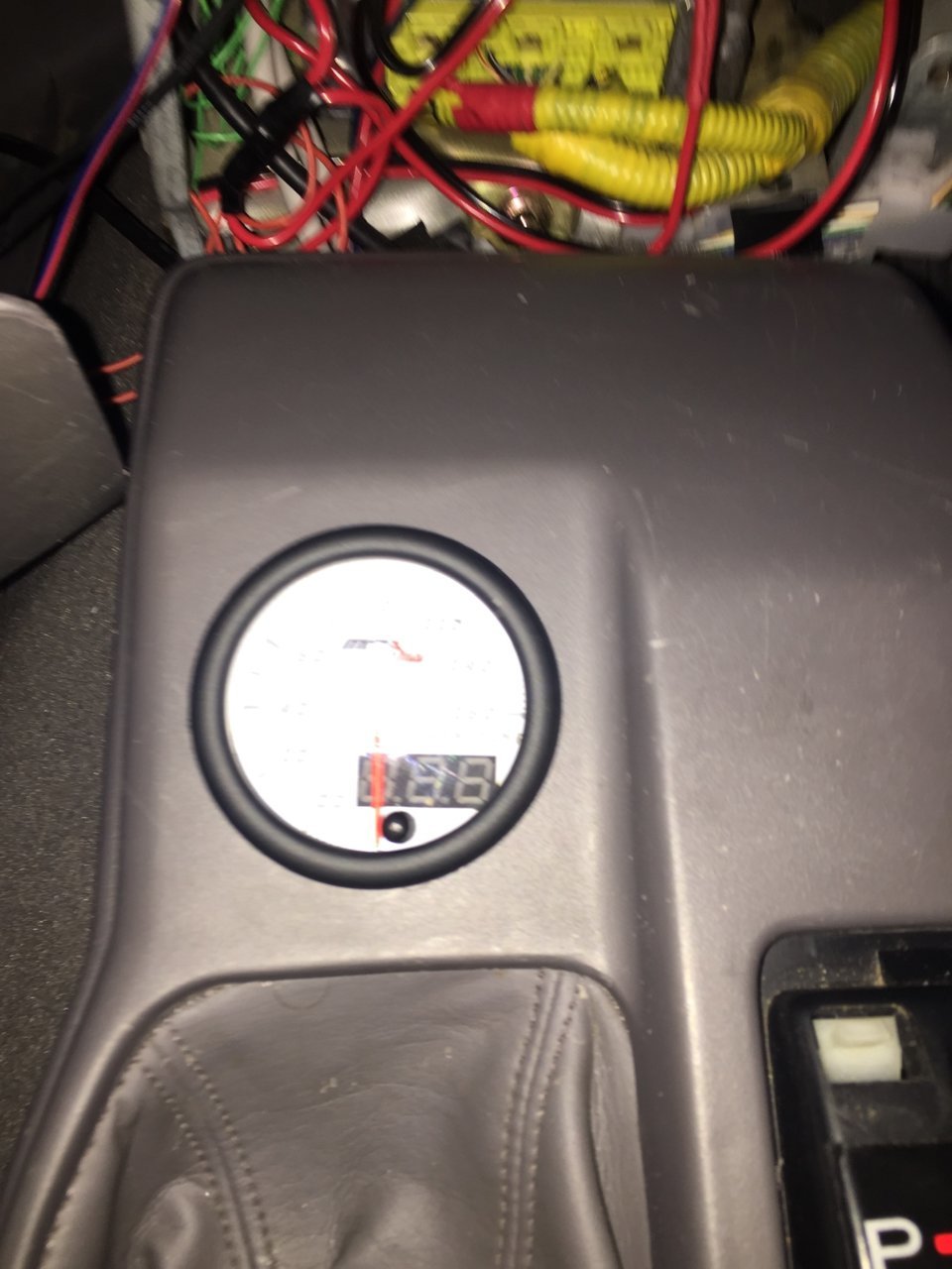

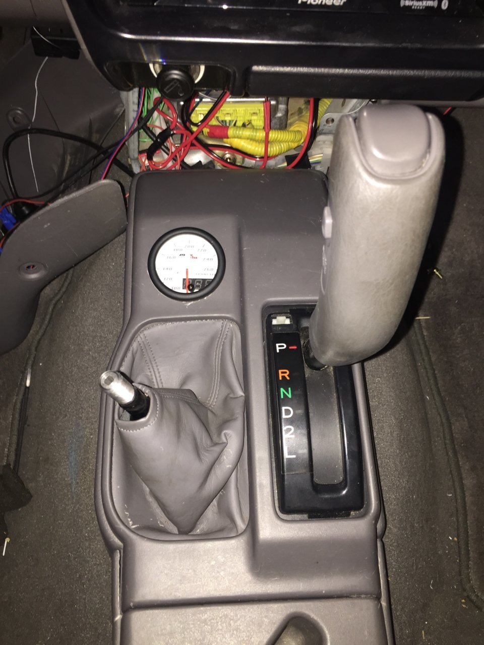

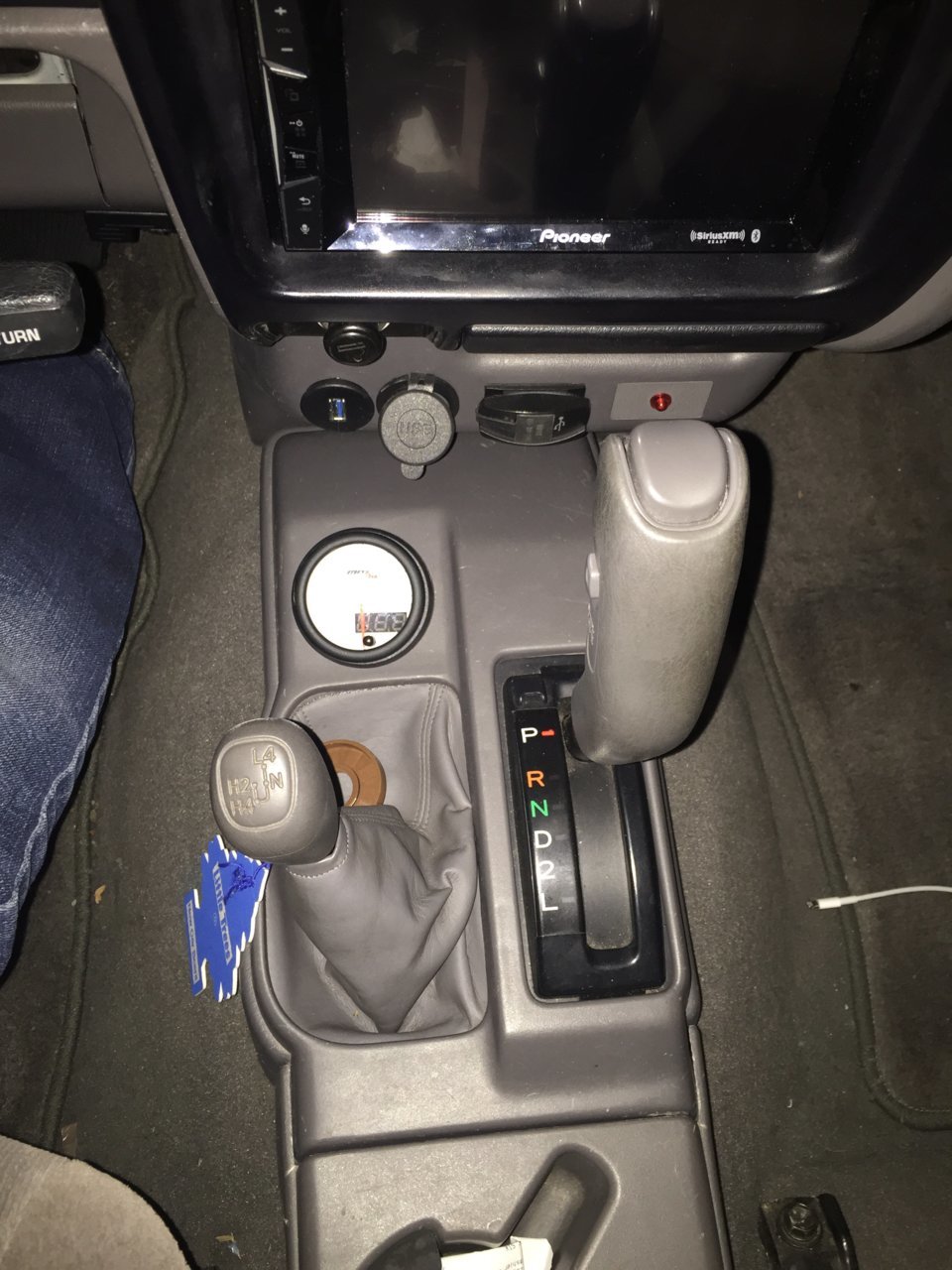

    View from directly above

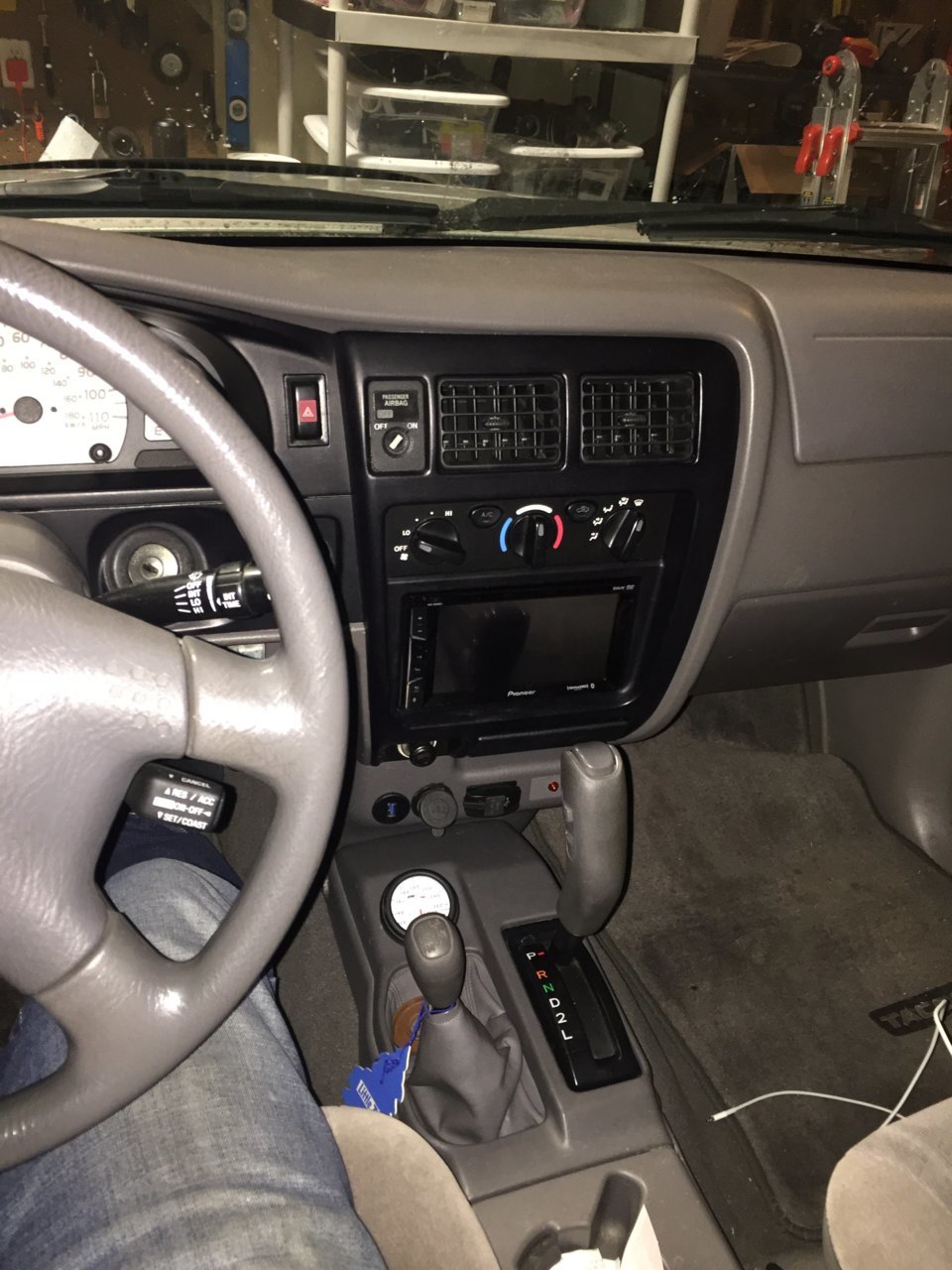

    View from sitting back in seat .
    As you can see the 4 Wheel Dr. shifter somewhat blocks the view
    But you can lean forward a little and see it just fine .

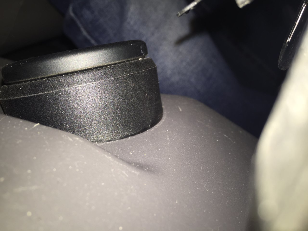

    I highly recommend a Auto meter angle ring
    I pointed mine up and to the left
    You may have to move some of the shifter harnesses under the plastic
    Also, you will need to cut one side of the bracket that comes with the auto meter or bend the auto meter bracket to get it to work at an angle .
    From here
    To here
    I fasten them down with zip ties

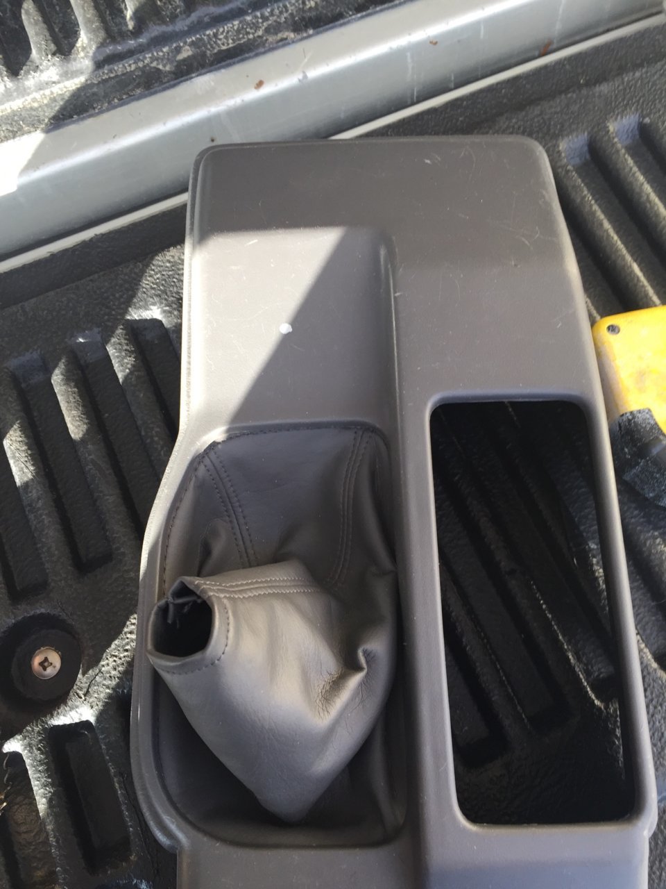

    4A201C79-1DB1-4A20-B886-444CB897DE8A.jpg E11C4558-1F7C-418D-82F1-0C241F998FFD.jpg D329EADE-0513-46F2-BCF1-C30C6C33BB83.jpg

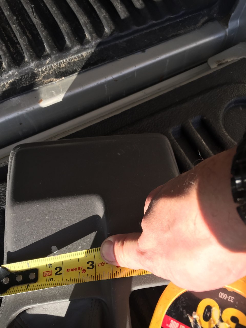

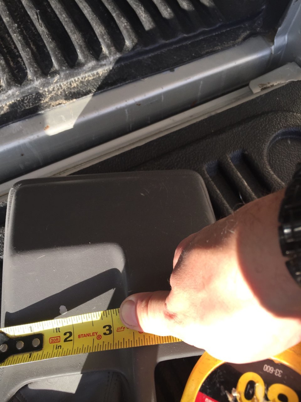

    Like my pappy always said ... Measure twice
    Cut once...dummy

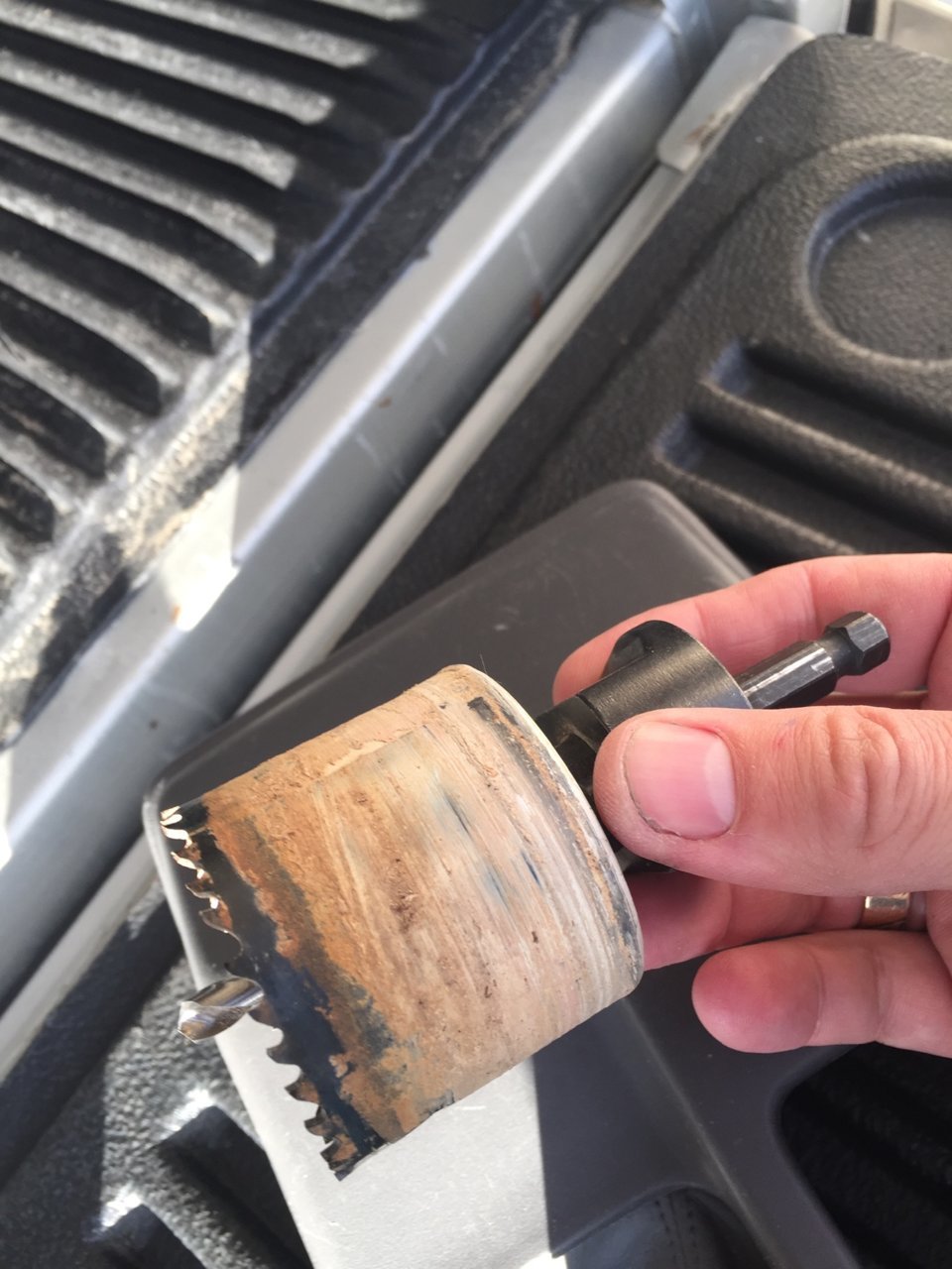

    Don’t forget to double check the millimeters of your gauge versus the millimeters of your holesaw. Holesaw should be Slightly smaller

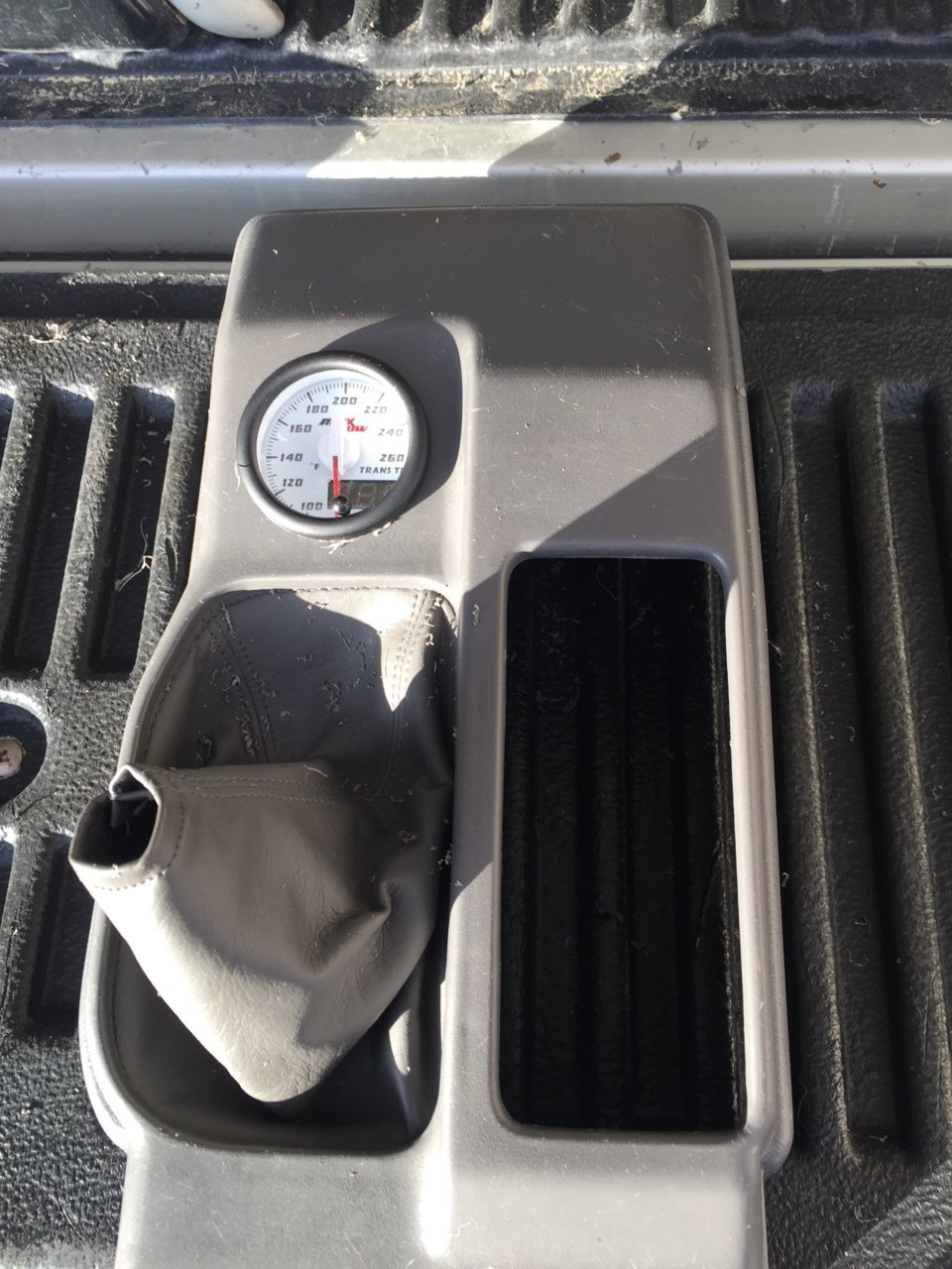

    Here it is flat mounted... I added the gauge ring later
    In the truck , Clears just fine flat mounted.. after moving those harnesses
