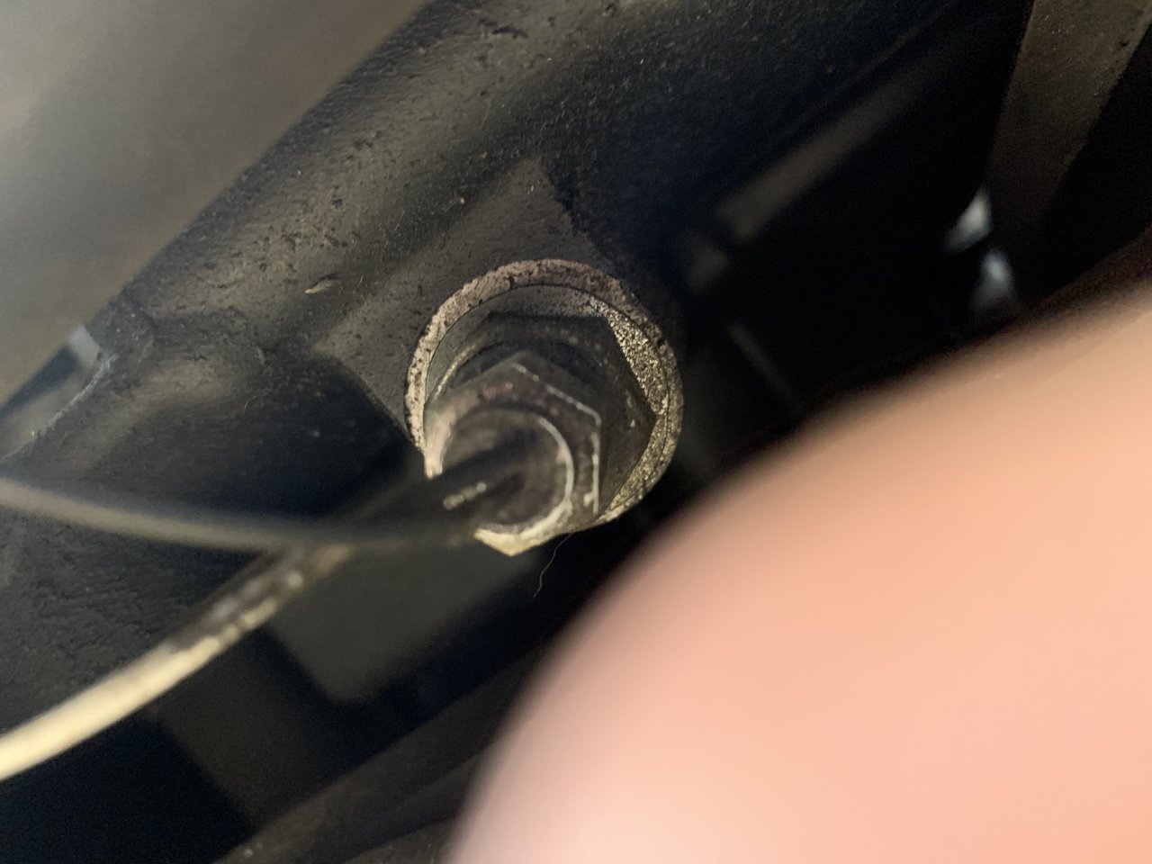

    Just find thread for drain bolt and most sensors are 1/8 27 pipe threads. I put quick disconnects so just remove wire and unscrew and drain. Here is the sensor on my bikeBA37492D-81AB-41A7-A428-E5DBC6D3D853.jpg

    Yes, I think the tapped drain/fill bolt is what I will end up using. Thank you everyone
