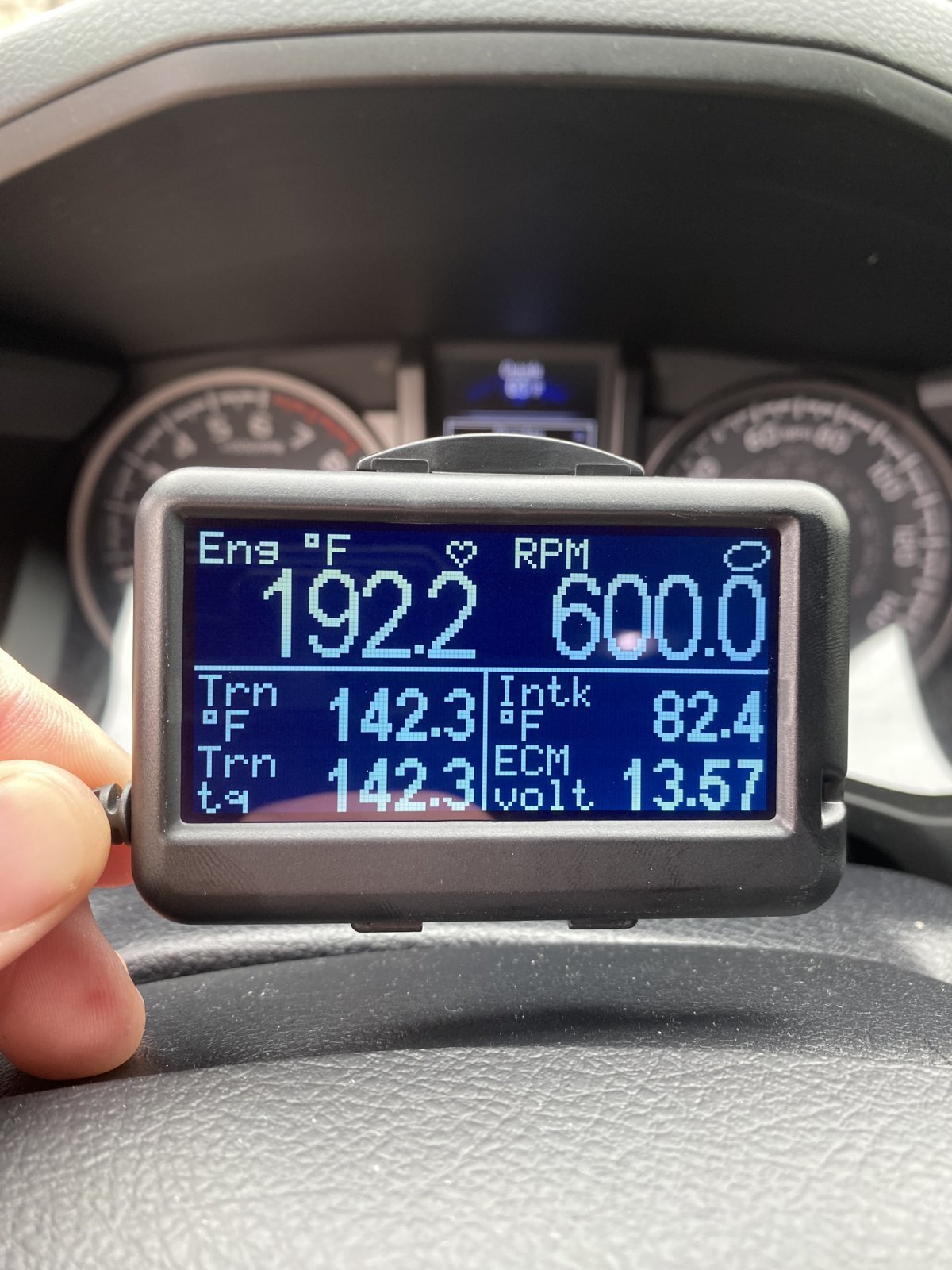

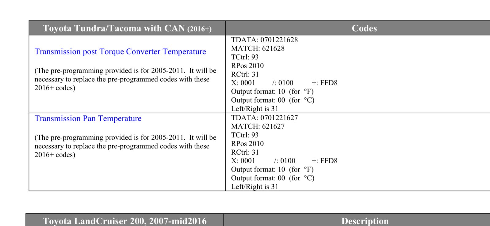

    Just got my UltraGauge MX ordered the Tacoma/Tundra Can
    Running in a 2021 Tacoma 4x4 TRD OR
    you have to change the programming to what’s in the picture below.
    and bam! Trans pan temp and post torque converter temp (as far as I know they are separate readings, will update after some driving to test.)
    Bluridge120 and Inyo_man like this.
