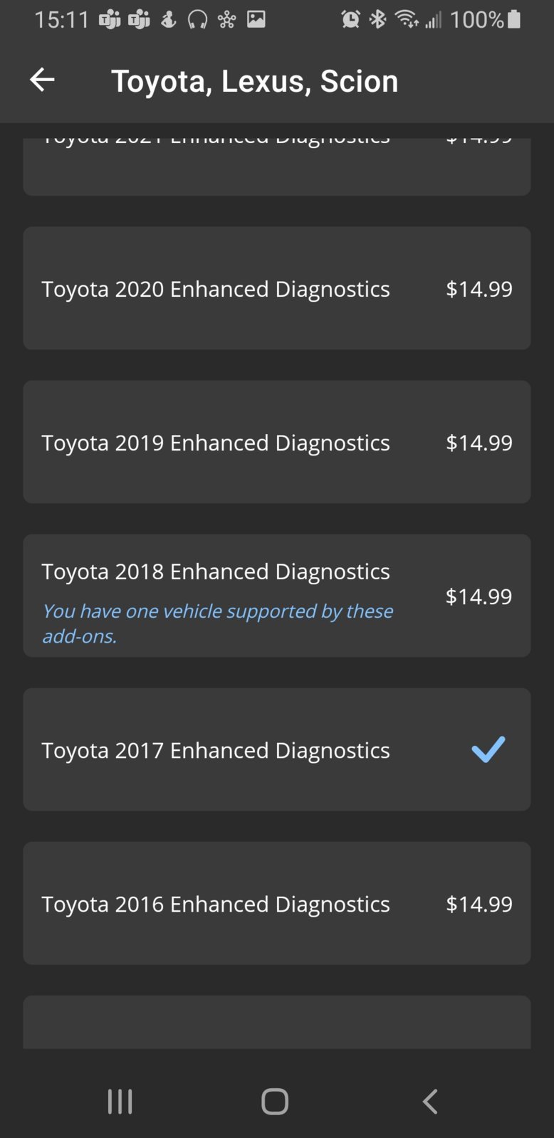

    I just changed the year in the vehicle editor and the toyota folder is gone. The app tells me to buy 2018

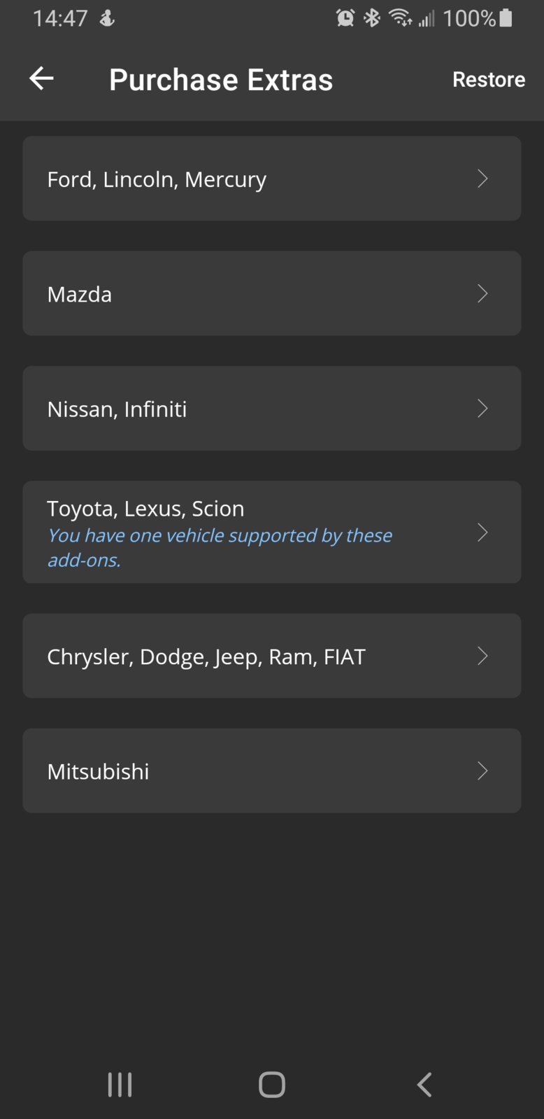

    Can you share the image of your Purchase Extras folder?

    okay I tired it again and it worked thank you so much! when I reinstalled the app earlier I totally forgot to restore purchases LOL! sorry! I now have the "A/T Oil Temperature No.1" appreciate the assist!

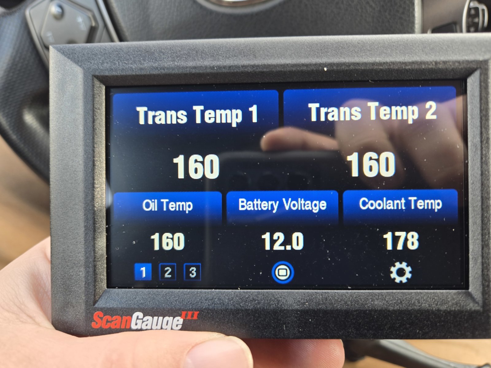

    Make your life easy, scan gauge 3 is the way.
