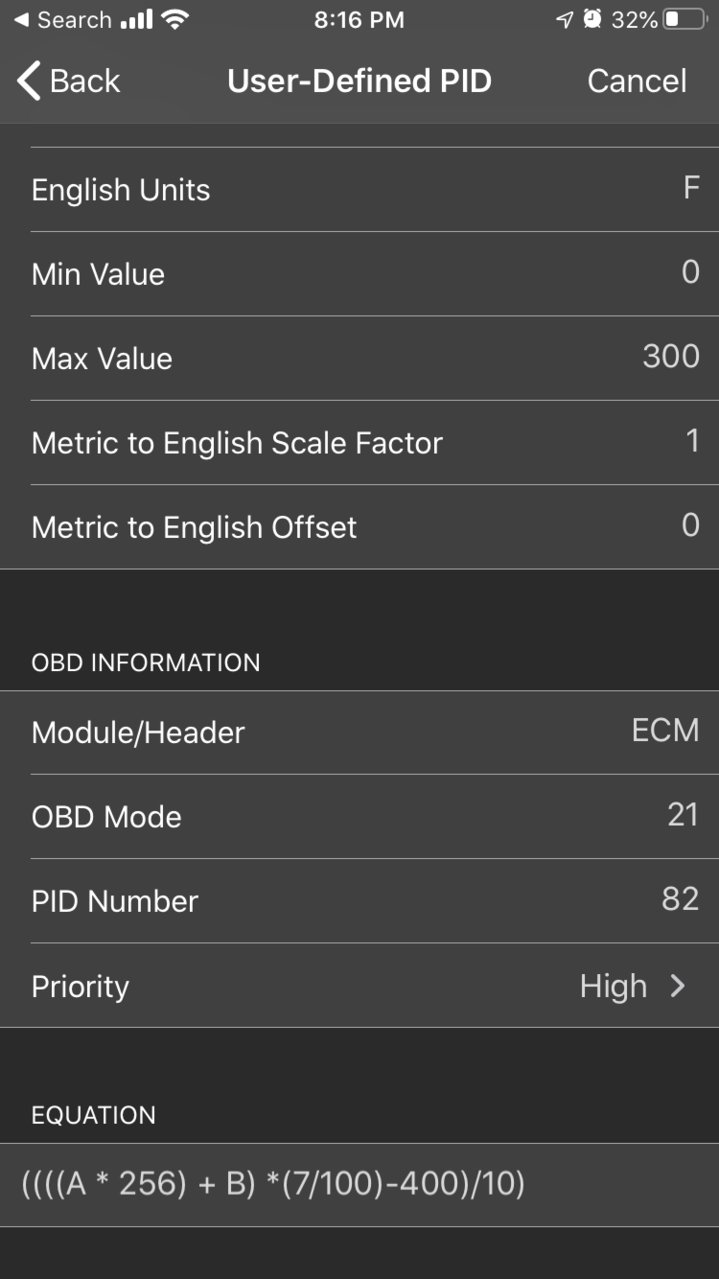

    I use my iPhone and Fusion app to measure my trans temp. PID attached

    Exactly what @TnShooter said, you simply need to add 1 or 2 custom PID's to get the temps displayed.
