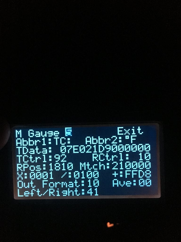

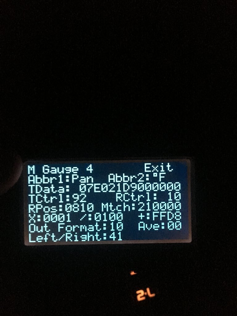

    Hey guys. I'm having trouble getting my Ultragauge to display my trans temp at all. I tried using the codes listed in here, but it still shows error. What am i doing wrong?

    Post a pic of the codes you have entered.

    I used what you posted last page for the 12-15 pan temp. I tried them too see if it would work for my 11. I guess I'll try the 08 FJ ones.

    i used what was in post #8. I suppose you quoted yourself from another thread?

    Found it.

    The FJ codes are for scangauge I think.

    This is what I used on my 07, I'm not sure what year the coding changed. IMG_1592.jpgIMG_1591.jpg

    I didn't have to do any of that.
    I ordered my UG from them with it already programmed to work

    Mine came programmed to read only 1 temp. It was reading the torque converter temp only when I received it.

    Mine just says trans F*
