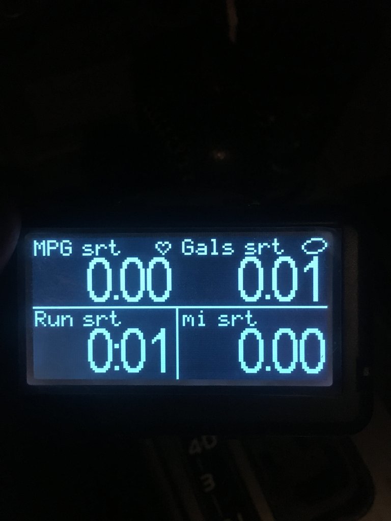

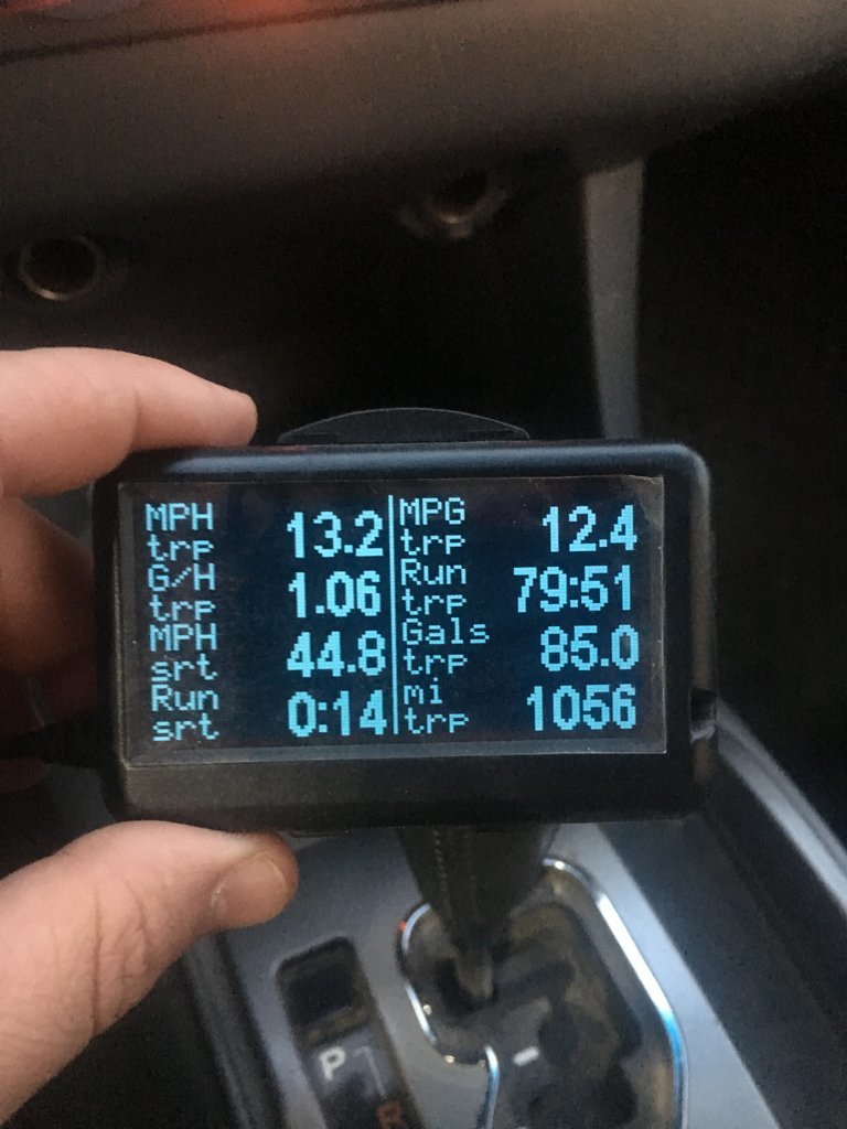

    '07 Tacoma Access Cab TRD Off Road
    I used this today to on my ultra gauge for my '07 as well . Thanks for this
    Do you know if there is a per trip average mpg meter ? Where it resets each time the ignition is turned off

    07 sport 4x4
    07 sport 4x4 Well-Known Member
    Dec 24, 2010
    #48165
    1,453
    Blake
    Southeast
    2017 Duramax
    There is, it's at the end of the gauge/page options. You'll want to look for 'mpg srt'.IMG_4929.jpg
    AR15xAR10 likes this.
    Run start is the time the trucks been running since the key was turned ? Then it resets ?
    The mpg trip is the one that resets on that screen ?
  19. Jul 21, 2017 at 11:13 PM
    #79
    07 sport 4x4
    Dec 24, 2010
    #48165
    1,453
    Blake
    Southeast
    2017 Duramax
    Trp is manually reset, srt is reset every time you turn the truck off.
