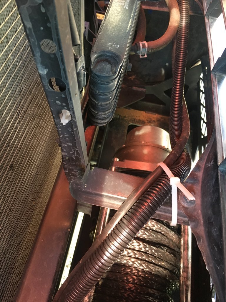

    Yes, the cooler adds capacity to the system.
    The amount of increase is not important except when buying fluid.
    There is no need to prime the cooler, it is installed in the return line to the trans pan and is self purging if installed correctly.
    As for how you described the fluid path. If you retain the radiator cooler as you mentioned, it will be radiator in as oem, radiator to cooler lower fitting or in my case either top fitting, cooler upper fitting, or possibly second upper fitting as mine is to oem return line.
    If your truck has the towing package cooler, you will go radiator, then towing cooler top port into second cooler lower port or either top port.
    As for having a fan setup, that adds complexity. My setup could get more moving airflow had I made a deflector to direct air since some of my coolers airflow is blocked by the bumper. Even so, it has never been a concern.
    I did try and keep the added trans cooler kind of close to the ac condensor hoping the oem fan would draw air over the trans cooler when not moving. Seems to have worked.

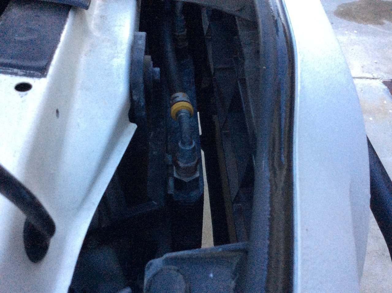

  16. Jul 23, 2017 at 3:55 AM
    #96
    PMK
    PMK Well-Known Member
    Feb 27, 2010
    #32186
    1,366
    Florida
    10 DCLB TRD Sport
    White, debadged, Mudflaps removed, ICON 2.5 in front, 2.0 in rear, all 4 corners have reservoirs, Spidertrax wheel spacers all around, BAMF bolt on sliders, Avid lightbar, oem transmission cooler converted to power steering cooler, aftermarket transmission cooler eliminating all oem transmission cooler stuff, remote mounted spin on transmission fluid filter TrueTrac rear differential, rear diff housing vented and filtered into left side bed box, URD MAF calibrator, Volant intake scoop into oem airbox, second filter removed, airbox internals smoothed, blended and polished throttle body, NST intake manifold spacer, Wet Okolee set covers, WeatherTech Digital Fit mats, inexpensive JVC single DIN, Scangage, AVS Stepshield door sill protectors, Doug Thorley Long Tube Headers, URD Y pipe with O2 sims.
    The coolers lower mount is the oem lower core support. Two drilled holes were added. The upper cooler mount I fabricated. May have drilled two holes for it.
    The one clearance issue was the aluminum tube for the AC freon. I had to reposition it slightly, by bending by hand about 1/2" so it did not rub the cooler.
