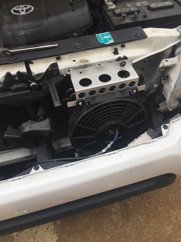

    I run this dual panel with fan setup. I will say that switching to 33s makes the trans run hotter by at least 30deg. this helped a bunch, but will still be regearing in the future.
    wasnt totally installed in this pic yet lol

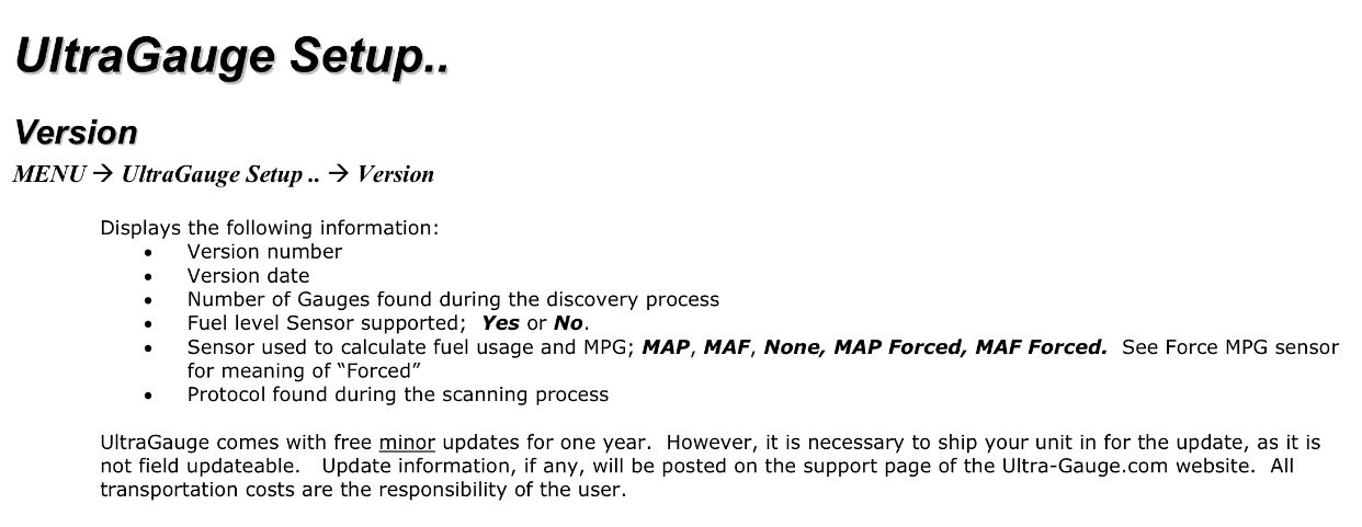

    Goto your menu ... Ultragauge setup.... Version
    Here this is part of the manual , (sorry it's small lol) also I think a the other can be changed to a mx by sending it back to ultragauge

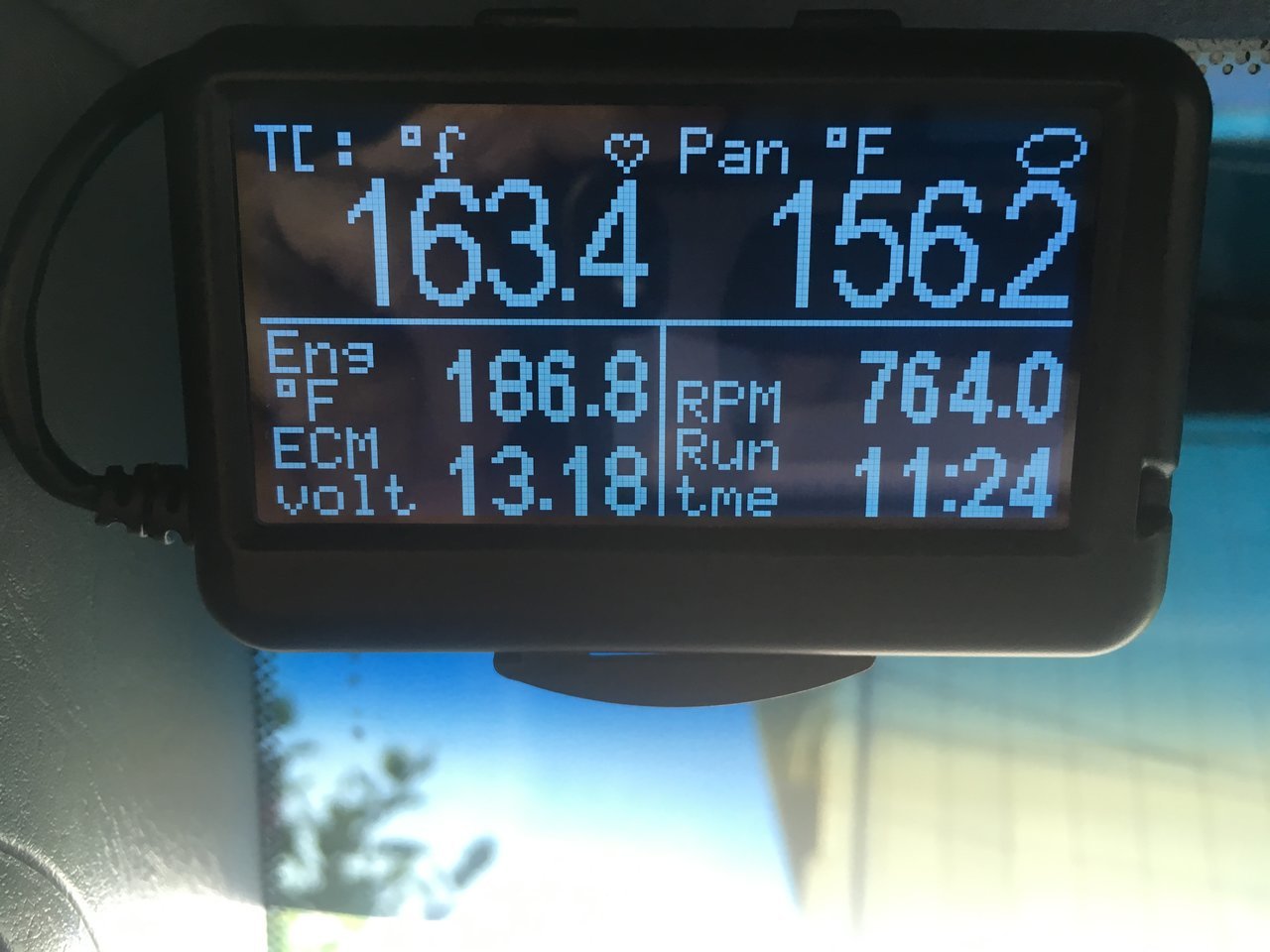

    Just Sharing my Torque converter and pan Temps after 10 miles of stop and go city traffic with no cooler in 99* feel like temperature. I noticed my ECM volts are a little lower than @07 sport 4x4 one post.

    My ecm volts are also higher I'm up around 13.38 area

    Mine start out with a cold start around 13.77 and slowly go down between 13.16 and 13.22.

    So I guess this is what the alternator is charging at ?

    Not knowing a lot about how the charging system works, I'm guessing that is what we're reading.

    The voltage tapers off to the low 13's as the battery becomes fully charged. It's normal.
