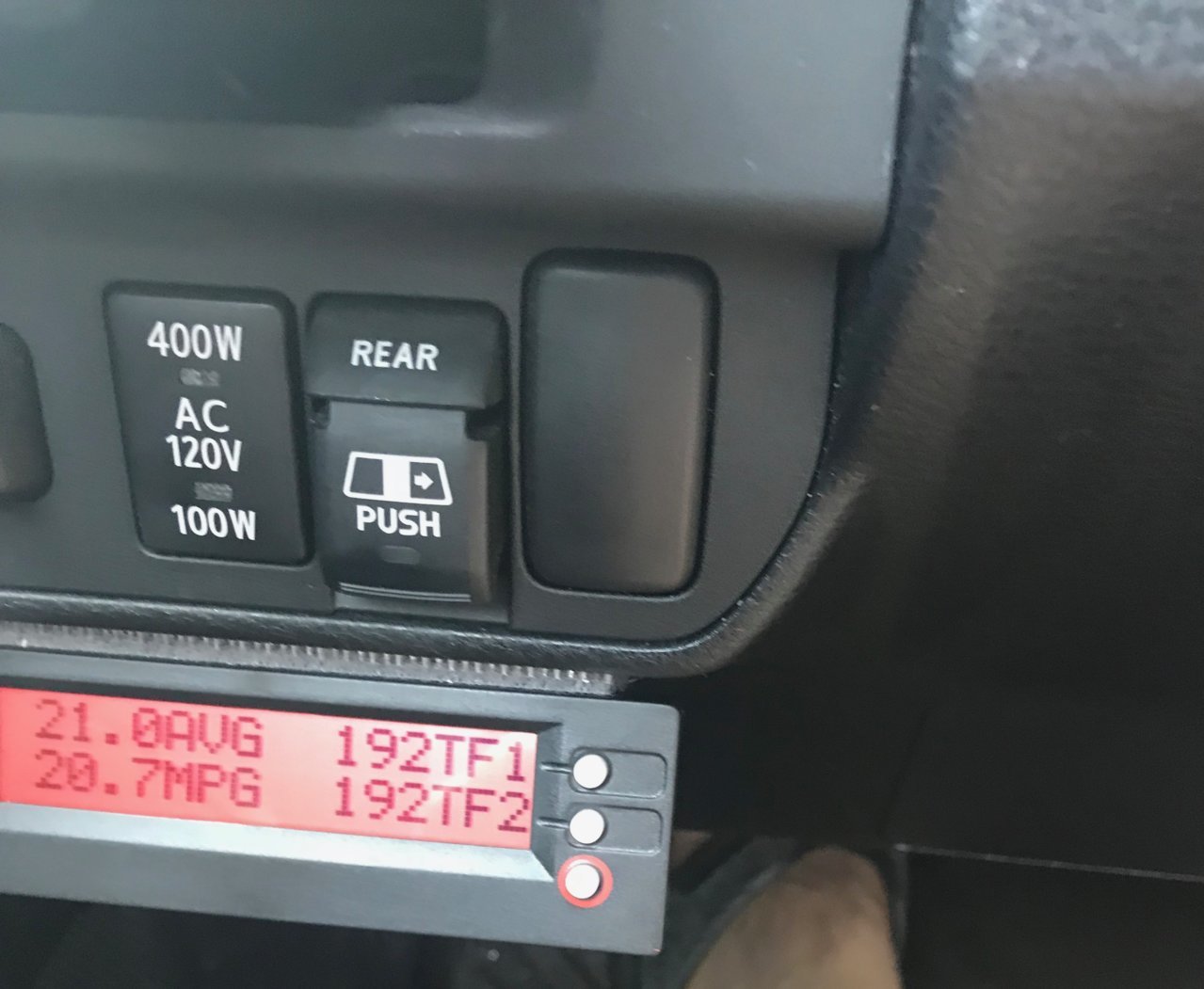

    I recently installed a scangauge 2 because I am soon going to be regularly towing a 3500 lb trailer and I wanted to monitor my trans fluid temps before I got the trailer.
    At highway speeds of 65-80 the fluid holds very steady at 190-195 at both the pan and the torque converter.
    Ambient temp is 80-90 in TX right now.
    That 190-195 is without towing anything (4.88 gears, 33" tires).
    With these temps holding steady, I installed a Hayden trans fluid cooler and ran it in tandem with the stock cooler.
    Result - My trans fluid temp is exactly the same as before the cooler was installed - 190-195. No change.
    The Hayden cooler is installed correctly and an additional 1/2 quart of ATF was added with the thermostat pin depressed.
    The new cooler is slightly warm after a drive so I know fluid is circulating through it.
    Anyone have any ideas or experienced similar? I was sure the temp would drop at least 5-10 degrees.

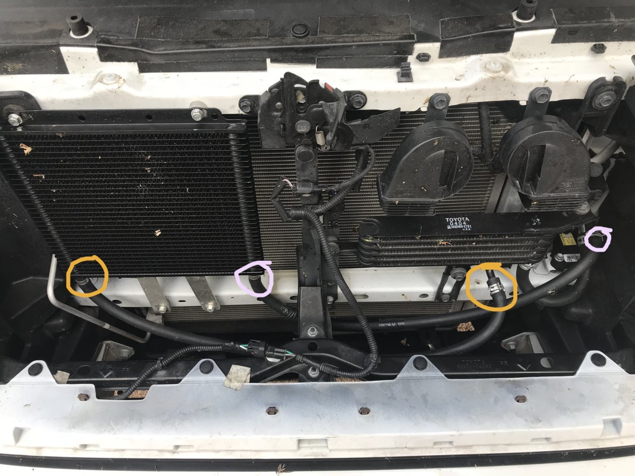

    This is how the two coolers are connected:
    No kinks, no creases, no leaks.

    The Hayden is a decent unit, your temps should be 20+degrees cooler.
    I would double check your return, it should go from the Hayden to your trans.
    Also, you might have an air bubble in the Hayden due to your orientation. Try mounting it horizontal with the in flow on the bottom.
    If that doesn’t work, pull the stock cooler and just run the Hayden.

    thermostat is only on the 3rd gens.
    Next, flip your secondary cooler so inlet and outlet are on the top (or at least 90* so inlet is on the bottom and out is at the top) so the full cooler is actually utilized.
