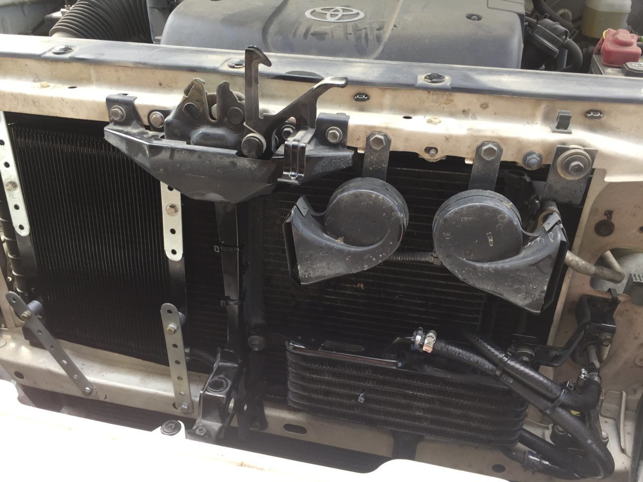

    I'd keep an eye on it. Not to worry, but don't negate it either. Trannies cost too much now a days. I'd spend the $60 or $80, pending on brand, and get a 10,000lb rated radiator cooler, and run it inline with the factory. Never worry again... This Texas heat had me install a fan also. 2nd gen at 240 worried me.

    A Derale transmission cooler will make your temp worries a thing of the past.

    White, debadged, Mudflaps removed, ICON 2.5 in front, 2.0 in rear, all 4 corners have reservoirs, Spidertrax wheel spacers all around, BAMF bolt on sliders, Avid lightbar, oem transmission cooler converted to power steering cooler, aftermarket transmission cooler eliminating all oem transmission cooler stuff, remote mounted spin on transmission fluid filter TrueTrac rear differential, rear diff housing vented and filtered into left side bed box, URD MAF calibrator, Volant intake scoop into oem airbox, second filter removed, airbox internals smoothed, blended and polished throttle body, NST intake manifold spacer, Wet Okolee set covers, WeatherTech Digital Fit mats, inexpensive JVC single DIN, Scangage, AVS Stepshield door sill protectors, Doug Thorley Long Tube Headers, URD Y pipe with O2 sims.
    I run a Scangage in my truck. For no true good reason I set up to monitor trans fluid temp in the pan. I knew the temp in tne original configuration, and now after going to a system that does not utilize the radiator and is solely using a quality cooler setup. Temps now are about 30 degrees lower than oem.

    Just to verify. Gen 2 Tacoma has the return oil coming from the top port and this then goes into bottom of the new cooler and return to trans. Correct?.. B&M 13000 BTU

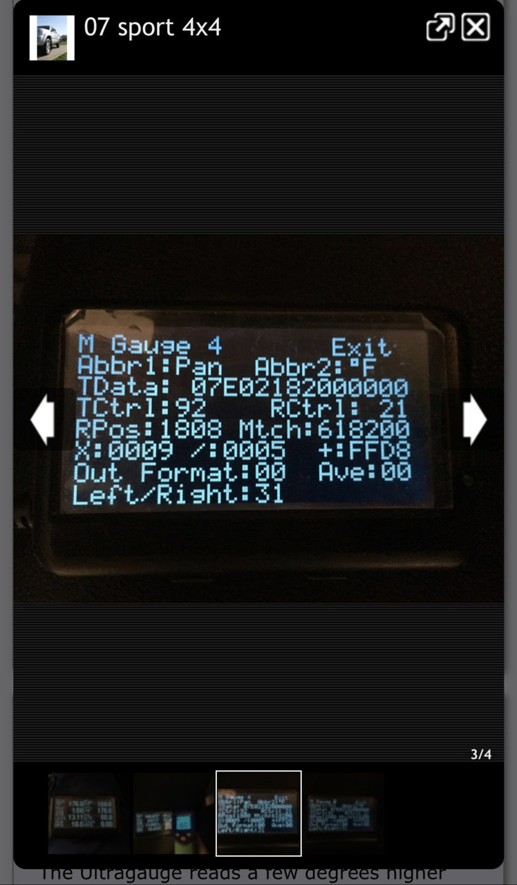

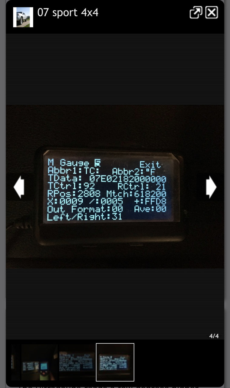

    Anyone have the setting for the trans? I have the TC but not pan on the ultra gauge.

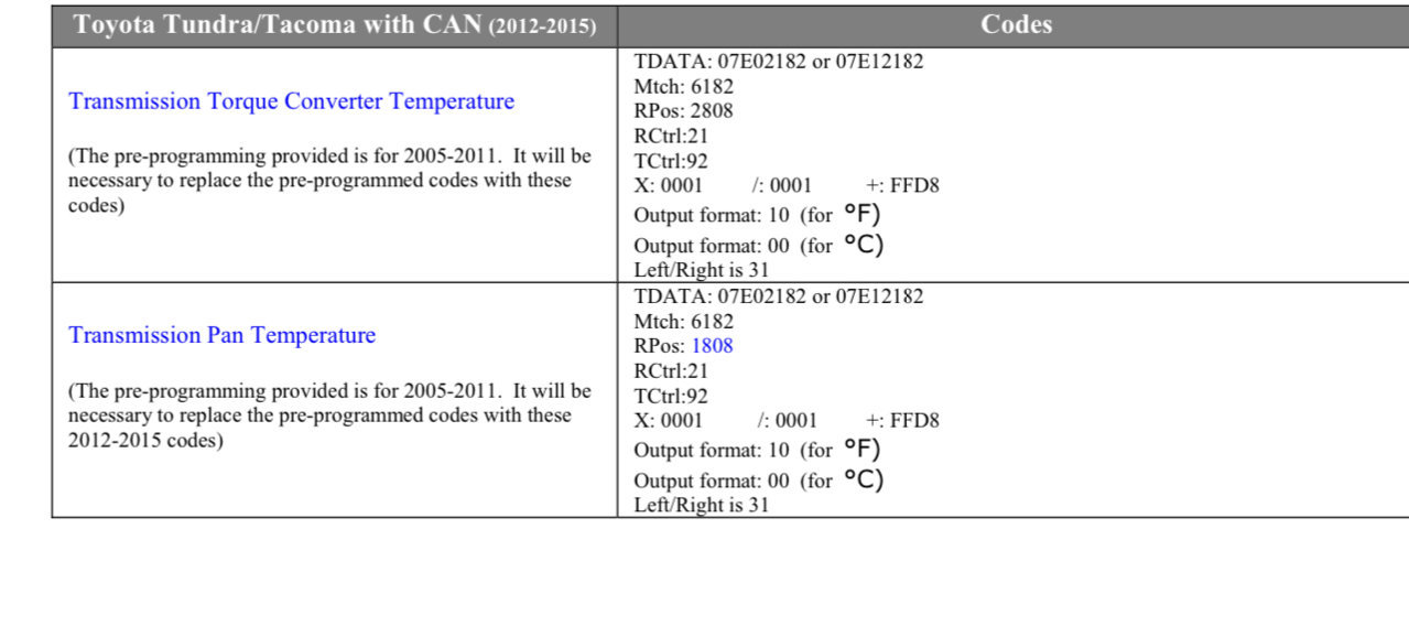

    go to their site, they list the codes in the supplement. One mention, in the drain and fill thread a couple of us have noted the pan temp that everyone uses is about 15 F less than the Toyota temp check number. Dont know why, but its all relative

    77950F21-7F73-4D5D-ADE7-62EBF4288732.jpg CBA2E236-6BE9-4FF4-924A-3B73D5A2AF3E.jpg

    Thanks for it figured out. For the later 2nd gen

    Ultra Gauge with Tacoma pack will. If not adding it is included in the manual. You can also get a BT ODB reader and an app.
    Either one is as complicated as picking the 2 PIDs that track the Pan and Torque Converter. I run the Ultra Gauge now so its available all the time but still use an ODBMX+ BT reader for expanded items.

    Ultra gauge 1.4 has trans PIDs from direct order. You select Toyota Tacoma you may have to add the settings but it supports trans temps should be pre loaded if you select Tacoma but also pretty easy to add them.
    https://ultra-gauge.com/ultragauge/support/UG-MX1.4-Supplement.pdf

    Not sure if the "EM" version does, but the "MX" version certainly does.
    I have transmission and torque converter temps displaying on mine.
    edit: To be clear, I have the 1.4 MX.

    yah that’s a good call. I know for MX only 1.3 and 1.4 do. If it’s an older one it’s not supported. I had a 1.3 I upgraded by sending to them to get 1.4. Depending which one you can have it done to older ones as well
