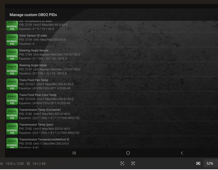

    Look again at the picture. The post at # 17 shows that it can be used for IOS and Android. I use the Android.
    I don't know how it would work, the PIDS and like with an IOS system.
    Programming ?
    Well Torque Pro has a specific, how do I say it - connection sensor table that you connect to a display dial. You input your parameters (# 18) into the connection sensor/Pid table. That enables or activates the PID to be displayable.
    This is part of the Pid table. Notice half way down you see Trans fluid Pan and Post Conv items. You select the desired item line and another set of input fields appear. Enter the above parameters, connect that to a dial you want to see. Save that. This works for me
    t
    When the truck is turned on, when the scanner and tablet are paired, when the Pid table has its parameters input and connected to a dial. When the car is turned on, You open the Realtime Information logo in the torque pro app and the display like in #14 should appear.

    I went into the Maestro section on the Kenwood and found Trans temp. It was greyed out, so I used the PID reset. I also reset the Kenwood HU. When I went back in, the Trans temp was available. It doesn't display accurate data, but it's there. Did you get the Excelon as well? Likely different gauge availability between the Taco and a Sierra. I also agree about the crap gauges it does display, almost none of which are desired or useful.

    In the custom OBDII PID page, can you access the "Equation" parameters. That is where your issue is.
  7. Jul 12, 2025 at 9:57 AM
    #27
    MR5X5
    MR5X5 Well-Known Member
    Oct 27, 2019
    #309141
    550
    A quick web search makes it look like you can't modify the equations, which is weird since they show them to you?? What is strange is the OBDII data content and format is largely standardized. Seems odd that it can't perform this basic function. Do the other gauges read correctly? That said, per Ultragauge info, both Trans pan and TC temps are proprietary and would require access to the underlying equation. Me thinks you might be screwed for those two parameters....which are kinda key to have....
