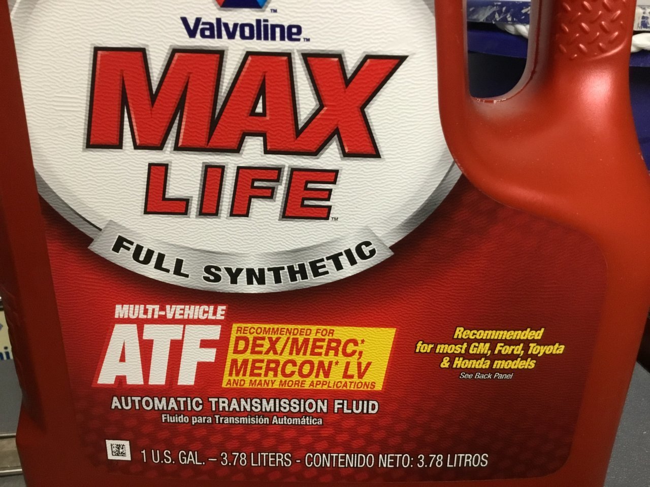

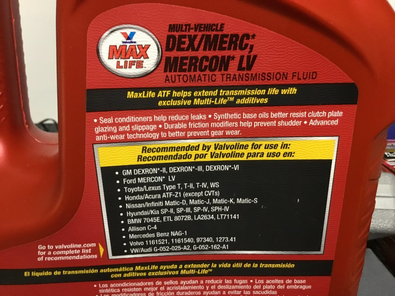

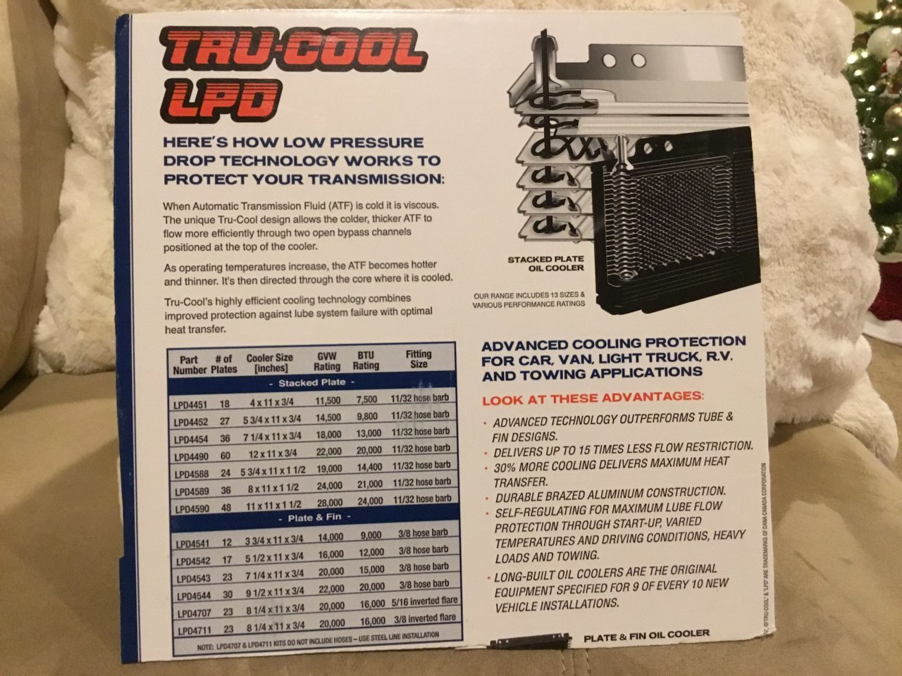

    I don’t think that you’d be affecting your warranty if you do a proper install of a larger, non stock transmission fluid cooler.
    A transmission cooler replacement can obviously assist in keeping your transmission from overheating and causing damage due to excessive fluid temperatures.
    A damaged transmission would require a trip for service and repair.
    Stay away from the dealer. Why not just replace the stock cooler with something bigger and better?
    No more worries about excessive temps from towing or crawling.
    If you purchase an aftermarket cooler, I’d recommend a Tru Cool cooler made by Long Manufacturing.
    Long Mfg. also makes B&M coolers which are exactly the same as Tru Cool, but just more expensive.
    I learned that by previously purchasing both.
    The stacked plate coolers, with no delicate fins to bend, are a little more stout than the tube and fin or plate and fin coolers, and the largest cooler (#4590) they make will fit in the stock location on the Tacoma.
    Add a quart of fluid to the cold transmission.
    Pin the thermostat open, warm the transmission up a bit, close to within the proper temperature range.
    Drain the excess fluid from the overflow plug (not the drain plug!) at the pan.
    There are many pages to be found regarding the procedure explained at length.

    So replace the stock cooler or just add this in line? Before or after stock if inline?
  8. Aug 28, 2019 at 1:05 PM
    OregontoBajaCA
    OregontoBajaCA 2025 DC OR High Bread
    Dec 6, 2017
    #237812
    831
    2025 OR DC iF Max
    I’d just replace it if you want more cooling capability. You could also install it after.
    You’ll find that people do it any of the three ways you mention.
    As the OPs temperatures are not too high, adding to the cooling capabilities may only help to keep one from worrying about overheating in case one happens to encounter extreme ambient temperatures while towing and/or carrying heavy loads over extreme terrain.

    I’ve gotten to 220 pan and 285 converter temps. Didn’t smell burnt but was a bit brown. MaxLife transmission fluid is cheap enough at ~$17 a gallon @ Walmart. I do a annual drain and fill, its easy enough.
    After 45k miles.

    Nice, very clean install. I added a cooler like yours to my old truck but instead of removing the stock one, I just spliced into one cooler line, added the aftermarket cooler and then continued the line into the stock cooler. Kind of a two-for-one deal. I’ve always been told by tranny guys that too much heat is an automatic transmissions worst enemy so.......
    **If anyone is worried about winter and running with too low oil temps, there are also large coolers available with a thermostat/bypass that only opens when warmed up.

    Nice picture on the bike Dave!
    The Tacoma transmission has a thermostat, so no worries about over cooling. Also, the internal bypass of the stacked plate cooler supposedly doesn’t allow as much cooling of thicker, colder fluid until that fluid is warmed by the transmission.
    People in warmer climates sometimes just keep the thermostat pinned open with a nail or small clip.
    I’ve read many times that you can’t over cool a transmission, but perhaps those living in the northern States and Canada have a different experience with extremely cold sub zero temperatures and automatic transmission shifting.
    In my experience with operating a vehicle in ambient temperatures just above zero degrees, I’ve never had an automatic transmission fail to shift properly when starting off cold.
