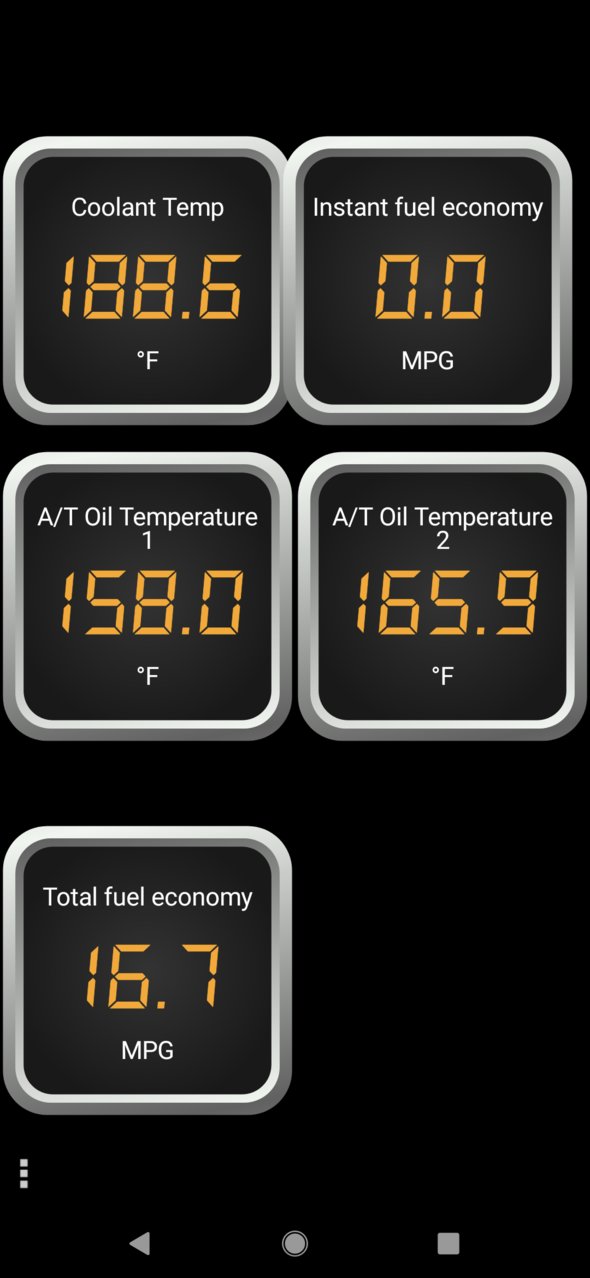

    I'm looking to change my transmission fluid and I know the trans fluid temp should be 115-130F. I am trying to figure out if this temp is at the TC or at the pan? I have OBD Fusion app with the paid Toyota/Lexus PIDS. I am able to pull two different trans temps, one I assume is near/at the TC and the other is pan. There is roughly a ten degree difference.
    I assume, during the check fluid level, I should use the TC (assumed to be TC/higher temp) temp rather than the lower temp?

    AT temp 1, is the correct unit. So which ever is listed first, I believe its closer to converter.

    Ok so AT temp 1 for me always shows the lower side. So go off of that? I thought the higher temp would be closer to the convertor

    I can't verify where the sensor is, it's buried inside and never fails, but I can verify that its AT Temp 1. 100%
    Fahrenheit is so odd. It's 35-45C for us, 40 is the sweet spot haha.
    You should not be dumping at 115, that is incorrect.
    It is 97-115F
    Double check my response, don't trust strangers. But 105 is the "ideal" temp to do the check.

    Ok, so to be crystal clear here. 105 on AT temp 1 is my check temp, correct?

    Ok, well based off of that post that I linked which shows a picture instructions are for A/T Oil Temperature 1. So that is what I will go with on my gauge to get to 105.

    I can't quote Toyota manual information directly due to legal reasons, but I can tell you I'm looking at it and its 100% 97-115F AT Temp 1.
    I've done probably 500 AT changes, and its 40C or 105F on all Toyotas. Even CVT's.
