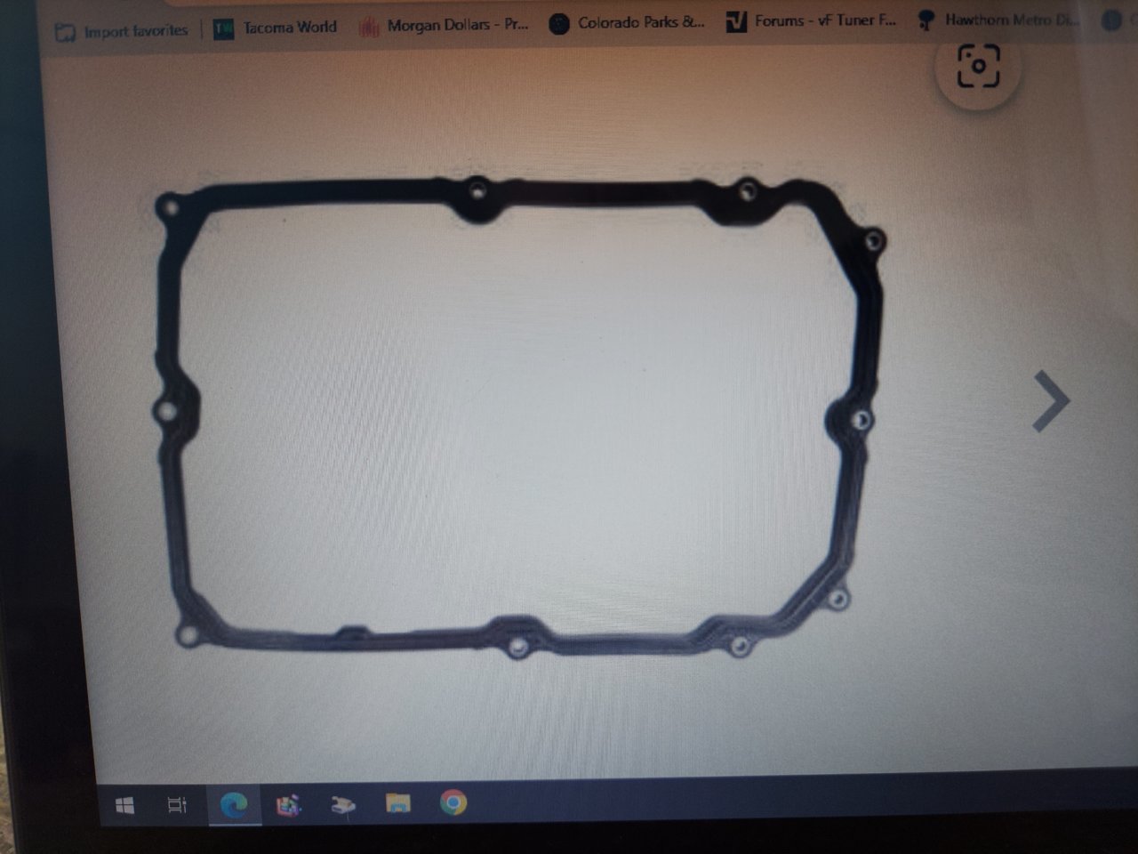

    20230322_131433.jpg ??? anyone have a diagram for the torque sequence to be used when reinstalling the 10 bolts holding the transmission pan for the AC60F AT? I'd say start in the center and do the standard x-cross pattern but the odd corner configuration throws that out the window. ?? TIA. Google search has not turned up anything for me.
    @splitbolt @tonered @gearcruncher ??

    For transmission pans, I have always gone in a pattern as best that I could. Nothing strict. As long as you don't go full bore on the first time through, you'll be fine. Pan flanges flex a bit due to thin metal.

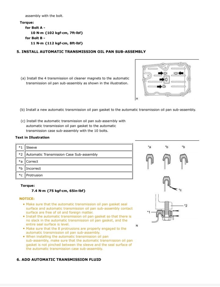

    This is all they give you in the FSM...
    Here's a video of an Aussie installing a heavy duty valve body on a Hilux AC60. Looks he just goes in a circle...:notsure:
