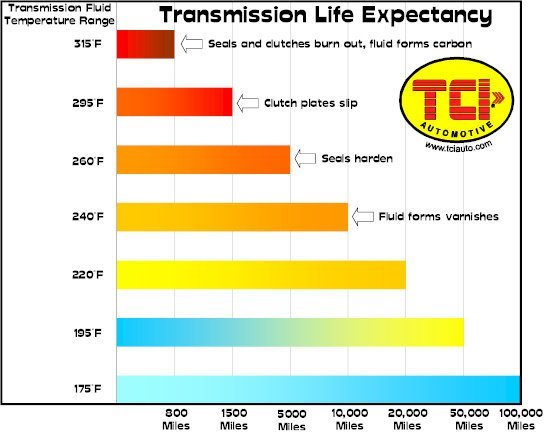

    Excellent write-up here about trans temps and the need for additional cooling when towing by @gearcruncher.
