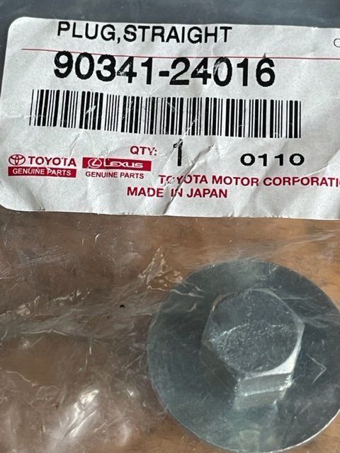

    Hi. I've been searching online but have been unable to find reliable part numbers on all the fill/drain plugs for the trans/diffs/transfer cases. Do people not typically replace these? My truck lived a hard life prior to my ownership and is now sitting at 203k miles in the northeast, leaving me suspect of the reusability of all these plugs.
    So far I've found the following P/N for some of the crush washers:
    1x 90430-24003 front diff drain
    2x 90430-A0003 transfer case fill/drain
    3x 12157-10010 rear diff fill/drain, front diff fill
    edit: I should note I have the auto trans

    Some guys around here run plug from a Lexus, unsure what year you will have to do a search in here for that one

    +1 on the Lexus plugs. I replaced both hex key fill and drain plugs in the front diff with the Lexus plugs.

    front diff drain plug

    I'm assuming the Tacoma has a hex key fill plug like the 4Runner?
