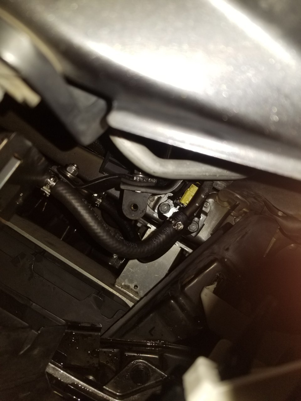

    In reference to your post concering the difference in fitting sizes and shifting, I'd be looking at that bend in the hose. More than likely that could be the reason for your shift problem.
    I have no problem whatsoever with shifting due to the difference with the fittings.

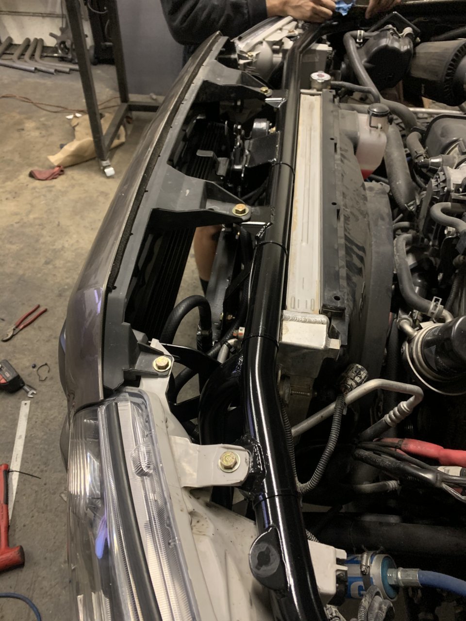

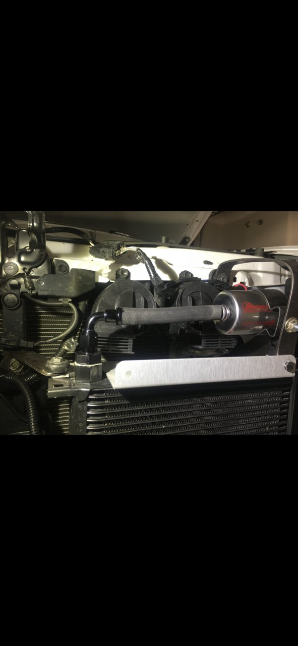

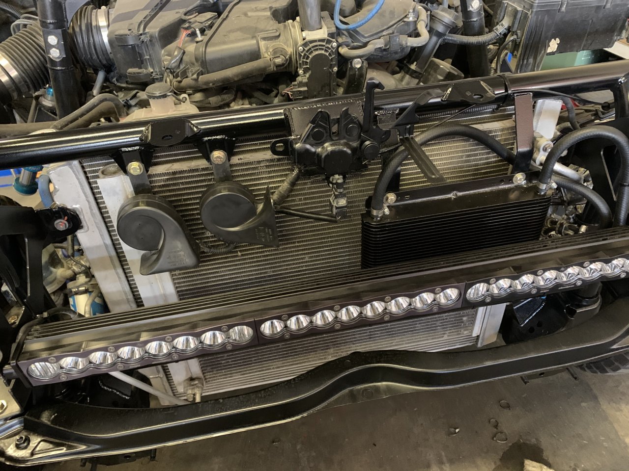

    I have one of the B&M supercooler on my 2nd gen. Removed factory cooler and run it through the CSF radiator. I have never seen temps about 200 here in Southern Cali on my normal driving, they normally range between 140-180 depending on the temp outside. With the factory cooler last year driving from Southern Cali to Lake Havasu with 2 jet Skis in 100-115 degree heat I saw the trans temps between 195-220. I will be doing the same trip next month and be interested to see the difference towing the skis.
    I have been considering and I am not sure if anybody has done this. I prefer a better solution to routing the lines going from the trans to the cooler. Imo there at yo many lines that could possibly leak or go out when toying off-road. There are two metal lines coming out of the trans and I was trying to find a solution to add -an fitting and go straight up the passenger side to the cooler rather then from the passenger side across the front to the driver side then to the radiator then to the cooler. If anybody has done that with -an fittings and braded lines can chime in?
    anyway here are some pics of the truck with the cooler.

    I ran -an lines for the transmission cooler on my V8 Ranger conversion, and they worked fine. I don't see why they would not work on a Tacoma.
    Just be sure to secure the lines so they don't rub on anything. I think that is the main advantage to the fixed steel lines.
