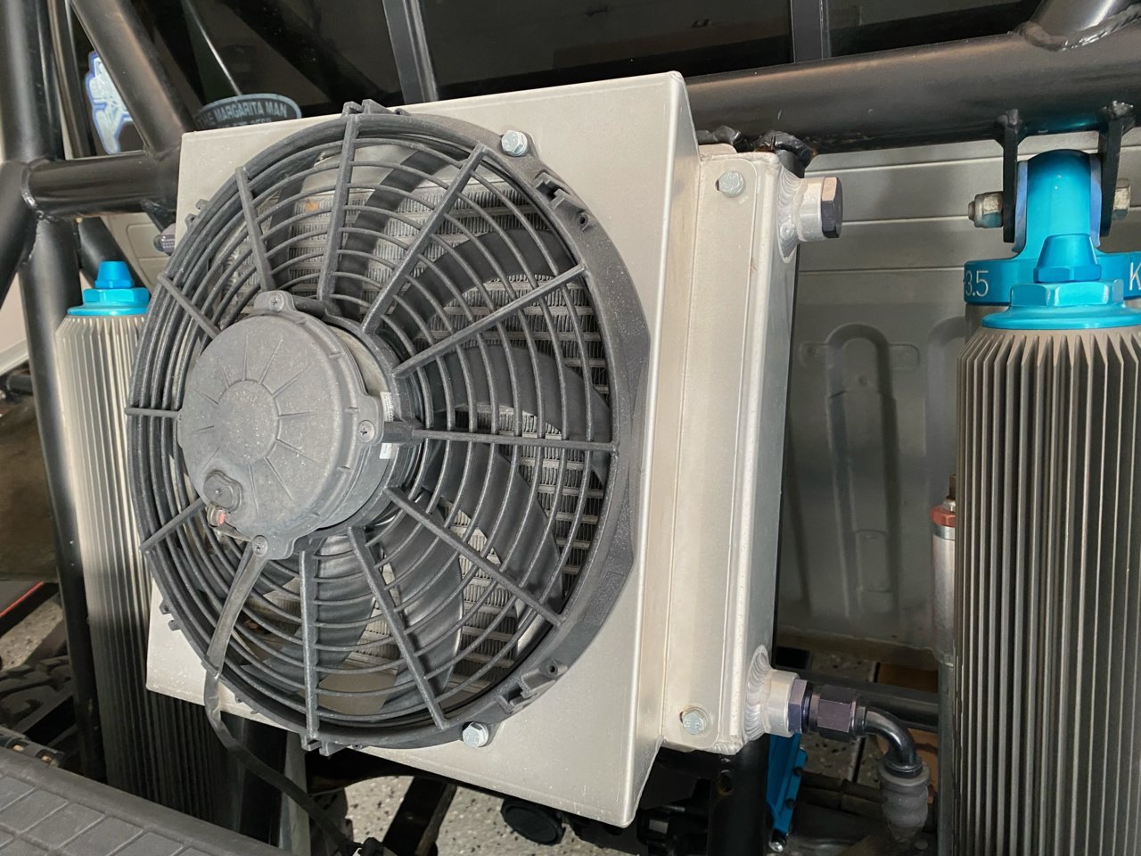

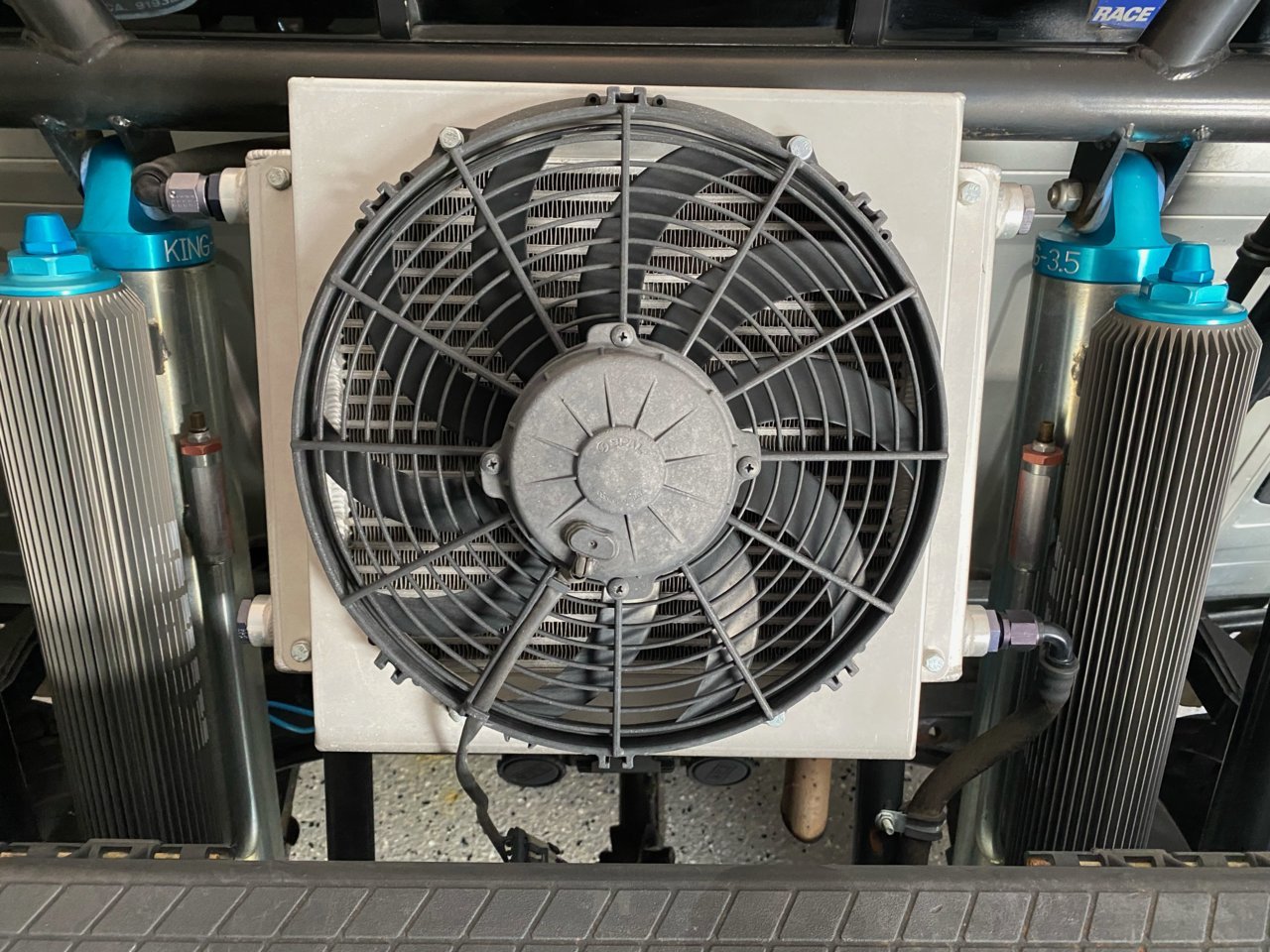

    I have this setup.. It was definitely needed for heavy/extreme duty (off road/larger tires) and is probably why I haven't (knock on wood) had any driveline issues even with all the off-roading.
    I have always wondered why there is an upper and lower bung on both sides... I presume this is just to give mounting and plumbing options and as long as you use an upper on one side and a lower on the other you are good? I'd love to hear if that is a good assumption.
