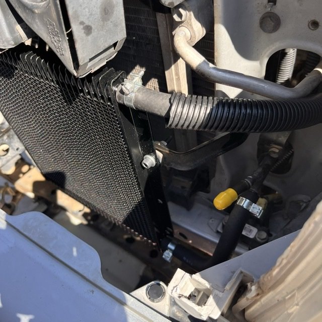

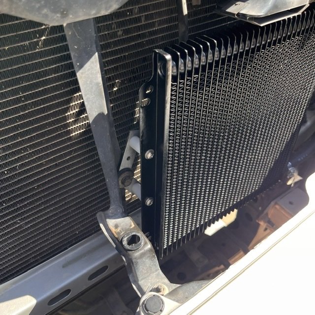

    Upgraded my oem ATF cooler today. Could not find a True Cool ATF cooler from a reliable vendor, so went with a cooler making many best-budget lists, a Hayden plate/fin, #679, $48 on Amazon. It had a manufacturing defect - the inlet/outlet nipples has a sharp edge where it pressed into the cooler tubes. It was easy to smooth down with a file; sandpaper would have worked also. Did a couple other mods as noted below. Best part - no leaks and ATF temps have gone down.
    I re-used the oem driver-side bracket. In the oem cooler, ATF flows upwards through the cooler. I positioned the Hayden cooler sideways with the ATF coming in from the top. I don't know which flow direction is right, if any.
    On passenger side, I added 30mm nylon spacers, two custom cut brackets and a rubber washer. Used oem bolt.

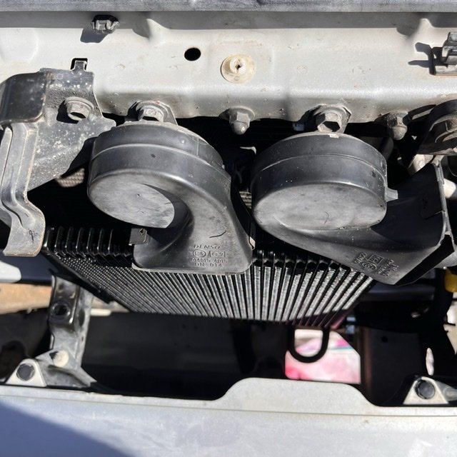

    I had to reposition the horns higher up, about 1.25 inches, to clear the cooler. I drilled holes in the oem horn brackets.
    In order to not purchase the small ATF hose ($25) from the radiator outlet to the metal line connector, I, cut to length, a hose from the radiator outlet to the Hayden inlet nipple. I also used my own 3/8” ATF line instead of Hayden’s smaller 11/32 hose.
    My initial test drive was encouraging. On a long grade where I used to hit 200’s at the top of the hill, the ATF temp was in the 180’s - same ambient temps and same speed. On the way back, I would hit 210’s, now, 190’s. Real test will be in a few weeks when I tow a 21-foot RV trailer 70 miles to the desert, through a mountainous section.

    You oriented the cooler correctly - hot on top, cool on the bottom.
