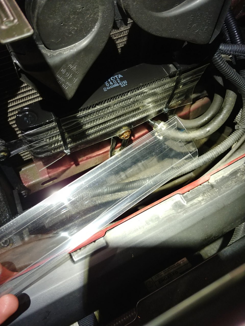

    I used some plastic I was about to throw out to make a quick cover for the factory ATF cooler. Have a few hundred miles on over the past three weeks and Ive been consistently seeing about 115*F above ambient now. Not as much of a gain as I was expecting, but better than before.

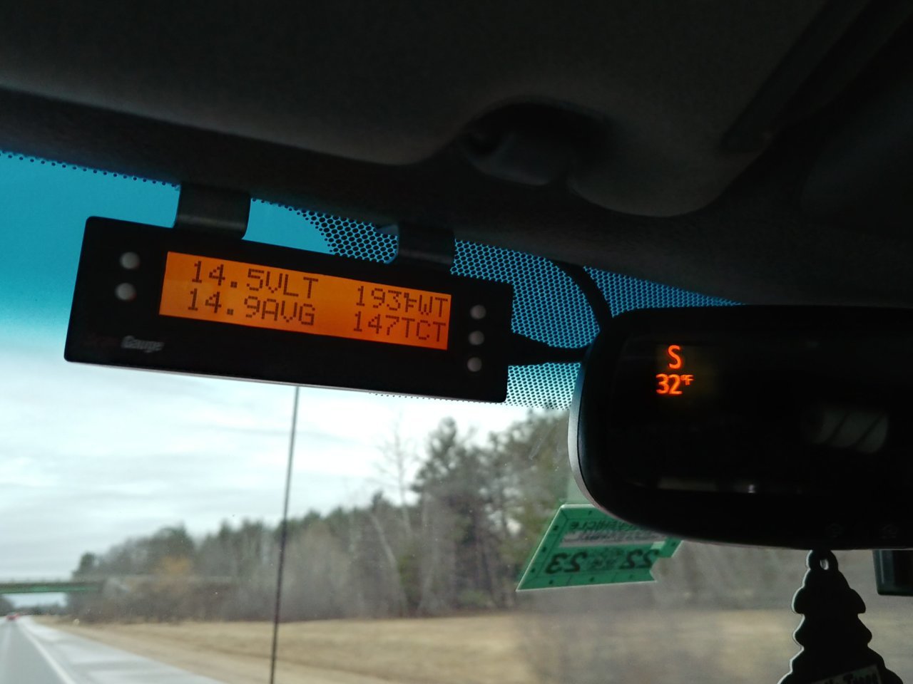

    The cooler cover certainly paid off this past weekend. After about an hour of sub-zero driving:

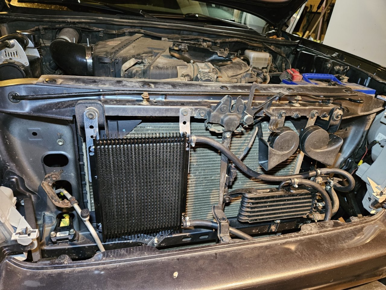

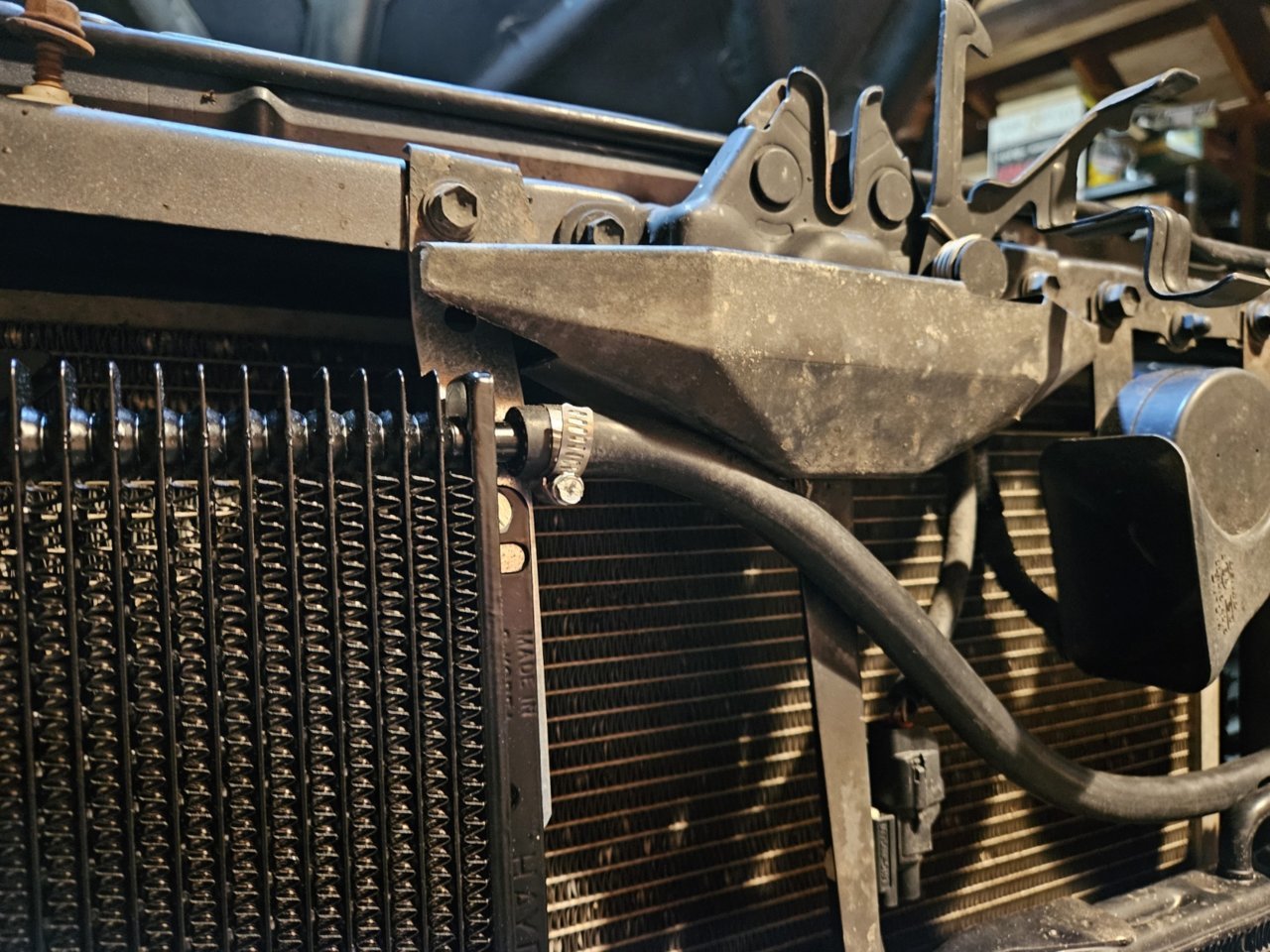

    Got the cooler installed last night. Just need to top off the fluid tonight and it will be ready to roll. I had to trim the hood latch guard thing but other then that it was a straight forward install.
    CemenTRDgen and gearcruncher[OP] like this.

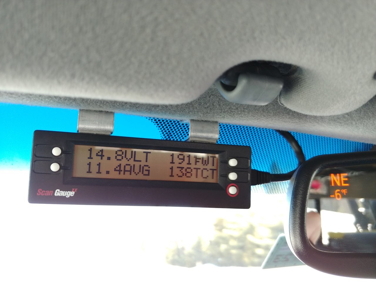

    What's TCT on your scangauge? Is that the same thing as TFT on mine?

    It is what I have programmed into my SGII to monitor Torque Converter Temp.
