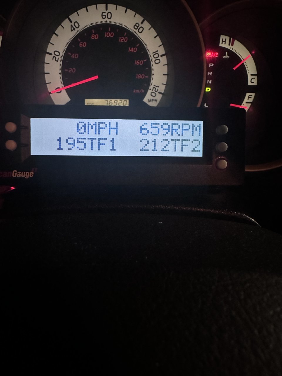

    What are the appropriate idle temps for the transmission. I noticed my truck idle temp after driving home from work is high. Is this normal? IMG_7374.jpg

    Depends a lot on your driving style, ambient temps, and the roads you're on. Thats high for me and my conditions, but I wouldn't say its anything to worry about if thats after your commute home.
    You should see the higher temp (torque converter) drop down to almost match the pan temp if you are cruising at a steady speed on a level highway. If its consistently higher, then the converter is staying unlocked for some reason. Thats where most of the heat in the system comes from

    Fairly normal .
    Keep in mind that the transmission is also cooled by the engine radiator . The transmission is also kept warm by the engine radiator .
    Your engine is most fuel efficient at 180 F * .
    If your engine overheats , your transmission will also overheat
