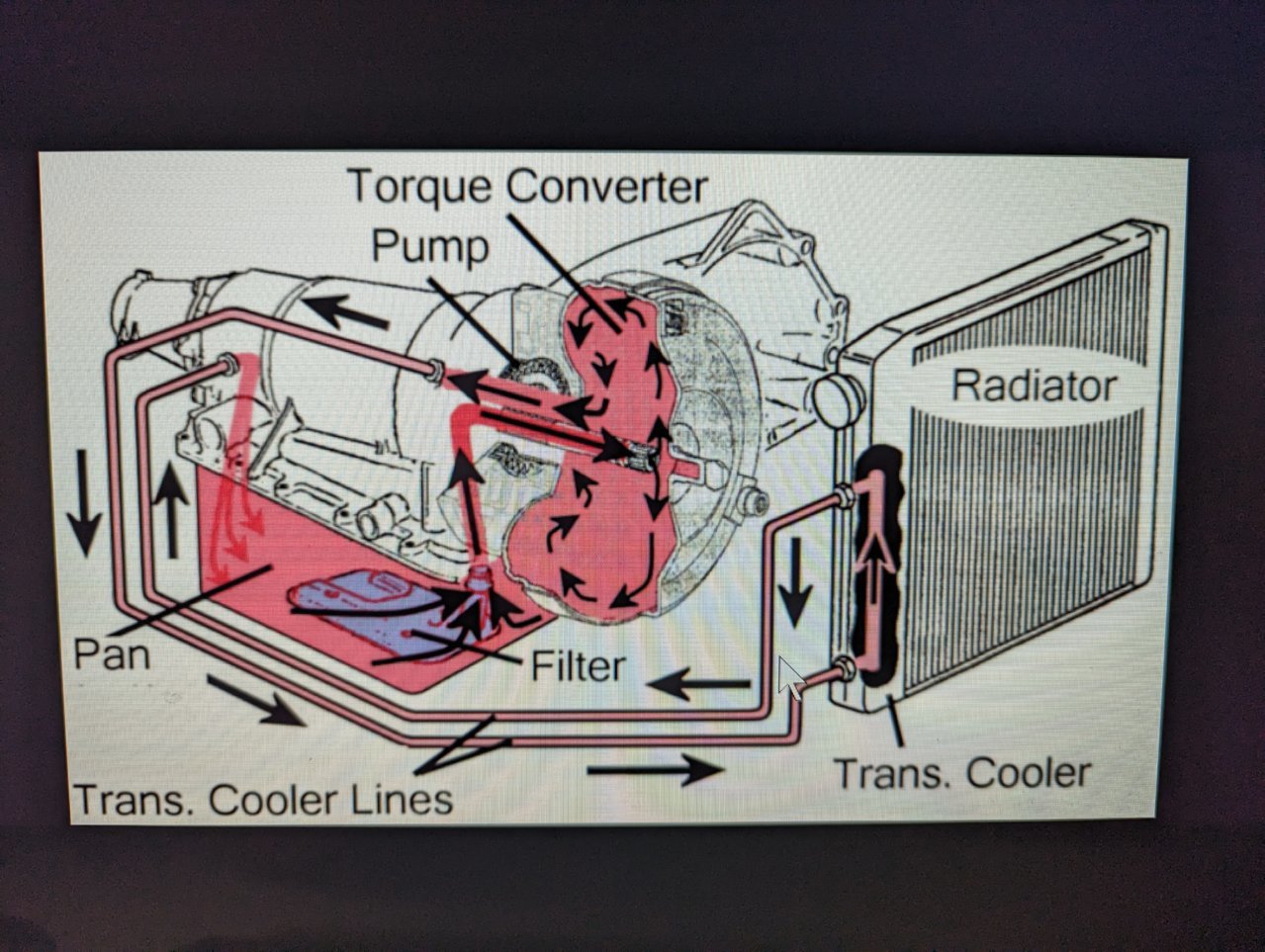

    Can anybody please tell me which is the return line and which is the send line on 3rd gen with tow package? I keep reading that you should install the hot line at the bottom line of the transmission cooler and let the fluid flow upstream rather than down stream. Here is a picture of how I’m currently running mine. Please @gearcruncher or somebody with this knowledge help me out here. Thanks! image.jpgLines are very short currently but I’ve made sure neither line will kink. bottom goes to bottom of cooler and top goes into the top

    From what little I know and with help from the inner web this is how I understand the flow of trans fluid. ---deleted link------
    EDIT
    the link to the flow chart blows, so I deleted it and took a screen shot.
    This is how my stock was and how my Long Tru-Cool LPD 4454 was installed. Check post #118 in this thread.
    Also from what little I know, the 3rd gens need to "pin" something that controls the temp.
    Hopes this helps

    Thanks for sharing I can’t seem to get the link to work nor could I get the link in original post about fluid flow direction to open. Nice install you did btw

    If you have an IR gun, it may help determine the return line. On my oem 07, the oem trans cooler was installed on the return line out of the radiator.

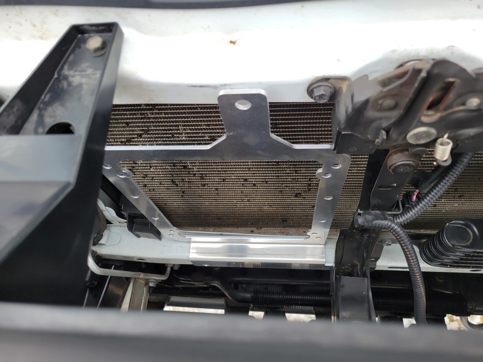

    Hey guys I've just released transmission cooler bracket kits available to order on my website. These have been extremely popular with the FJ and 4runner guys. Links below. If/When the OP thinks I'm worthy I would be thrilled to have the first post updated with a link to my website possibly.
    I'm sorry I don't have better pics currently but these go on the passenger side and bolt in. I'm offering the first 3 people who send me/post good pics of the install to get $20 refunded from their order.
    https://iconic-fabrication.myshopify.com/products/2005-2015-tacoma-transmission-cooler-bracket-kit
    https://iconic-fabrication.myshopify.com/products/2016-2023-tacoma-transmission-cooler-bracket-kit
    Pictured below is on a 3rd gen. 2nd gen is very similar. Totally bolt-in to existing holes, no holes to drill.
