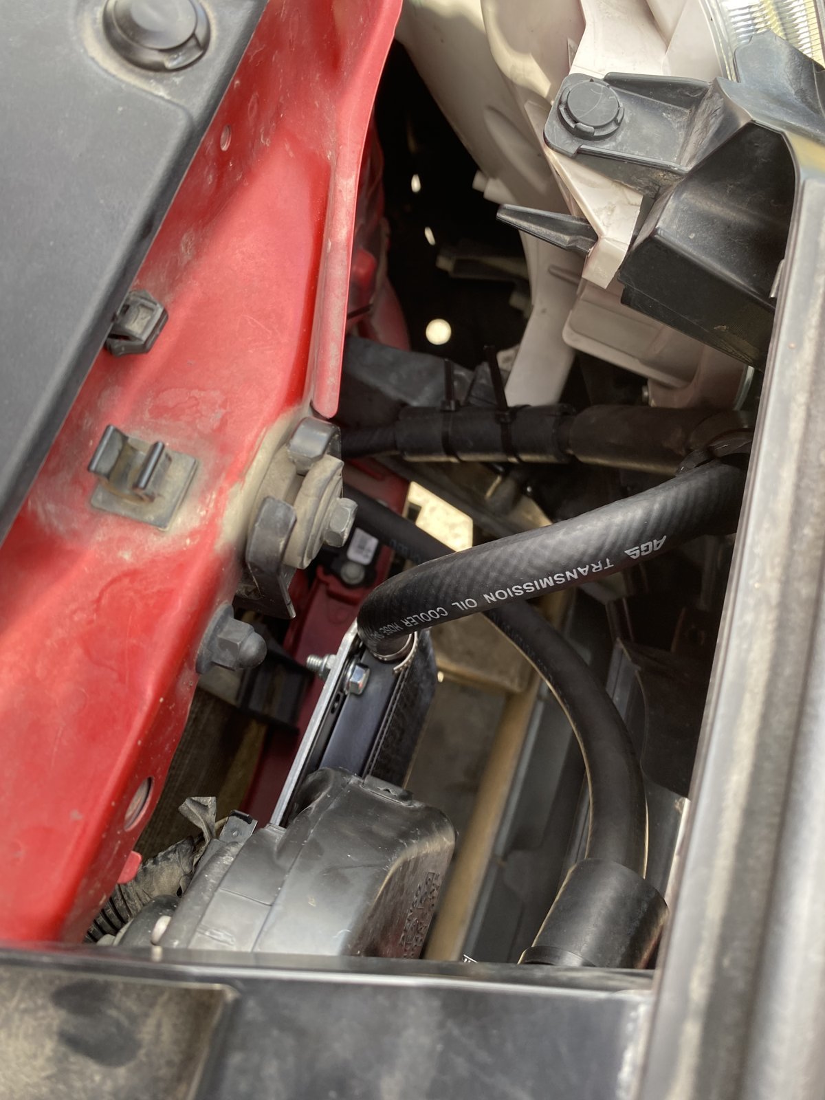

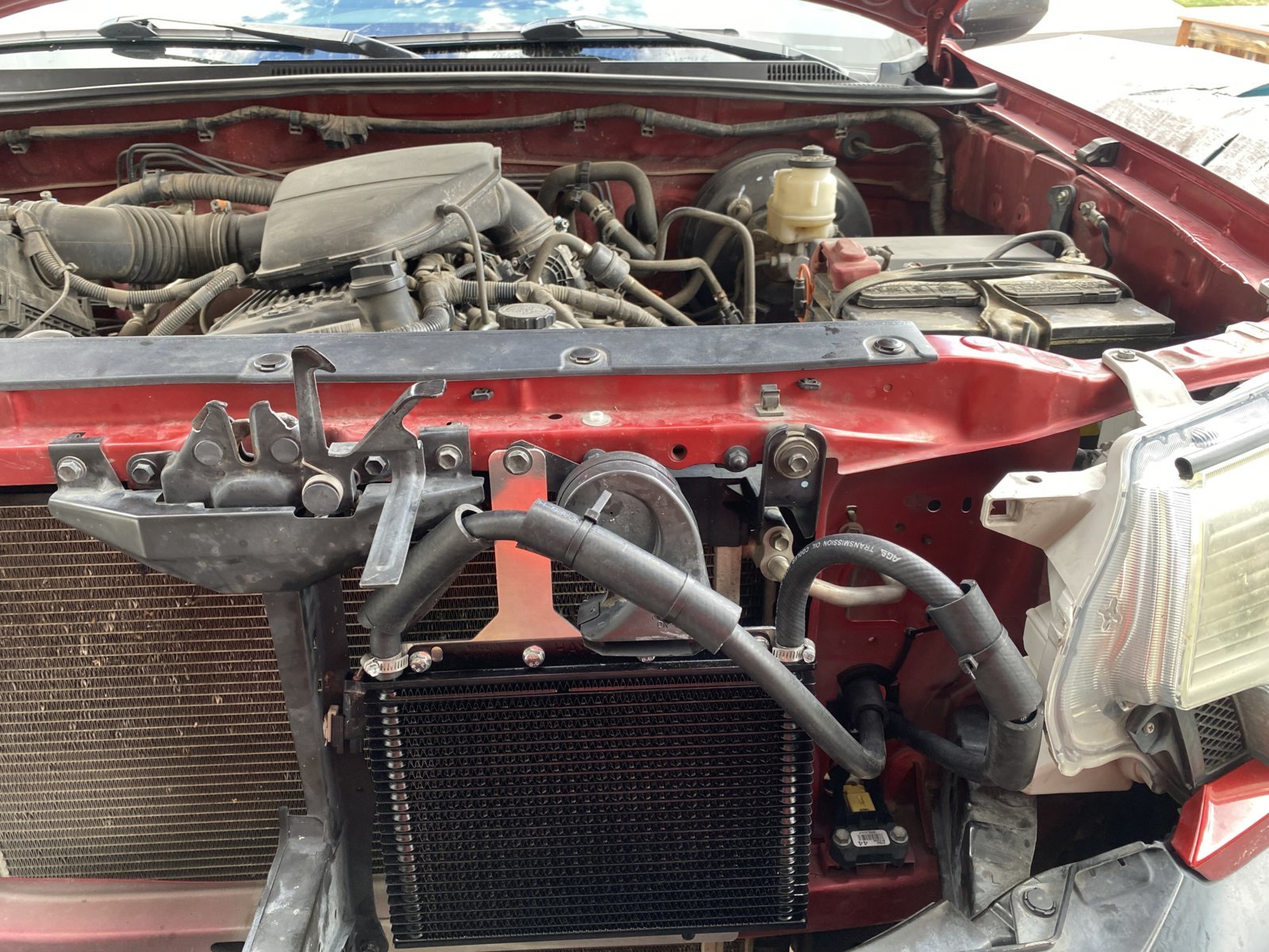

    Since this thread has helped me out a ton in figuring out what to do, I figure I’ll reply with what I did. I’m pretty sure I installed everything mostly correctly :fingerscrossed: lol!
    A little background: I’m checking what I’m very certain (99.9%) is the trans pan temperature on a scan gauge 2. I’m lifted with 255 85R16’s. I noticed that a regear helped my transmission temperatures a little when driving on roads in the 40-55 mph range. However; in dirt roads the temps would climb to 185-200 very easily or on highways when climbing up grades and when the ambient temperatures were hotter.
    Then one day driving in central Nevada going through some steep grades (both paved and dirt) my transmission temperature rose to 220 on a steep dirt road. On pavement the tc was unlocked 3rd and 2nd gear driving up the switch back roads. Luckily it cooled down quickly but it never got below 190 (near the operating temp of the engine coolant which ranges from 190-195).
    To remedy this, I ordered and installedIMG_3599.jpg the Hayden 698 and Iconic Fabrication bracket. I Installed the bracket this way in order to avoid pinching transmission lines or having too tight of a radius of the lines.
    My major concern is perhaps I have too much hose “exposed” and as precaution I used some heater hose for some abrasion protection. I’ll probably end up ordering some nylon sheathing for the lines for additional protection. I routed the line from radiator return line to auxiliary cooler and then back to the transmission. So I still use the radiator the initial warming and cooling.
    The kit was helpful and I didn’t spill too much fluid which was collected and measured. I added approximately 1/2 quart of Mobil 1 3309 (heck even the bottle looks like the T-IV I’ve bought from the dealership in the past)!
    For the most part after the install, my transmission temperature ranges in 140-160 range. The hottest I’ve reached was 172 but that was climbing a very steep grade paved road where the transmission stayed in 2nd or unlocked in 3rd gear for most of the time. But then on the downhill it quickly cooled down. I am very impressed with the cooling abilities and wished I installed this earlier!
    Obligatory truck picture of course!
    PS the truck is a 4 cyl. with the 4 speed automatic transmission and 4x4 (A340F I think). Installation was very simple on this pick up.

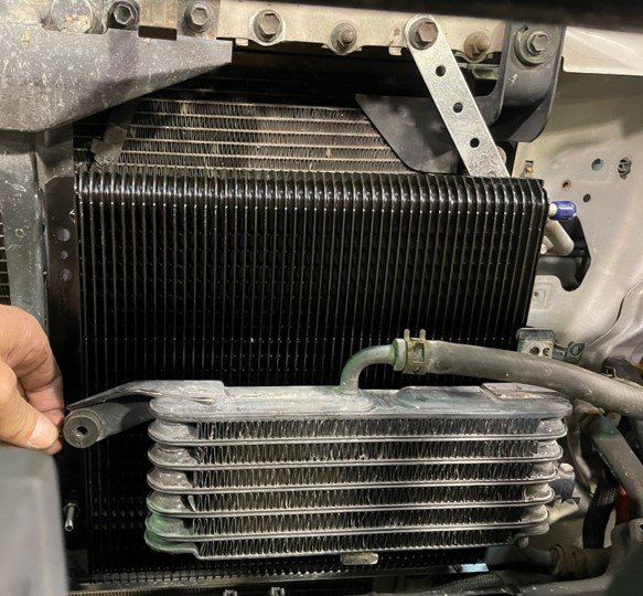

    Thanks for all the info in this thread and a couple others I'll be installing a cooler very soon. I hit 230 degrees on the transmission while towing in the summer heat.
    I have a 2021 that only uses the radiator as it's trans cooler. Does anyone have a picture or drawing of the radiator for the newer Tacoma's, more specifically which lines are from transmission. Trying to dummy proof this for myself before taking apart some hoses

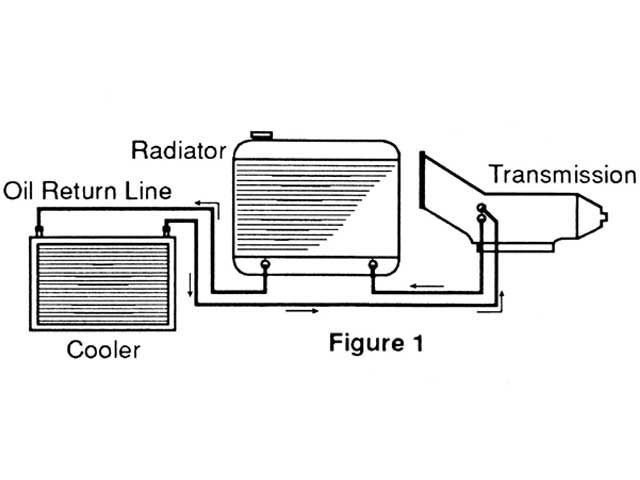

    I thought the bottom was the pressure and the top was return, can anyone else confirm?

    From what I found, and what that diagram above shows, it runs through rad before it runs through the OEM cooler. Top runs directly to trans tstat, bottom routes to the cooler.

    My findings were different. Disconnected the hoses to the hard lines that run to the transmission, with the truck on, fluid was coming out the hard lines to to the hose that ran to the bottom making me believe the bottom was the pressure line. I’ll have to check again this weekend, may have gotten them mixed up.

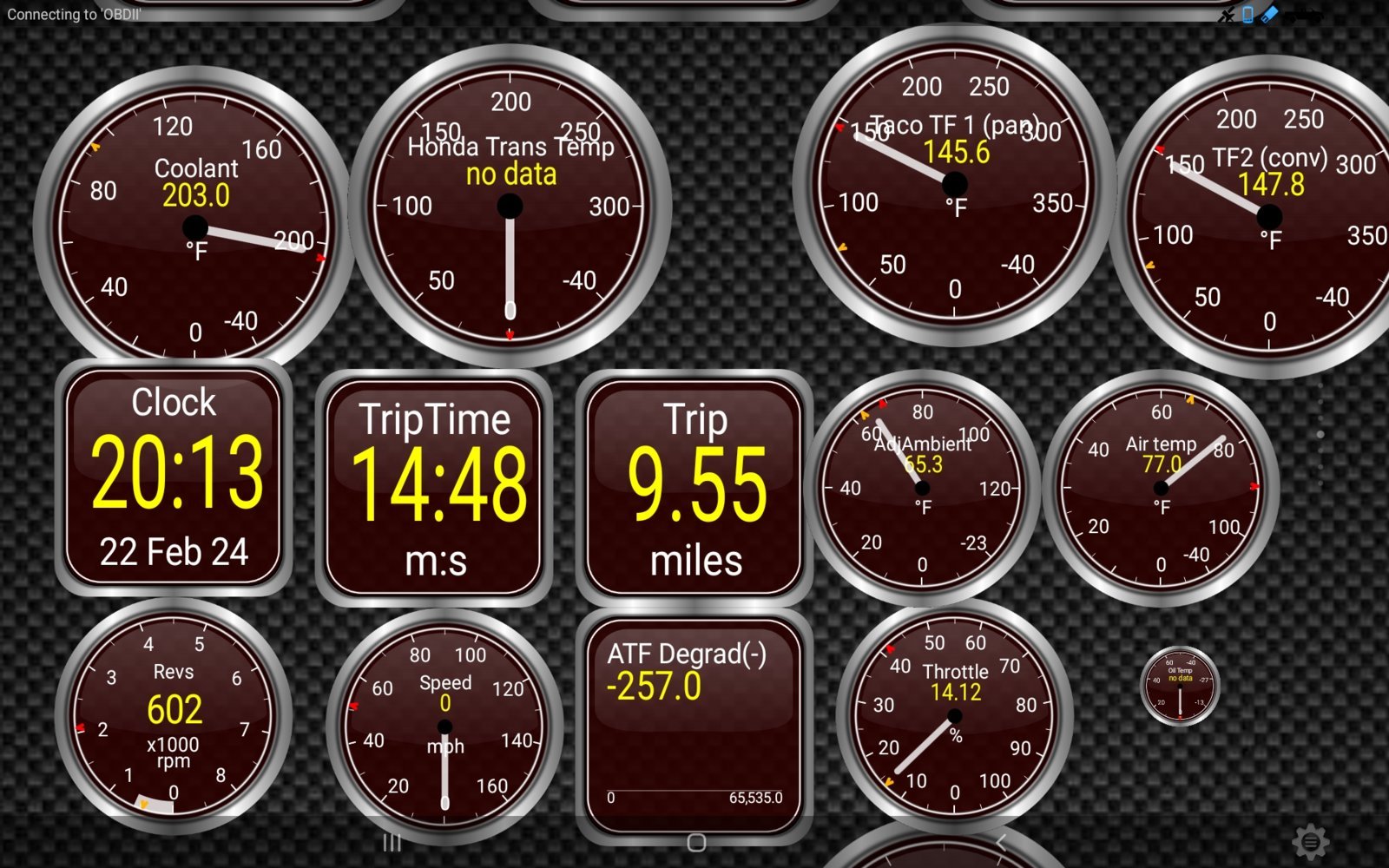

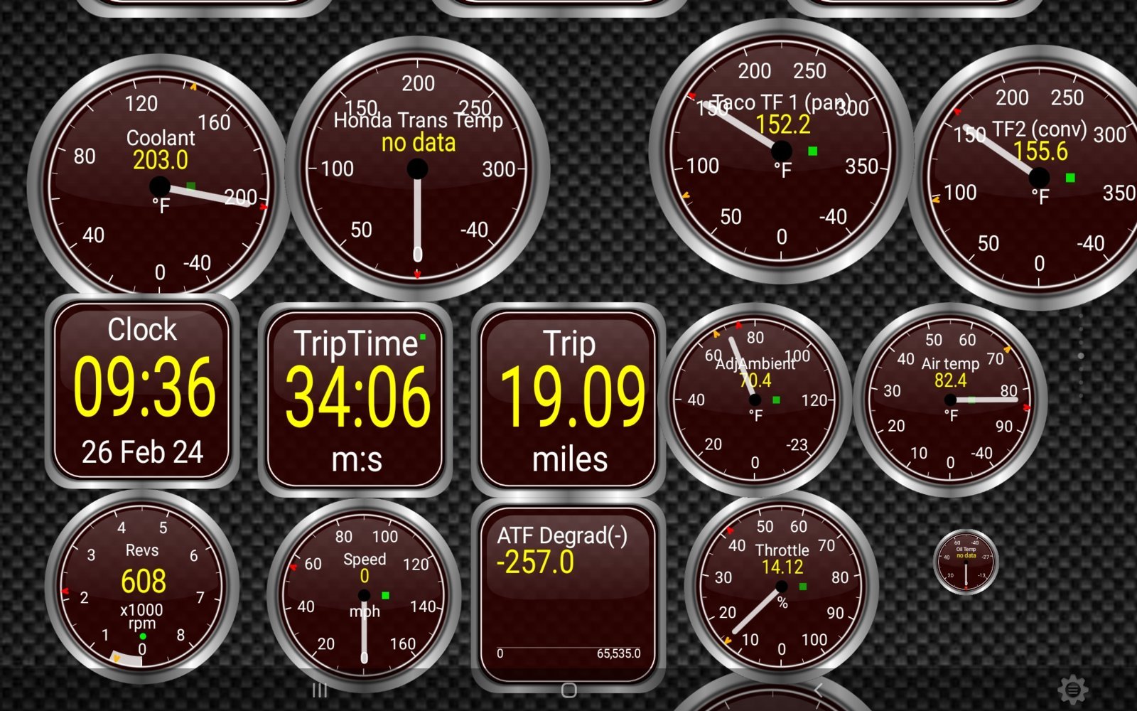

    I have a 2021Tacoma Sport, v6, 6sp, short bed.

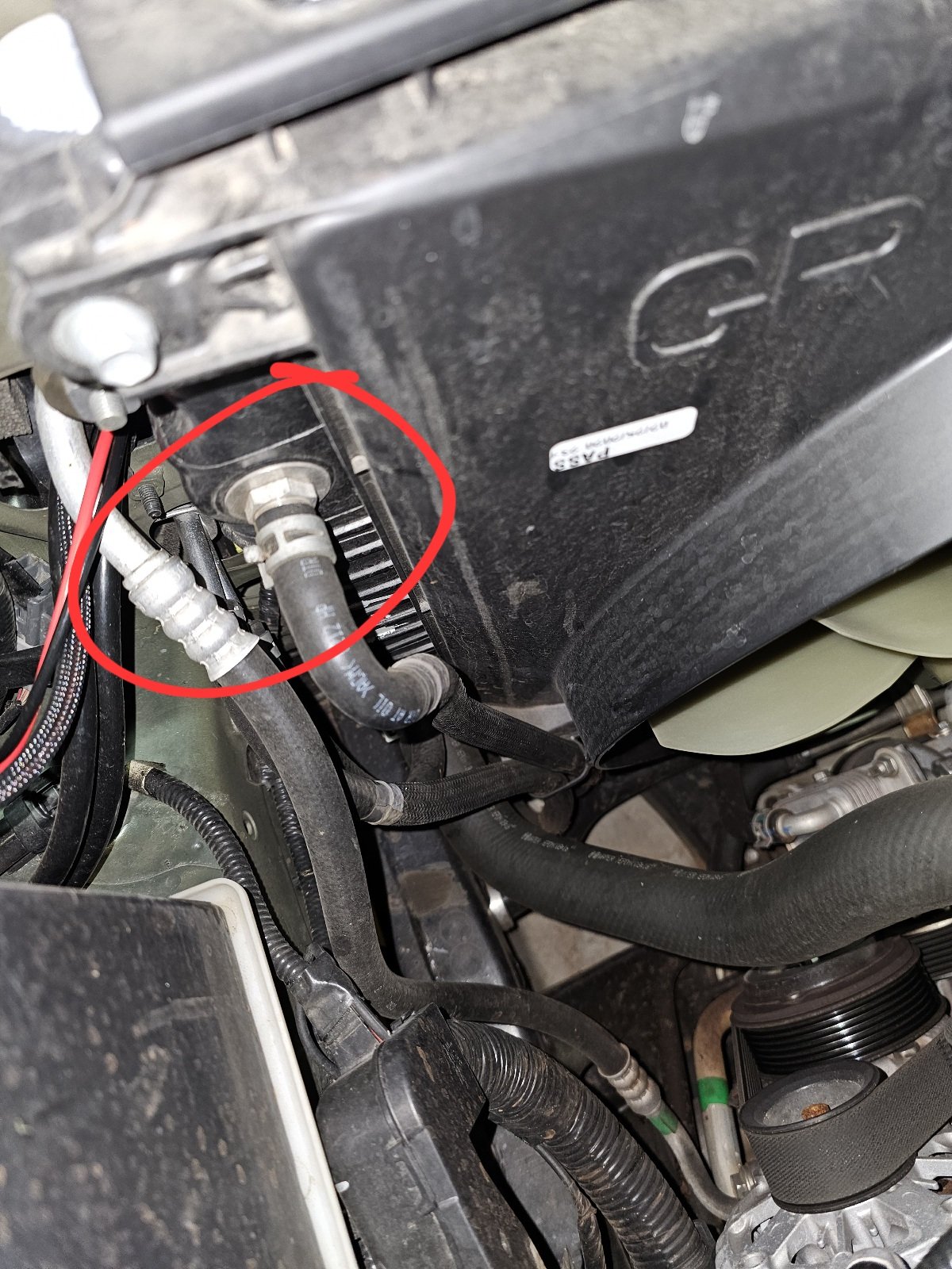

    Trans oil connections are on the driver side, just like the photo in #346 and the TOP Trans oil hose was noticeably ALWAYS hotter than the BOTTOM hose at the radiator - per the post at #346 when checked at idle. The post in #350 does not show the Thermostat.
    Why would the TOP hose be the return hose if it has the hotter oil returning to the transmission?
    I was concerned about the lack of an additional external oil cooler.
    I mounted the Hayden 678, using the Hayden hose, from the radiator/trans oil BOTTOM port to the top connection inlet of the Hayden then spliced with a 3/8" double barbed brass connector the bottom outlet into the original line (bottom hose) back to the trans.
    Radiator bottom port to Hayden top inlet;
    Hayden bottom outlet to brass barbed connector to original bottom return line to trans
    I have great results with pinned THERMOSTAT.

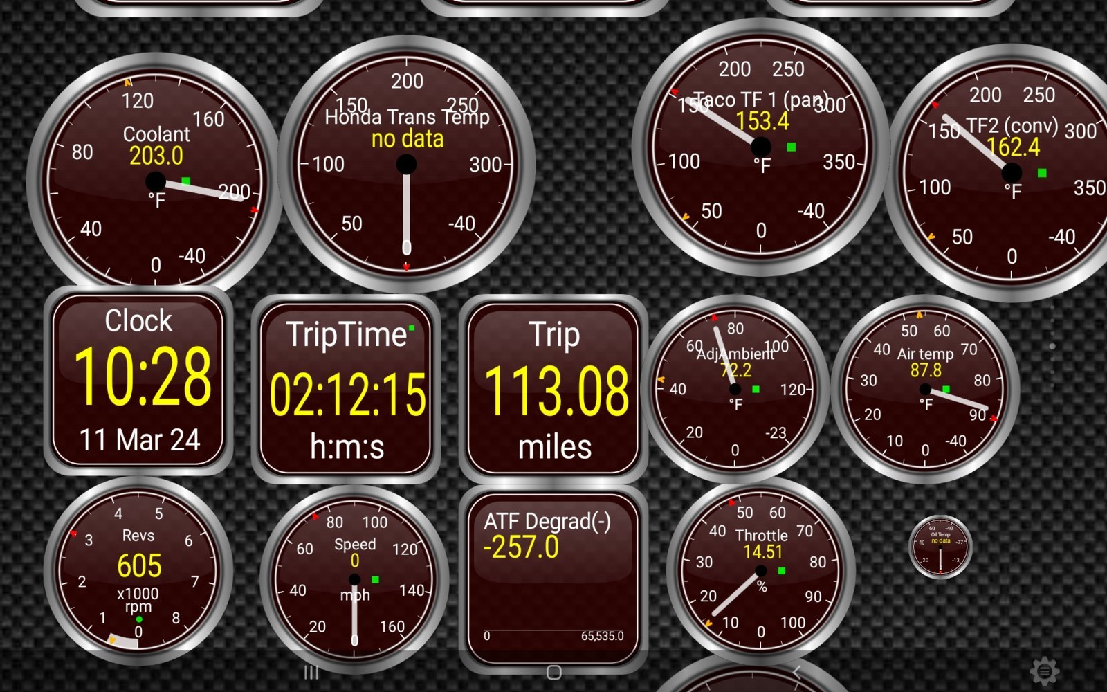

    May 5, 2024 -1hr 50 min, 111 miles, Engine coolant 198F, PAN 158F, TC 158F, Outside ambient 86F, Speed 53 mph.
    June this year at Grand Canyon=4 hours driving, 250 miles, Engine coolant 190F, Pan 142F, TC 143F at 66 mph, Ambient outside temp 42F.
    When sitting parked, TC increases 10 F above Pan temp.
    July 12,2024 - 6 miles, 13 minutes driving, Engine coolant 198F, PAN 155F, TC 167F sitting at stop light left turn lane, Outside temp 107 F.
    TC temps will be appx equal to PAN when driving and rise when sitting.
    Seems a pinned thermostat, with an external cooler works well in the desert environs.
    Have many other trips with similar results.

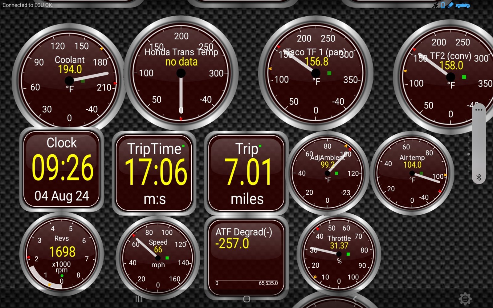

    Another screen print. Today.
    Its about 100F outside. Engine at operating temp. Freeway driving. Look at TF1 Pan and TF 2 Conv temps. Waiting at a light, TF2 can get 10F hotter.

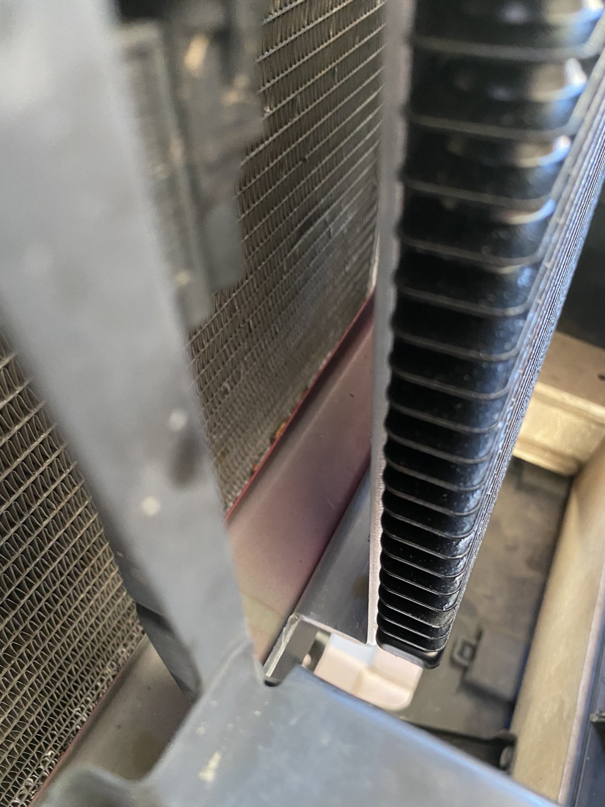

    My 2007 4.0 SR5 quad cab with tow package was getting really hot. Even cruising up nearly imperceptible grades on the highway on hot days I’d get pan temps >200 and TC >225. Off-road, high altitude desert in 4x4 it was getting pan temps of >220.
    After reading through all of the cooler threads I could find I went with the TRU-COOL LPD 4590, in series with the radiator, to get maximum cooling.
    But now I think the cooler I got may have a defective bypass. It’s cooling way too much. The pan won’t go above about 180 and in the mornings when it’s about 70 outside it takes 15 minutes of driving to break 100. I don’t want to trade one problem for another so I need those pan temps back to a good range (sounds like that’s about 170-200 but open to inputs).
    Is this a common problem with LPD4590, or did I get a bad one? @gearcruncher , I know you’re a LPD fan. Any advice?

    Thanks @BlkDakDave. To clarify though, my question was more about Tru-Cool LPD coolers over cooling when in series with the radiator.
    I suspect the bypass on my cooler is defective. Today, the radiator was 195 but the trans pan never broke 125 after a long commute, according to my OBD Fusion.

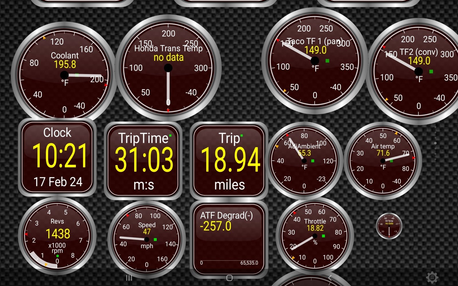

    Here are some Screen Prints at appx70F running temp with about 600 lbs in the PU for camping. Not towing.
    Notice, these are for a PINNED t-Stat with the Hayden 678. (I would expect similar result with the TC LPD 6588 if I chose that one.) The cooler is run in-line/series with the radiator cooling.
    I could increase the temps by 10F if I put on my cardboard wrap/block in front of the cooler and I did so this past winter. It was about 3" wide - full height of the cooler and blocked I'd say 40% of the cooling fins. Seemed to work OK - That's how I know about the 10F temp increase.

    Thanks for the reply @Tacogent. I have a gen2, so no thermostat to pin. That LPD4590 is a beast, especially since I am not towing regularly. It's about 4x the surface area of the stock cooler:
    But I got it because it's supposed to bypass when cold, so you shouldn't be able to overcool. I did slap a piece of cardboard over it in the morning and it mitigates the overcooling problem...but I'll need to add an external bypass or replace the cooler to get a sustainable solution. That sucks...

    Very suspicious of your 125 F number. That cooler is designed to bypass until ~170 F. I'd get an IR thermometer on the inlet an outlet of the cooler for sanity sake. Does the OBD fusion require any math or manual parameter identification to read the trans temp?
