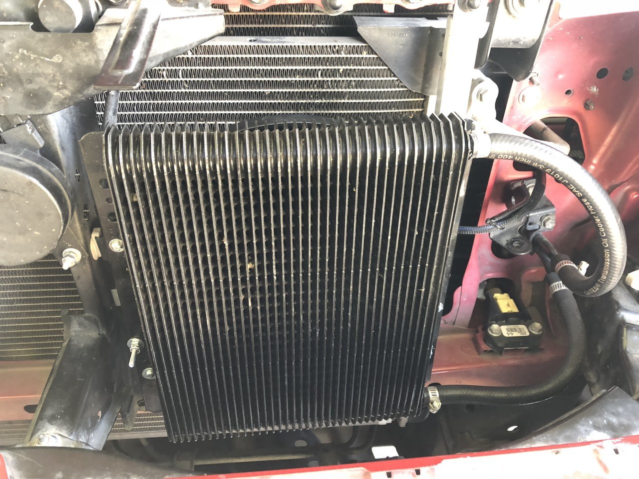

    This is the cooler I’ve installed on my 2012 OR. Tru-Cool 4489. I’ve bypassed the radiator cooler too, just run this cooler alone for the transmission.

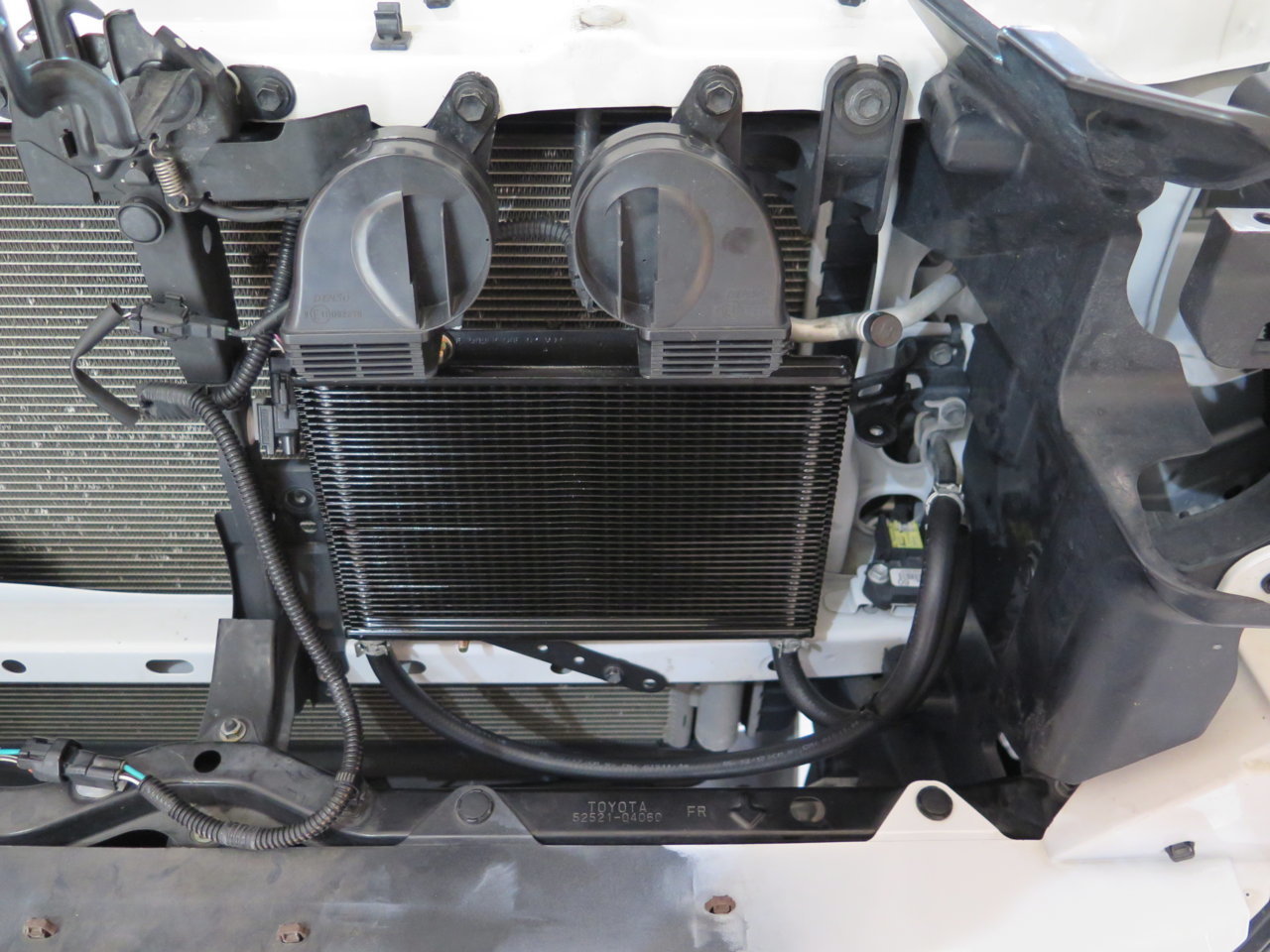

    Very well done sir! Have you seen improvements in cooling?

    Temps don't seem to exceed 200 so far, but it would be lot better if the thermostat opened at a much lower temp - say 175 vs 190+.

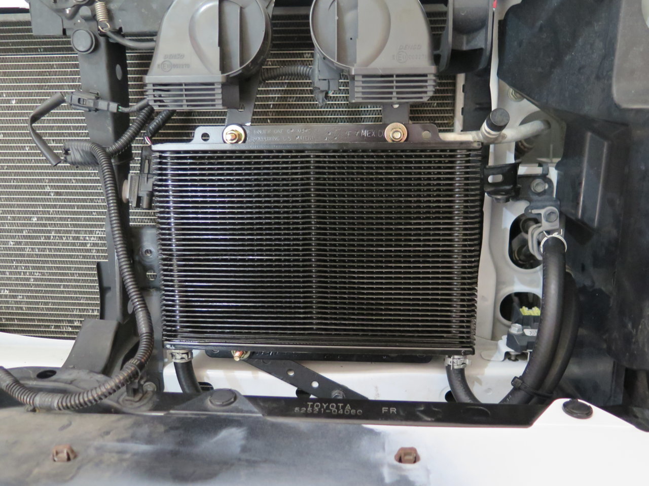

    I mounted mine exactly like yours. Thanks for the photos!

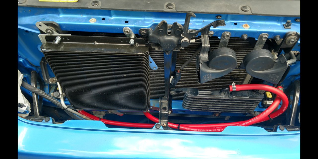

    IIRC they are the same. I got some new lines because I run them in sequence.

    Wish I would have thought of this before I removed the factory cooler. I could could put it back on and do what you did. Nice clean install.
