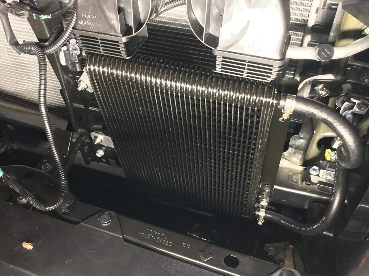

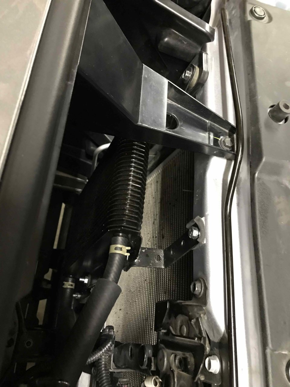

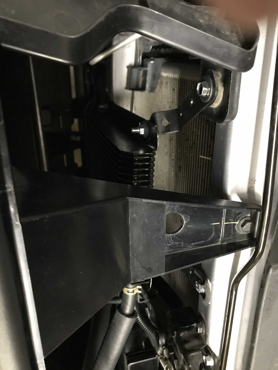

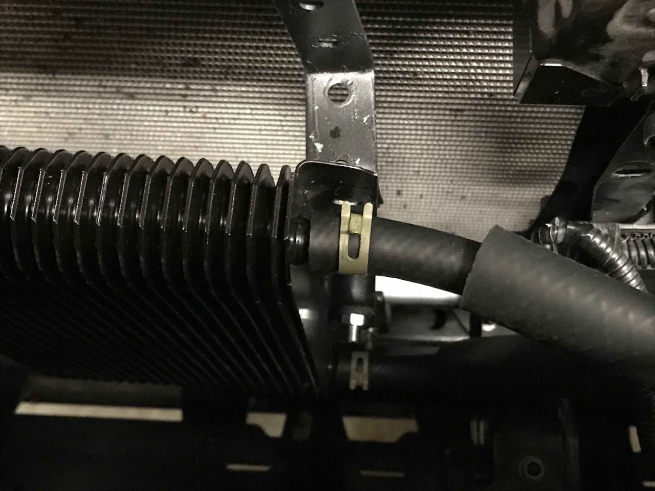

    Thanks Gearcruncher and everyone for the awesome posts. Yesterday I installed my TruCool LPD4588 as an auxiliary transmission cooler.
    I chose this cooler because it has smaller frontal profile than the 4544 but is thicker and has a similar rating. I chose to use some spare 3/4 water hose over my cooler lines for protective sheathing. I elected not to remove the grill for the install. but would have removed the grill if I did this again because of the number of times you need to remove and install the cooler for bending/sizing brackets, painting brackets, sizing hardware etc. I used some small rubber grommets from my local ACE hardware store to insert into the cooler mounts and the cooler end of the brackets as well as some larger bushings for the mounting end of the lower brackets.
    I added a 32 ounces of ATF fluid back into the return line and took out 8 ounces of fluid after doing a fluid level check. So it looks like the cooler and lines added about 24ounces. I drove it last night and will tow with it tomorrow, then will decide if I want to unpin the thermostat....

    Thank you for posting your install .
    Looks good and I am sure it's going to help prolong the life of your trans .
    I did this write up because Tacoma World didnt really have much on transmission coolers .
    Thanks for the help , we now have a darn good write up with all 3 generations of Tacoma,s .
    With this being said ...Thanks guys .
    Enjoy :thumbsup:

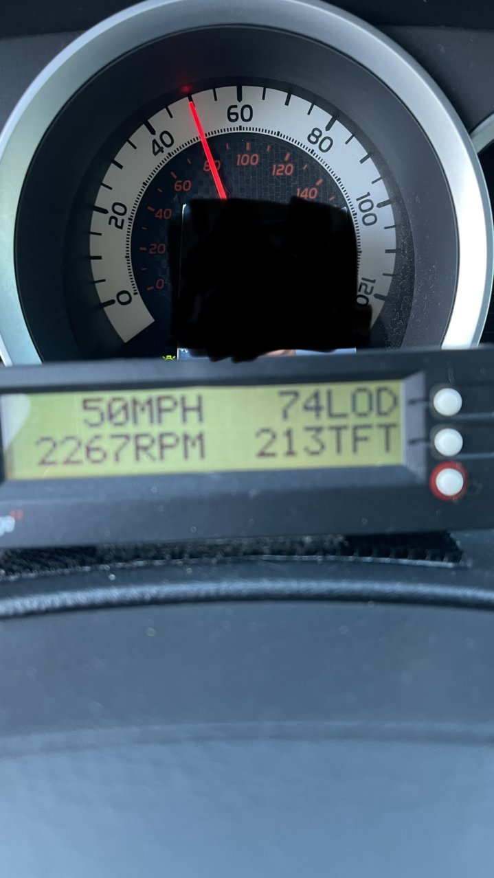

    Picked up my trailer today and towed it 1hr 50 minutes home and was up hills, down hills and flat roads. My scangauge TFT was fluctuating around 190-215 throughout the drive home. I have a transmission cooler but the factory stock small one. Should I upgrade and if so can I have a secondary one on a switch to turn it on when I need it when towing and switch it off when not towing? Besides TFT what else is on your gauge for towing on your scanguage?

    A switchable cooler sounds like a plumbing nightmare.
    Just replace the factory cooler with a larger aftermarket one. Then, it just works. No switch required.
    Adding a temp gauge is not a bad idea either.

    that’s not a temperature gauge of the picture I posted? Many say to run a large cooler in the winter is bad for the transmission as it takes longer to heat up?

    I run a temp gauge with the sensor in the fluid path - in your picture, I am not sure where the Scangauge gets its info.
    In the winter, my transmission does take a long time to heat up. I am not sure if that is a problem for the transmission or not. I am planning to add a temperature controlled flow valve - it will only open when the fluid temperature is hot.

    I have had good success with my larger, replacement cooler. I have a temp gauge, and always watch the trans temps. The trans can get a little too hot off-road, towing uphill. I stop for a while, and everything cools down.
    The trans does stay really cool in the winter. I probably should add the controller.
