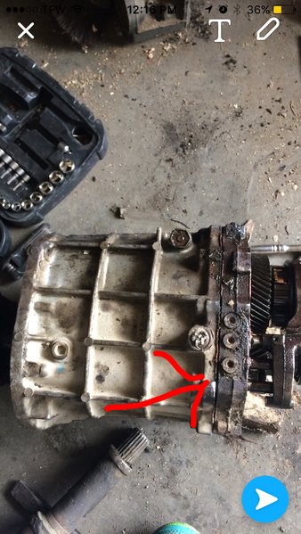

    I am trying to get into the gears of my 1995 Tacoma five speed transmission. I cannot seem to figure ot where to go from here

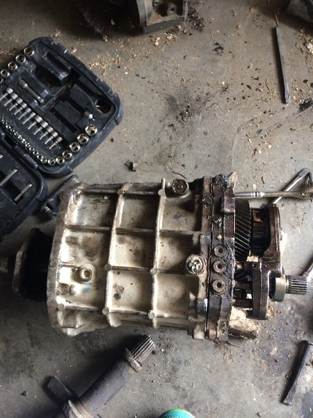

    This is the part I am trying to get apart I can pry it a bit but it will not come off all the way

    Is that the W59F or the R150 transmission?
    If it's the R150, once you pull the bearing retainer on the front side you need to take a brass rod and a hammer and (carefully!) tap around the entire transmission case on that side (the left, in your pictures) to separate the case from the intermediate plate.
    Don't try to pry it off, or you can damage the case and then it won't seal up when you put it back together.

    It's the piece at the front of the transmission that bolts onto the front of the case and slides off over the input shaft once you undo the bolts.
    Give me a few and I'll try to find you a disassembly diagram.

    ekk... you might not have had to pull the trans out... I hope my description using words is going to be clear enough... On the intermediate housing, the cast plate about 1 inch thick, you will see 3 screw plugs. These plugs keep a dentent plug and a spring in place. these detents give the shift rods that notchy feel and help hold the slider in gear. these you can get to from the outside of the gearbox while installed. In between the 3 shift rails there are floating detent plugs also, these prevent you from engaging 2 gears at once. as the shift rail goes from neutral to a gear the notch in that rail is moved forcing the plug to lock the next rail inplace... this might be what you are experiencing.

    I agree, this totally sounds like the detents are at fault. They're those three screw plugs right above your red arrow in your second picture, OP.

    So what do I do to check/fix this.. and it seems like I don't have an intermediate plate

    Well the intermediate plate isn't supposed to come off; the larger part of the case is. Think of the intermediate plate as the base that everything else attaches to; it's what you start with.
    Unscrew the plugs and use a magnetic pickup tool to pull the springs and locking balls out, and then see if you can get it out of 4th. This is step 13 in the guide I posted above, if you want a visual.
