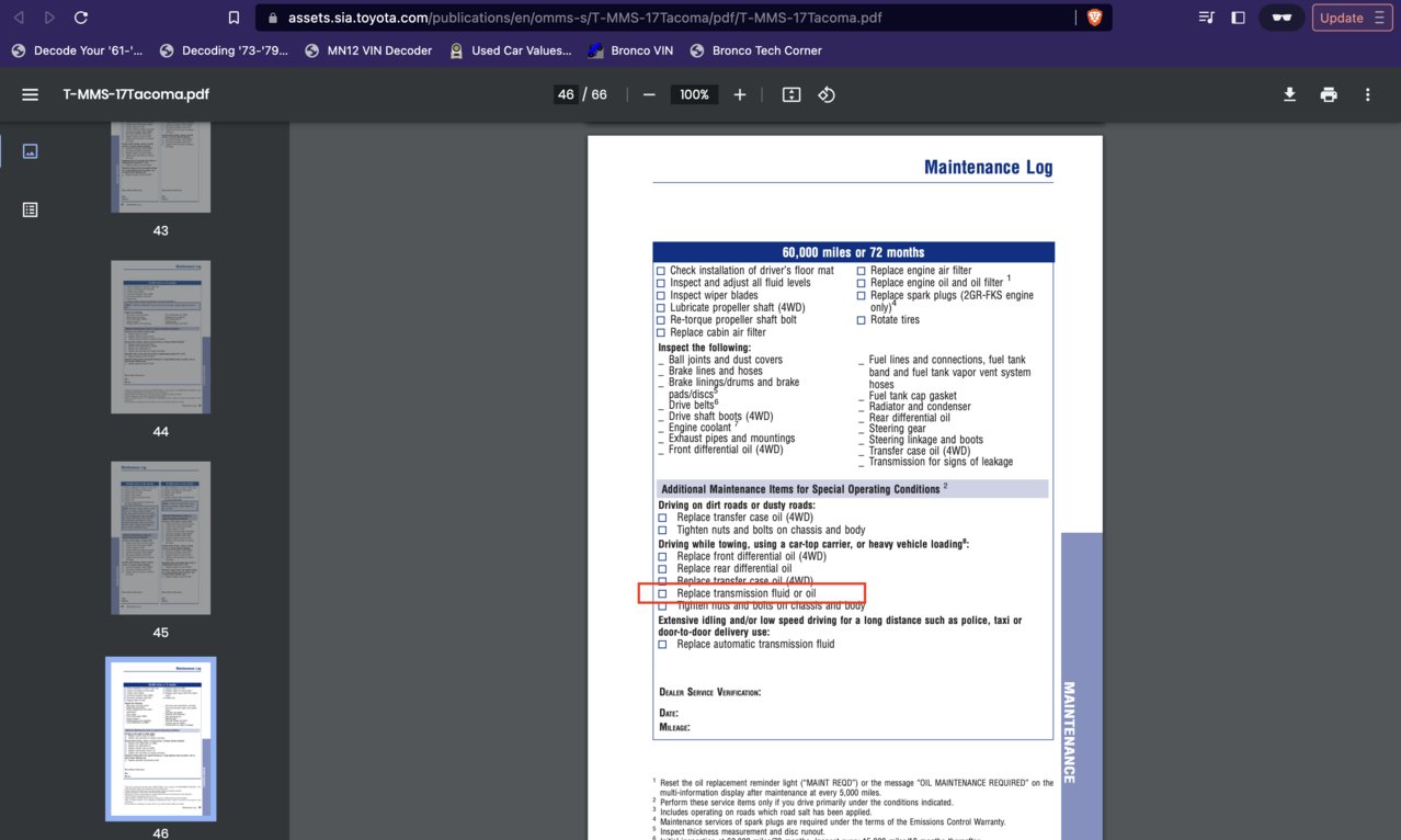

    Incorrect. Check your warranty and maintenance guide (.pdf for OP's year). It is in black & white under the additional maintenance items for special operating conditions at the 60k mark / 72 month. If Toyota insisted on not changing transmission oil why would it be an additional maintenance item?
