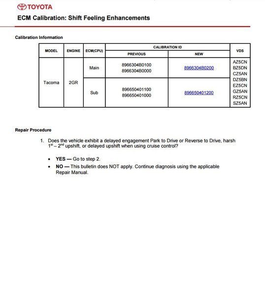

Transmission TSB 0077-16

    What prompted your dealer to call you? Was it only for this issue out of the blue?
    Thanks for the info.
    Interested if it helps the truck upshift again once a hill has been crested in CC.
    (waiting for the post where you show up and your service manage says "whoops, this software update is only for the 4cyl, sorry about that")

    LOL, I have a long history with my service manager since I bought the truck. I've had many, many, repairs and he's on a first name basis with me and calls me every couple weeks to check in on the truck. I gave him a great review and we have always been more than nice to each other during this entire process. There are still some issues we are working on to get lined out. I posted that this was coming a few weeks ago and got flamed because no one believed me and I have no TSB number.
    So as usual, he's a man of his word and let me know as soon as it was available.
