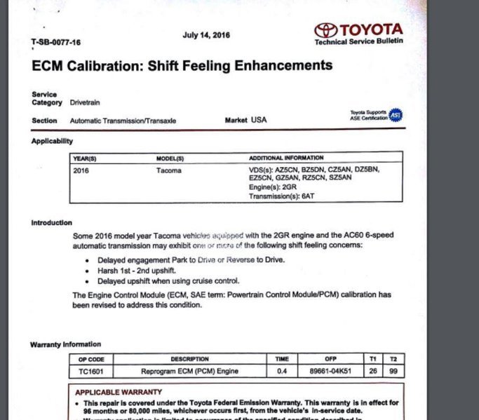

Transmission TSB 0077-16

    Apparently the TSB was released yesterday (14 July 16). Seems to have created quite a stir. A thread with a scan of the TSB is stickied.

    Found this on FB.....Its for a 6 cylinder.
