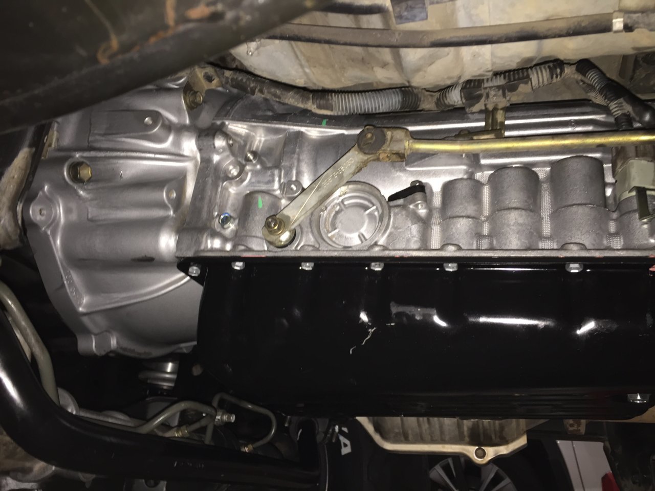

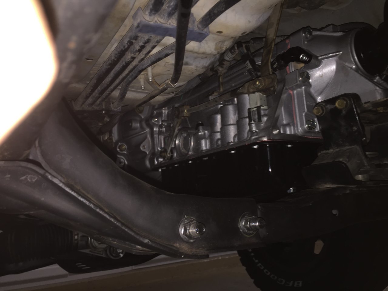

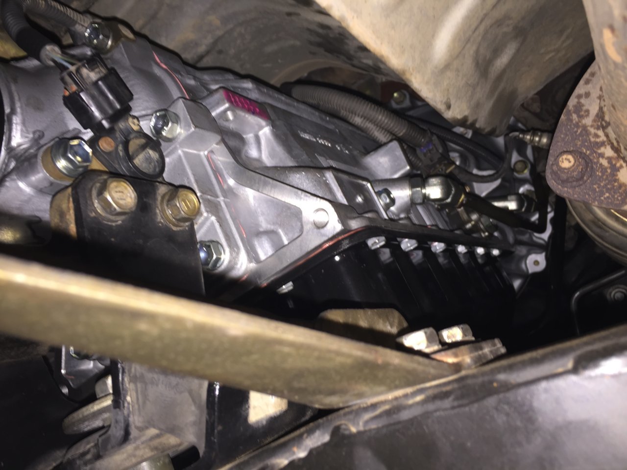

    So update on the Transmission noise, it was the Transmission pump that was going bad, most likely caused by something else that started it.. I know I could have rebuild the Transmission for cheaper. But I just bought a Factory Transmission from Toyota and called I a day..The Truck drives Amazing now!!Crazy how much more power it has, and how much smoother it is..
    Hopefully this thread helps someone else out[GALLERYin the future.
    Thanks for all the input guy..!!
