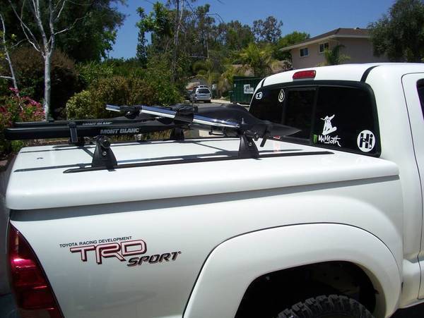

    Is this what you are talking about? Can you post a pic of what your bike looks like on it?

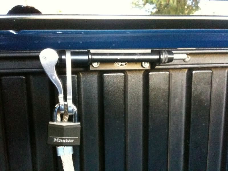

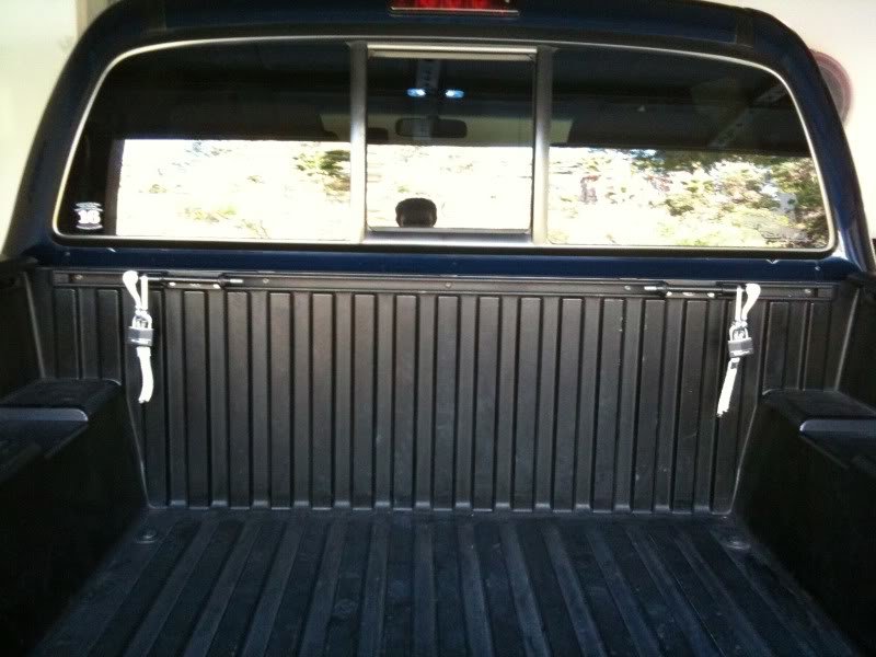

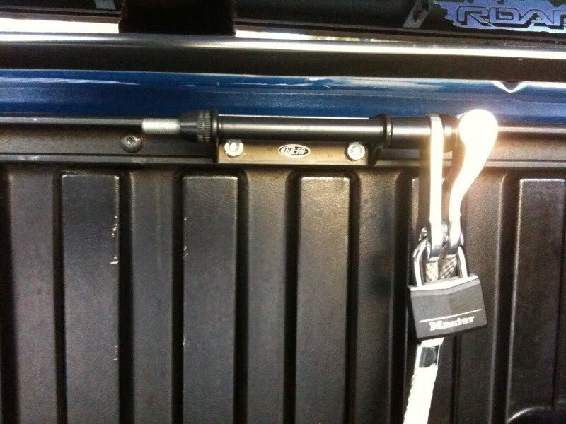

    Here is my fork mounts.
    The brand is Delta. I got them on Amazon for $14.00 each.
    As you can see part of the clamp on the skewer is fixed, which makes it so you can lock it (locks purchased separately), but it also makes it hard to pull the clamp open because you cannot get your finger in there. I added the rope so i have something to pull on.
    As for mounting it in the rail, I got a piece of aluminum from Home Depot that was 1" wide x 3' long x 1/8" thick and cut off a piece that was the same length as the mount, drilled holes to match the holes on the mount, and put 2 bolts with locking washers through the back and a nut on the front to hold it all together. Very sturdy and can be used a tie down when needed.
    At some point i will probably either upgrade the skewers to something like the Yakima ones, or get Rocky Mounts fork mounts, but i was able to build these two into my bed rail for less than one Yakima or Rocky Mounts fork mount, so i am OK with it for now..

    Whitetaco2 yes. Thats I mean. go to my site and I have pics of bike mounted. lucky for you Im going riding tonight so Its mounted. If I didnt have the tonneau cover I would use the tail gate pad as suggested by Physiodude, Its the easiest of them all. Thats if you prefer not having to remove front wheel.
