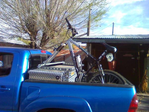

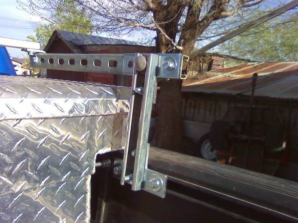

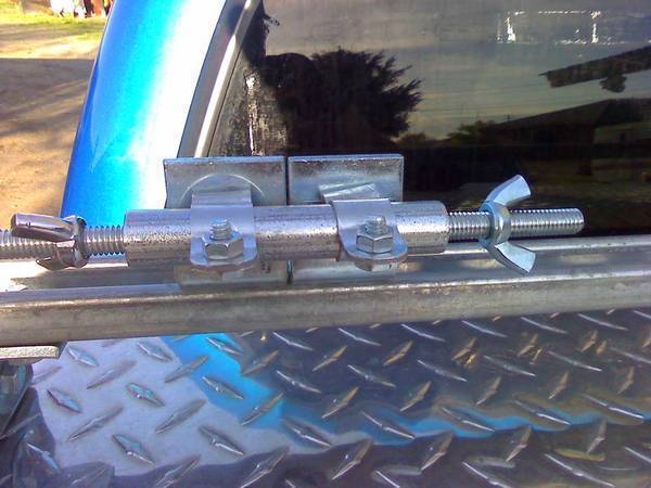

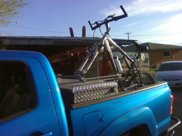

    I designed/made this rack and fork mounts to fit 4 bikes in my DC Short bed WITH a truck box...
    To access the truck box, I pull a pin from each side and rotate the crossbar upward, can even do it with 1 or 2 bikes still attached just have to drop the tailgate so they can back up. VERY sturdy and it was free minus a few hours of build time. Not the prettiest thing, still need to paint and make some adjustments but VERY functional
