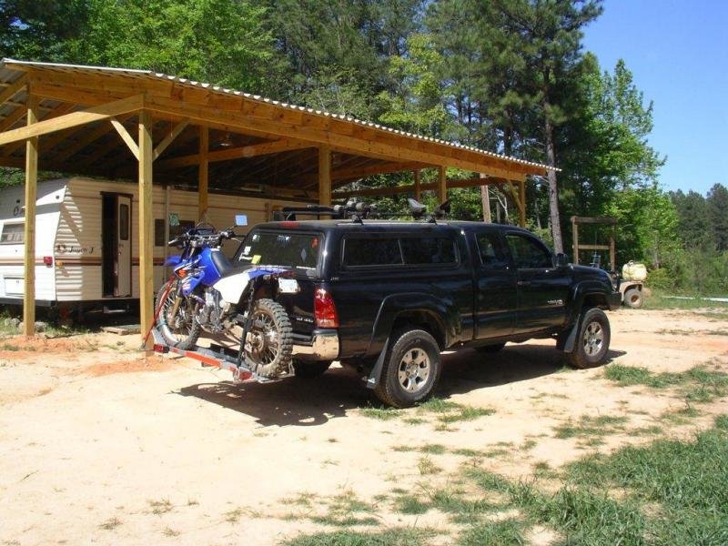

    One bike is doable but I can't think of any way you're going to get two on there due to the weight; the fact that it's cantilevered out makes it that much worse. Even with only one bike you're probably going to need to upgrade your rear suspension unless you're riding something small and lightweight. My DRZ was a bit of a pig.
    If you don't have a shell on the back an option I've seen folks use is to put a piece of plywood in the bed to extend it far enough to carry bikes. Obviously you have to do something to secure the front of the sheet it so it doesn't flip up when loading and unloading.
    There are some smaller single bike trailers made to haul bikes that stand on end or even break down for smaller storage if you have a little bit of room; they aren't cheap though. Ex https://bulldogfoldingtrailers.com/
    The least expensive ideas I've seen are folks buying the small Harbor Freight trailers and putting a motorcyle rail on them (several examples of HF the tiny HF trailers here: http://advrider.com/index.php?threads/show-me-your-open-or-enclosed-motorcycle-trailer.419752/). When I was into VW buses several of the guys in the camping club pulled dirt bikes or scooters that way. They're small and light enough that you can flip them up against the side of your house out of the way as well.
    DRZ400s is on a steel carrier and the truck has OME Dakars on the rear (no add-a-leaf). The loading ramp is secured on the hauler behind the bike. The truck is not on level ground but it sat level with the bike even with some camping gear in the back. The camper/shed is at my buddy's hunting land; that's an older Suzuki quad with the spray tank in front of my truck.
    Something else to note, and it's probably more applicable in CA than SC, the bike obscures the left side tail light. I had trailer lights mounted on the hitch hauler- another added expense. Just something to figure into the costs.
