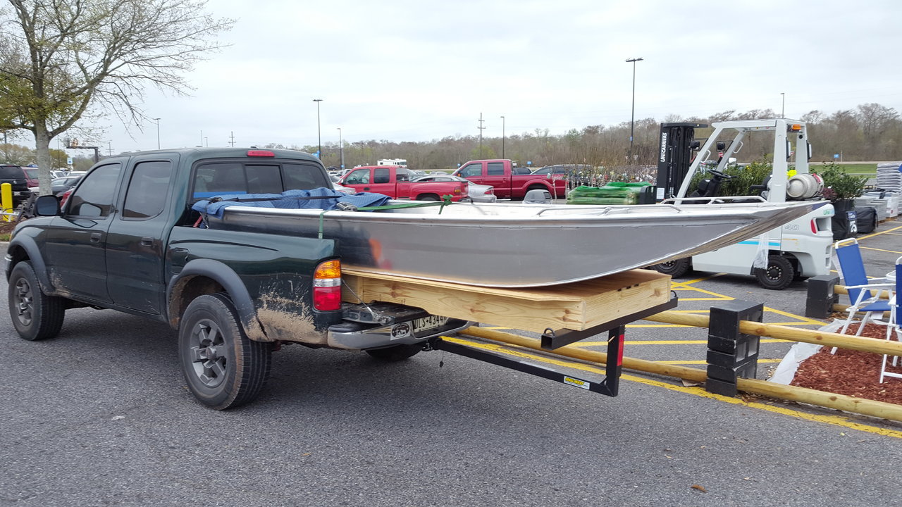

    I used a similar concept when I went to Patterson Louisiana to pick up my boat. I made mine so it would nest together for the trip down.
    Boat is 12' long for reference
    KeystoneGoodie likes this.

    Wow, that boat fit!
