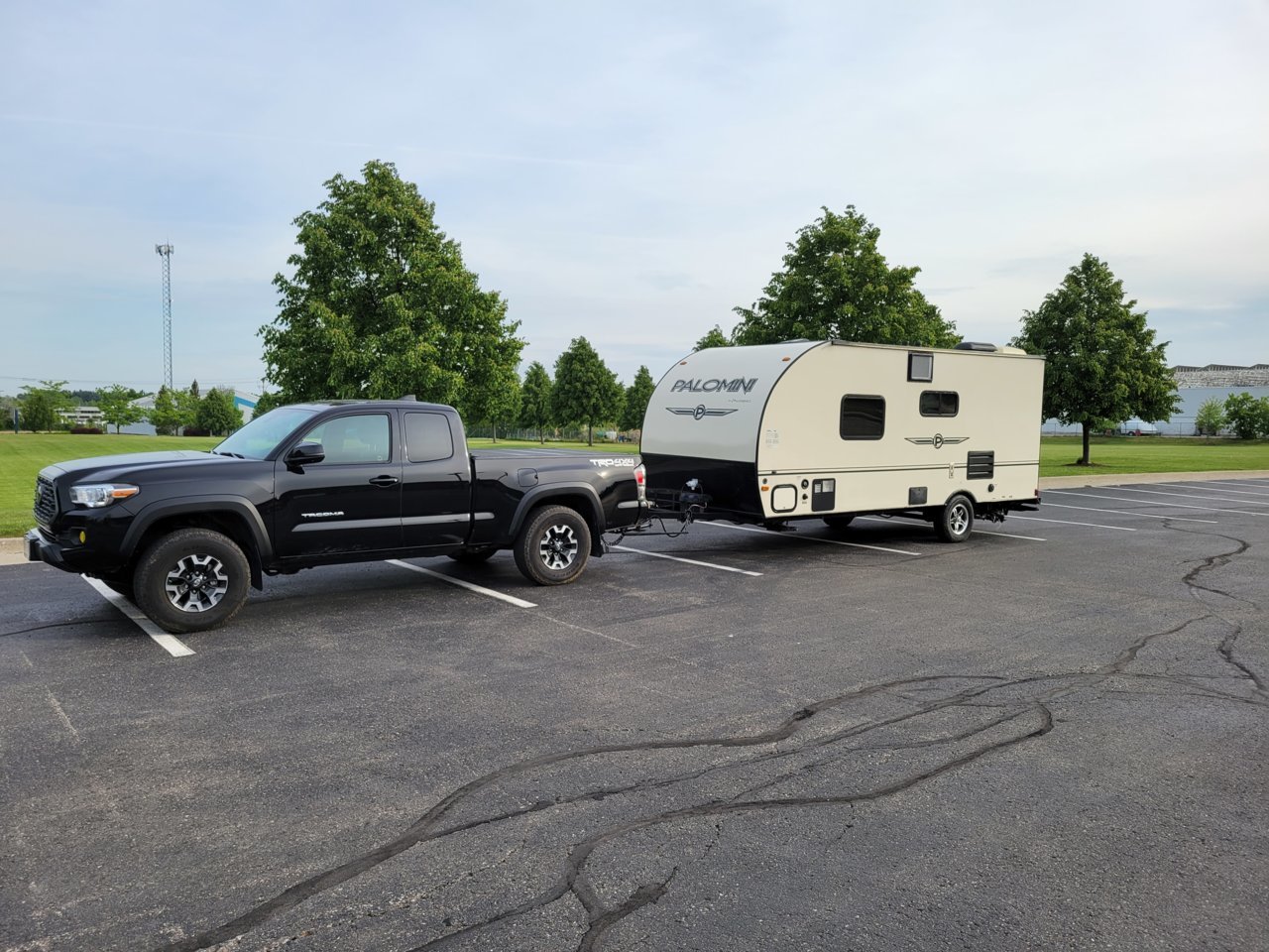

    Hello Everyone: looking for input from those more knowledgeable than myself. 2018 tacoma V6. Everything I can find tells me tow capacity is 6700 lbs. Looking at purchasing a camper with dry weight of 3500 lbs. My concern is pulling the weight through mountains and hills out west. Anyone have experience with a similar scenario? Thank you!

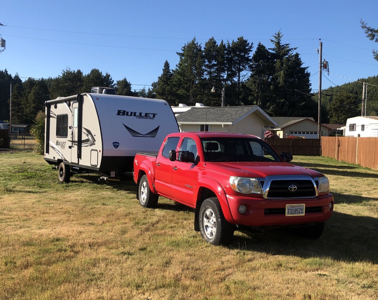

    A few weeks ago me and Mrs took our first ever trip with our trailer. Our trailer is 3400lbs dry.
    We pulled from Sacramento to Coos bay Oregon. Our ‘07 Taco did fine over the passes, but we did tend to hang out with the big rigs going up hill

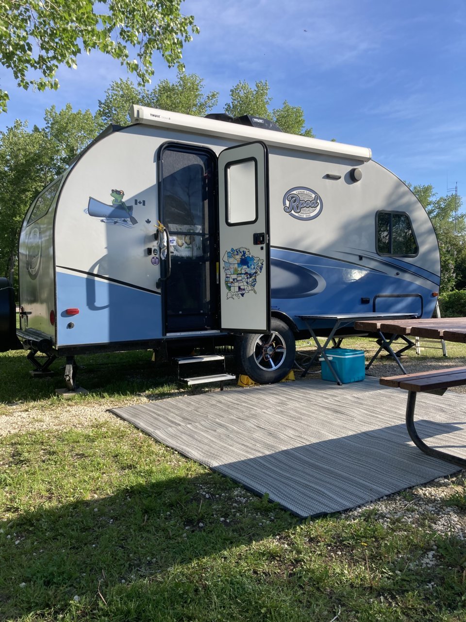

    I tow a 3200 lbs. R Pod ready to camp in the MTN's and it does good, just go slow up hills I keep it at about 45 mph. I best thing I did was add a larger trans cooler and a WDH.

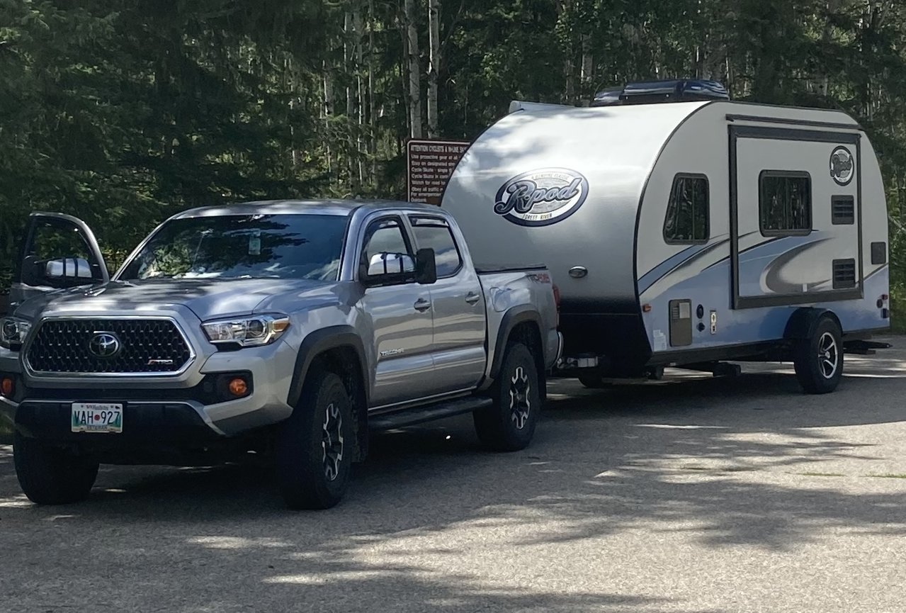

    3200 lbs, so near as makes no difference. It'll go up any hill I point it, but it'll rev doing it. I personally think it does fine.

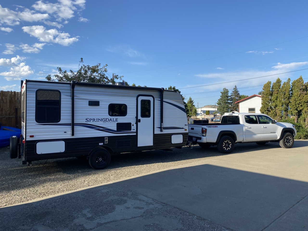

    I was just in the same dilemma as you. We just ended up getting this. It’s 3300lb dry. We just did a trip from Yakima, Wa to Seaside, Or plenty of mountains and hills. 460 mi round trip. It towed great with a full holding tank, belongings, me, the wife, and a 100lbs of dogs. It was VERY hot here last week too! When we left it was 110 degrees. 6-7% grades were a little tough but we chugged right along about 40mph. I probably wouldn’t want to go much heavier than this and I wouldn’t do it without a good WDH. I also used the manual shift, especially up hill. You won’t break any land speed records and you’ll be hanging with the semi’s a lot but I think it did great. 073561CB-5512-4282-ABD1-67CCF5D50014.jpg
