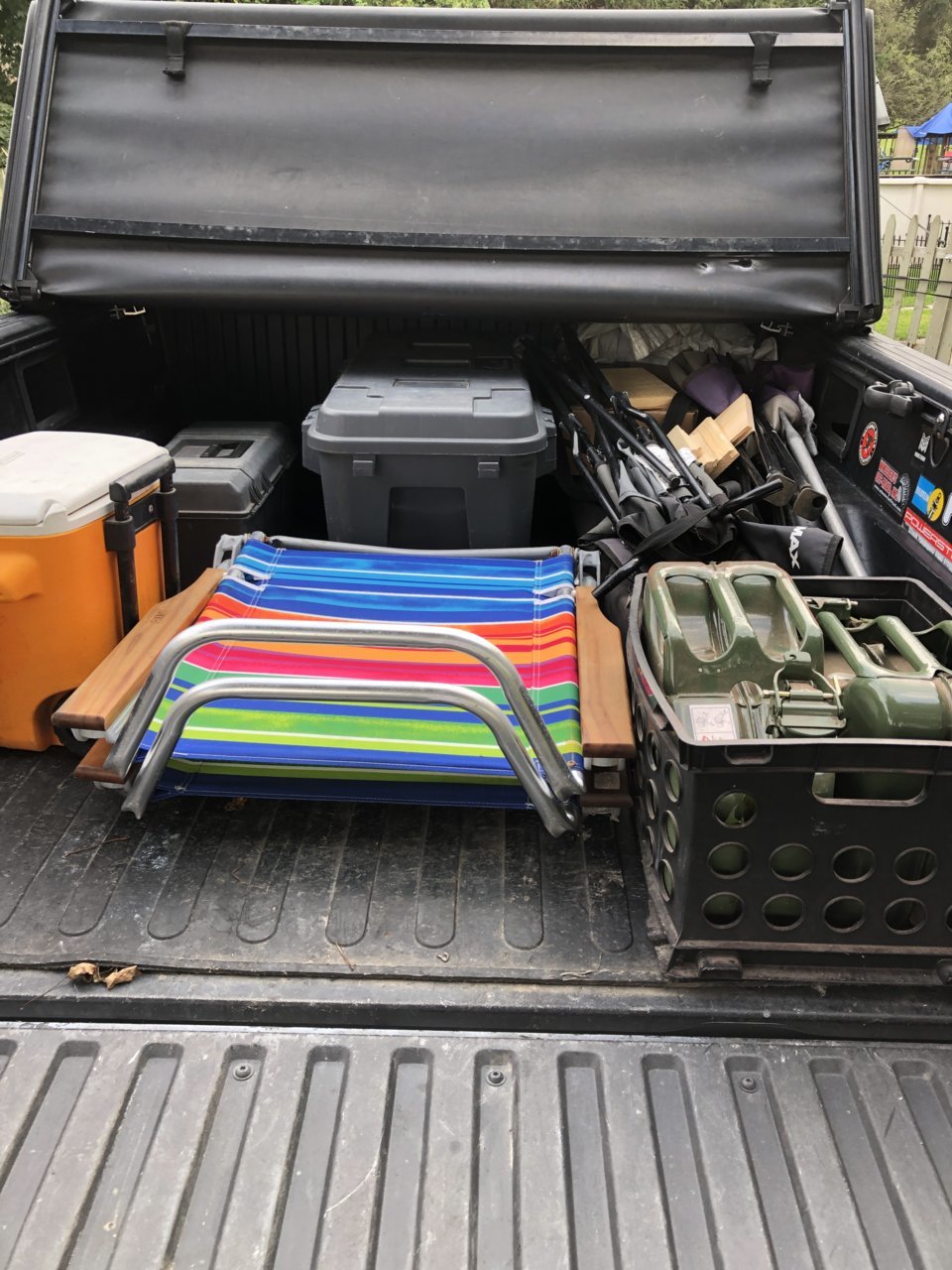

    Just got back from weighing the truck with some gear in the back . Just because I’m curious. Large Plano tote with Jack and tools in the bed . Small tool box I take on camping trips. Easy up canopy,2 beach chairs ,2-2.5 gallon jerry cans filled with gas and a small cooler with 10 beers in it .Very small amount of kindling wood . Aftermarket hitch for towing the travel trailer . Transmission cooler. Tires are 285/70/17 with American Racing Baja Aluminum wheels.
    Truck weighed in at 4780 :eek:
    Aftermarket rear bumper ,weld on sliders . Bilstein 6112s ,5125s in the rear with Dakar’s HD .I was guessing around 4300 but I was off a bit . Camper weighs in at 2790 dry . Might as well add another 200 pounds of stuff in there also . Then I weigh 190 ,wife 140 . Puts me up around 8100 ! All that in a truck that I purchased new without a tow package because 14 years ago I towed nothing :oops:

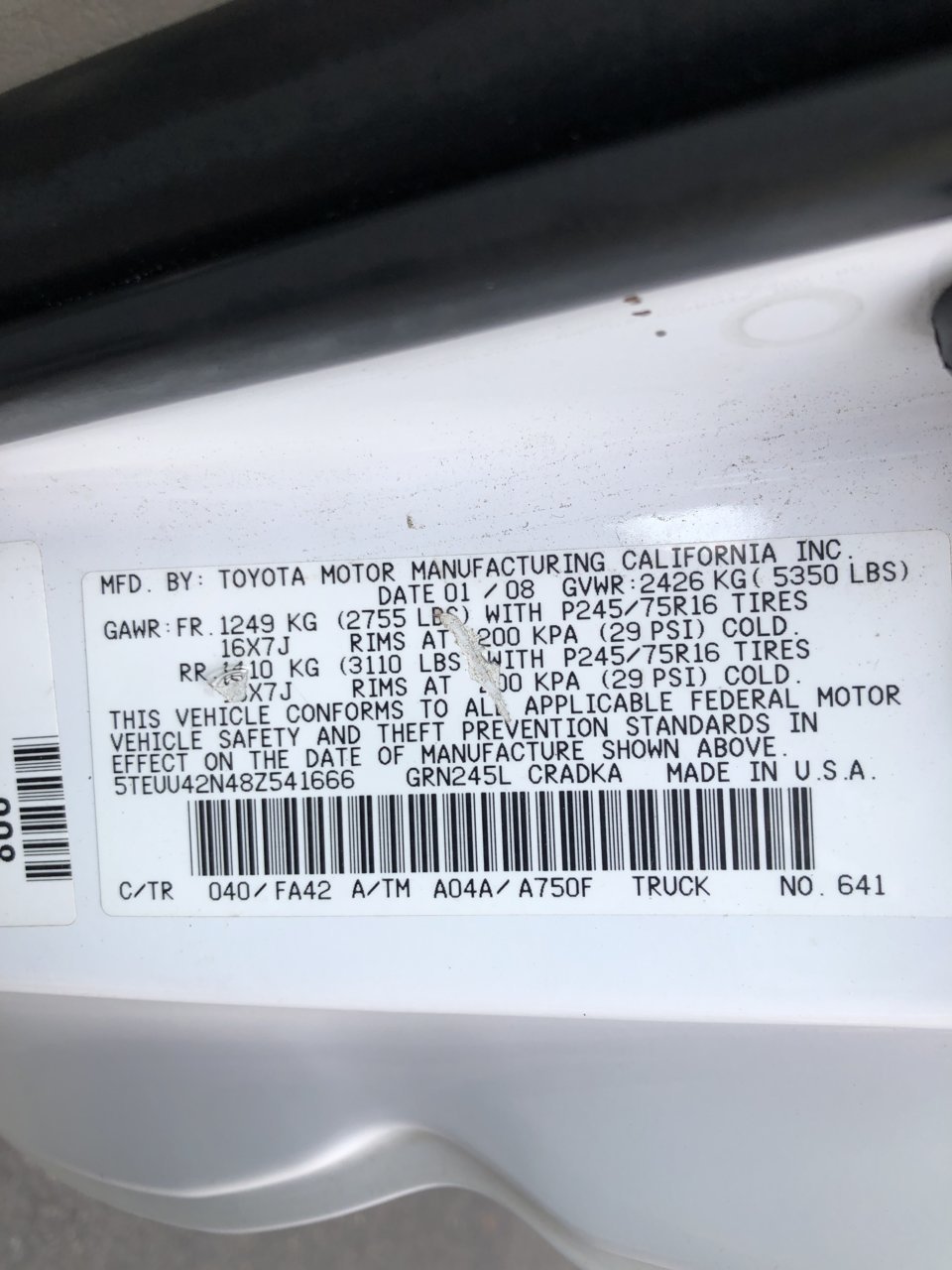

    This is the door jamb sticker . As stated no tow package SR5 when I purchased new in 2008 . Weighed truck as a whole not individual axles

    What I have added in aftermarket stuff is beyond anything OEM Toyota .
