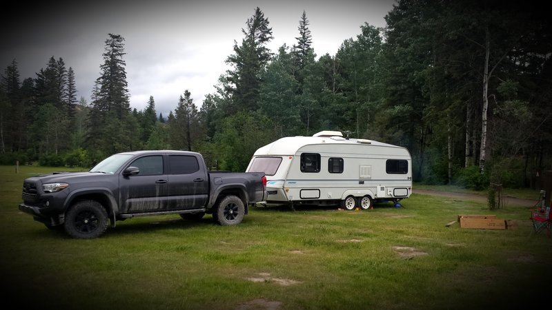

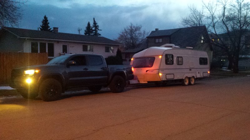

    Here's my trailer. Dual axle but similar weight (3400 dry). 20160316_201010.jpg 20160523_133645.jpg
    I have a P3 brake controller I just need to wire but have found so far on 4 trips that the brakes on trailer (electric) and Taco brakes are more than effective for this set up.
    I also currently have no weight distribution hitch but would reccommend it mostly just for less walrussing and momentum loss when you hit bumpy sections (comfy). I've found alot online for 250-350 on average- next seasons purchase budget ☺
    Pin connection @ rear is 7 pin, 1 pin for elec brakes and 1 pin for charging on board batteries.
    I find 90-95 km/h a nice comfy cruise speed for her. Averaged about 16 L / 100 km for 300 km trips (1 way). Sometimes 15 with little wind and chill mode activated

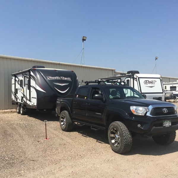

    3 1/2" lift 33" tires Airbags Nfab steps Remote Start Thule Racks
    Tow 22' (24.5 overall ) 4500 lbs empty .
    Mines a 2nd gen, '13. Looking to upgrade to a 3rd gen '17.
    Current Taco has 3" Toy tech lift, 285 tires, air lift air bags to level out with trailer on, Equalizer Anti sway bars/weight distribution hitch , & Prodigy brake control. Power is so so , over 10k plus elevation have never overheated, just kinda slow, utilize transmission down hill . Full size truck would be ideal, would go for a F150 3.5 echo boost but like size for every day driving of Tacoma, as well we off-road ability is important & the Tacoma does very well off road.
