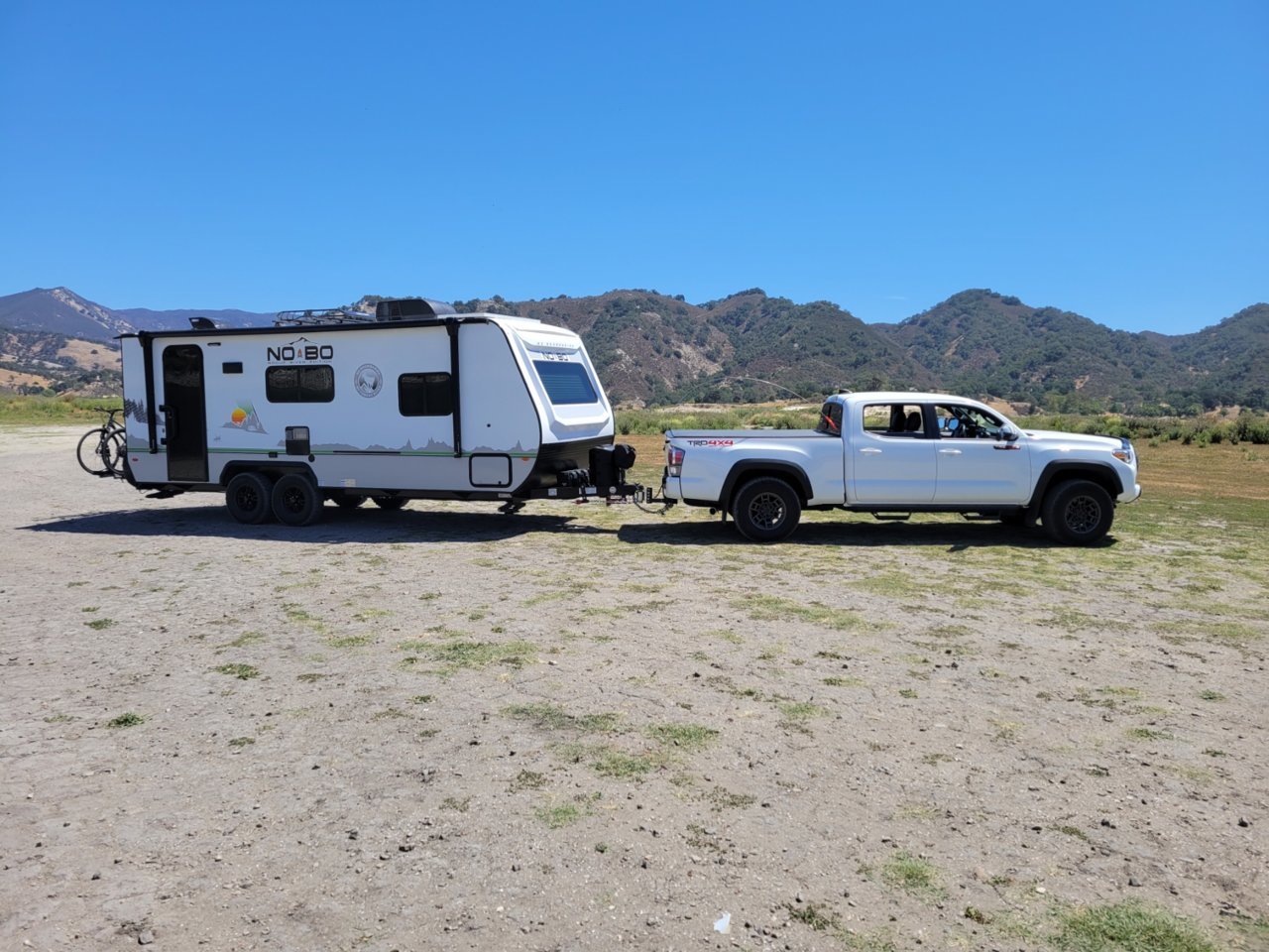

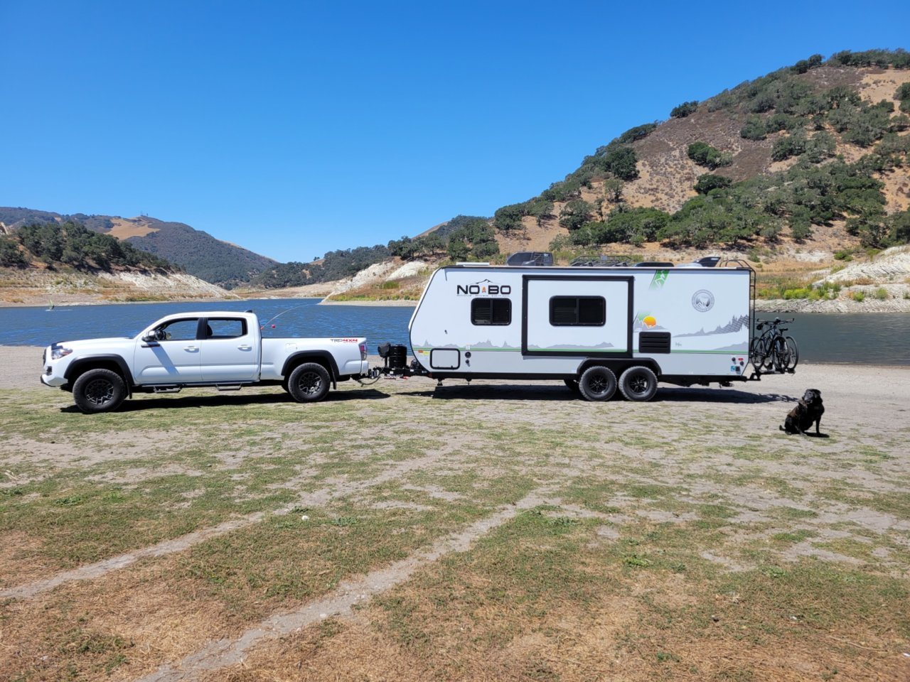

    A pic of all my shit down below to illustrate my configuration that is pretty new to me as I just bought the trailer about 2 months or so, ago. You've likely bounced off your truck's payload capacity as configured with the Leer and Decked system onboard so now you need to be diligent about weights your throwing into the bed as well as the coach but it's all doable if always keep the weight and load foremost in your mind. If you haven't bought your Weight Distributing Hitch, get the Andersen system because that entire hitch is half the weight, if not more, than the usual trunnion or load bar style WDH. It is also is a better and easier hitch system to work with so there's no compromise by going lighter.
    As you get your load out configured like you think you would on a travel day, find a CAT Scale system near you and set up an account with their phone app. It's pretty bitchin to be able to pay and just drive up on the scales and get a real world measurement of your weight distribution, your front and rear axle weights, as well as your trailer axle weights all at the same time. I did that with my rig that has a 4200# published weight and after 2 measurements, I played with the WDH and easily was able to put 250# more on the steering axle than before and that put me right in the design specs for all published axle weights as well as being well under the GCVWR with a good, safe margin.
