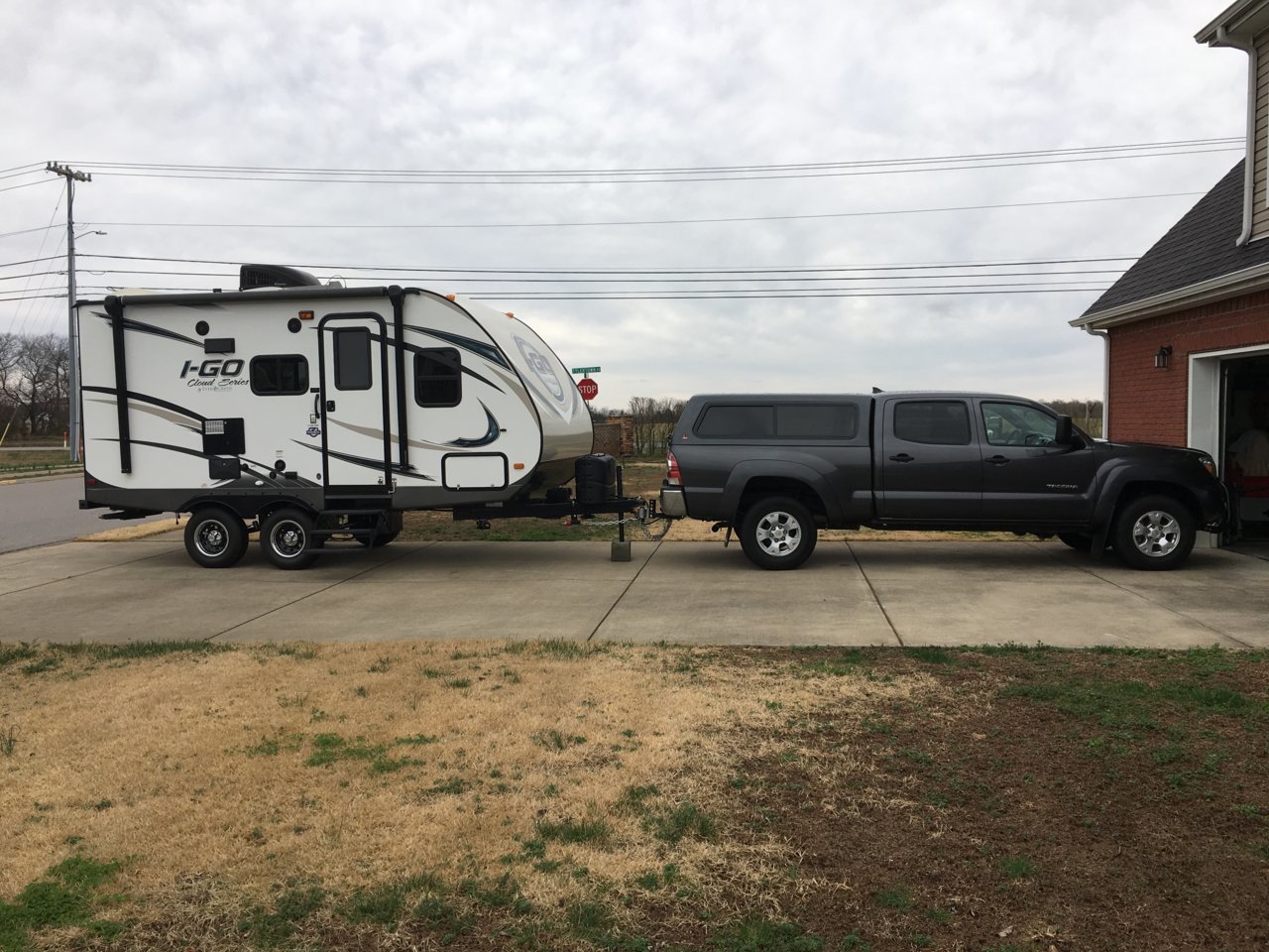

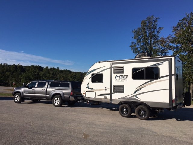

    Welcome aboard:hattip:. This camper is 4200 ready to camp.

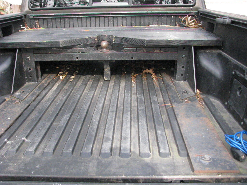

    Not a true gooseneck. More of a ball on a crossbar and, best I can tell, unique to the Scamp 19'. The uprights are bolted to two pieces of 60" x 6" x 3/8" flat stock which are fastened to the frame using the stock bed bolts. Works well.

    I attached pieces of decking board above the cross bar so that it lined up height wise with the fender wells and then laid 2x6's from the bar to the front of the bed to provide a level platform. This allows just enough room for my Honda genset on the left, a Scepter 5 gallon gas can in the middle and a 45 qt Pelican cooler on the right - all forward of the hitch ball. There's still sufficient clearance for ninety degree turns without the nose of the camper contacting the genny or the cooler.
    The initial picture above was taken at Comb Wash, UT when I was testing a new 105 qt Ozark Trail cooler for Walmart and I had to rotate the generator ninety degrees and move the gas can to the left side to get everything to fit. That cooler worked well but I couldn't turn as sharply with this configuration. The Pelican will be used when towing the trailer and the OT when tent camping.

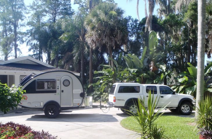

    Definitely keep it as small and lightweight as you can be happy in. Try to remember and convince your "other half" that it's for temporary use. That you don't have to bring the house. Once you start to narrow the model down the model, get on the web and find it'd related interest group/forum. All trailers worth the time have one. See what's up with your choice. We looked at the Airstream Bambi 16 but really watched the weight. Even as we ponder getting a new 3rd gen. We decided on the Nucamp T@B mostly on build quality and resale value. They are hard to find "fairly" priced, since most owners are really proud of them. Check out their main group: https://tab-rv.vanillacommunity.com/
