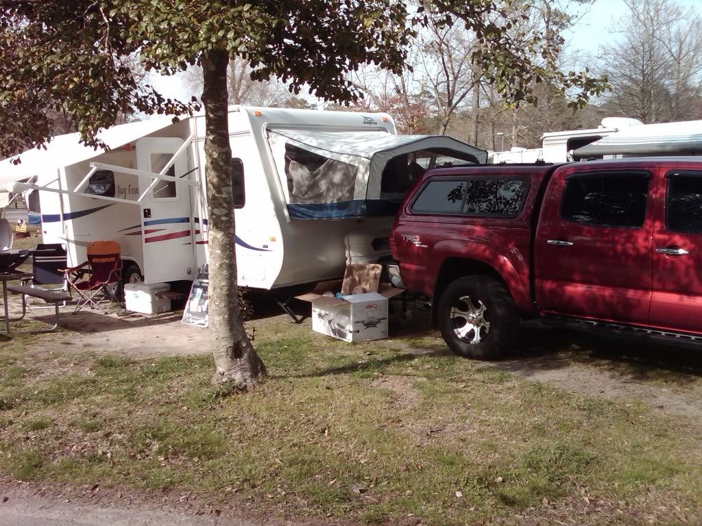

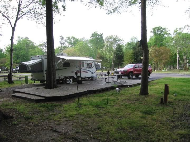

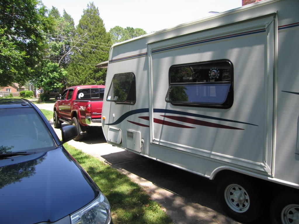

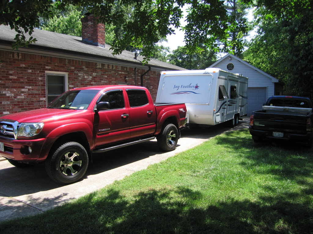

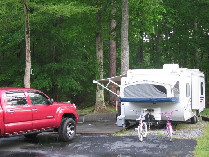

    I pull a 4200lb - 23 foot hybrid camper. When loaded it is more like 5000lbs. I have 32" tires and the trd exhuast. With the electric brakes i have no problem towing at all. I actually caugth myself going 80mph on the interstate on the way home from camping last weekend,

    Here's a couple of pics. I'll post more tonight. Just took some yesterday.

    Nice set-up RedskinRed Taco. Looks good with the truck.

    is that a Deck at the campsite? Nice! except for splinters.
    Twotacos, nice.. great pics thanks for sharing!

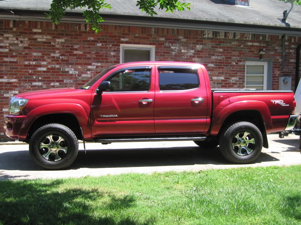

    Yep two taco's. The Blue one is my company truck. I love that i'm not running up the miles on my TRD. Scored my TRD 1.5 years ago with 16,000 miles. And just flipped 26,000 a couple of weeks ago. Bought it at the perfect time when no one was buying cars. Scored it Toyota certified for 4K under nada.
    I usually only tow around 70mph when towing, but was passing someone and got up to 80mph last weekend. Didn't know that about bias tires. I will have to check and see what i have. I've only had the camper 2 months. I want to switch to some alum rims anyway. Might switch tires too.
