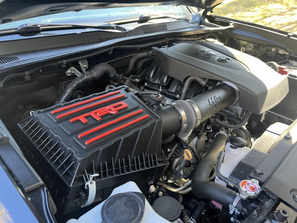

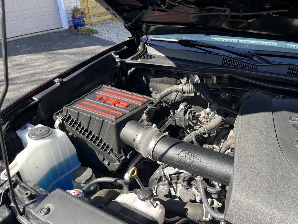

    Just following up, not trying to beat a dead horse here. But I figured it would be helpful for the next person who searches, if I added my experience and some part numbers.
    I ended up installing:
    - Toyota TRD Upper Airbox- Part Number: PTR03-35160-AA. This is a direct replacement for the stock upper airbox and doesn't do anything extra except look cool.
    - Toyota Intake Flow Accelerator- Part Number: PTR03-35160-AE. This easily replaces the stock part, and installs very easily.
    - Toyota TRD Air Filter- Part Number: PTR03-34140. Drop in replacement for the stock filter.
    - K&N Performance Air Intake tube: Part Number: 57-9039. This was supposed to be an exact fit, but was a little long, I ended up having to cut about an inch off of it (at the airbox end). I tried it with both the TRD and the stock upper airbox, and it was too long for both, so it wasn't a difference between those.
    All in all, I don't know that any of it helps with any noticeable hp gains, and I haven't had it long enough to notice any increase in fuel mileage. But it does effect the sound of my TRD cat-back, and it sounds perfect when you get on the throttle. Not obnoxiously loud at all, but definitely sounds nice.
