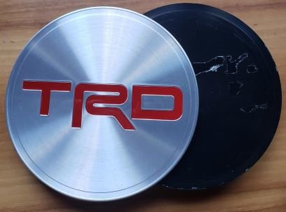

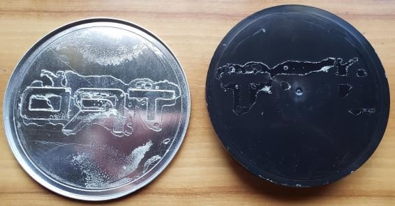

    I finally got around to looking into the adhesive issue with the new TuRD Center Caps. The issue appears to be not accounting for the height of the embossed letters on the inside of the disc. According to the "trusty" Husky digital caliper the height of the letters is 0.25mm. The area of adhesive on the plastic center cap was concentrated only on the area of the letters. As a result of not taking into account the letter height; the adhesive that was applied to the inside of the aluminum disc was not able to contact the plastic center cap above or below the TRD logo. This manufacturing oversight causes the aluminum cover to begin separating at the edges from the plastic cap.
    I have three of the newly release TuRD center caps that are experiencing this issue. Looks like it will be 3M to the rescue. However, which double sided tape product will work best based on the height of the logo and keeping the center cap flush to the wheel when mounted?

    I picked up some 3M VHB 9437 double-side tape. Proceeded to scuff up both the inner surface of the aluminum disc and the outer surface of the plastic center cap. Taped the two pieces together. The bond appears to be strong. But only time will tell. :thumbsup:

    Good observation / good decision to go with the VHB foam tape. We use double sided VHB foam tape to attach our cap lenses as well. Not sure why Toyota just applied glue to directly to the back of their lenses, but hopefully they get it fixed for you guys with their new batch.

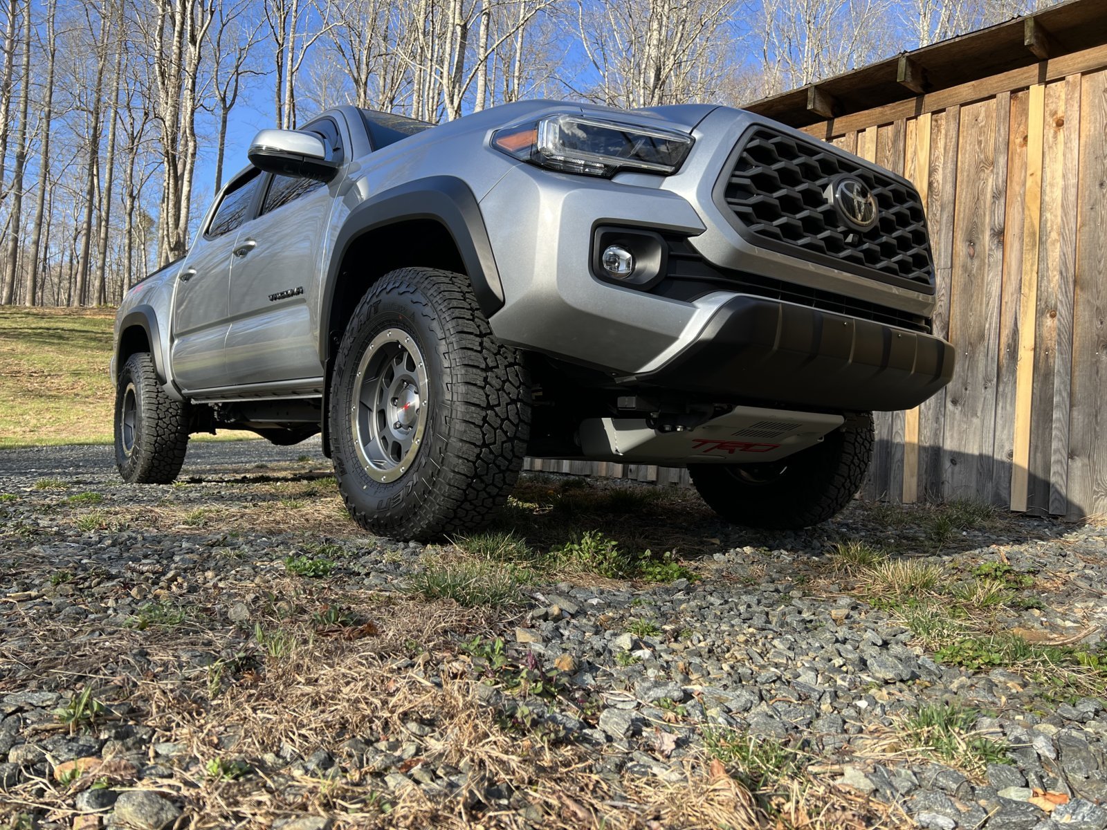

    Finally got around to putting the rings on - I used a small torque wrench I use for my bikes. Set to 75 inch pounds, a spec I found somewhere on here.IMG_3857 (3).jpg

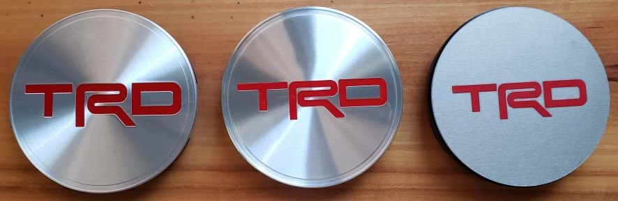

    Let's play a game- Pick the OG Center Cap (PTR18-35092) Left/Middle/Right
    The Right-most Center Cap and three others like it are available => here

    Left most?????

    middle
