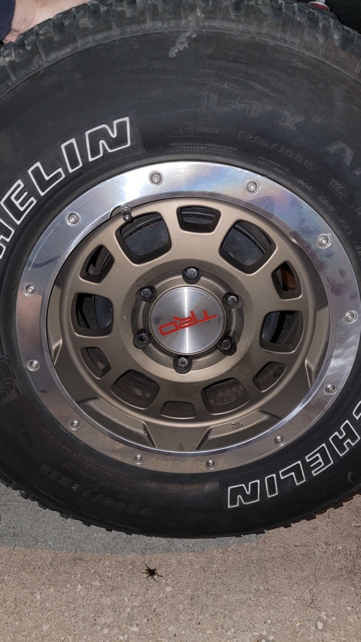

    Hello Everyone,
    First post on the fourm. Anyone ever experienced issues with these wheel cracking? I've owned these since new and have 180k on them. They have always been removed and tightened by hand. When crack was found nothing was loose or excessively tight. Any insight would be appreciated.
    Thank you, John

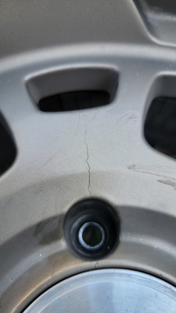

    That crack is right at a lug hole, the crack can easily happen if too tight of a torqueage. I had a tire shop phuck up a rear wheel lug when they remounted after a balance. When I tried to remove the lug nuts one of the studs just broke, all the lugs where too tight on that wheel, fortunately the wheel survived. The stud was EZ to replace. Your wheel is too...

    If you find a place that repairs cracks on the face of the wheel, you've found a place that doesn't know what they're doing.
    Never try to repair the face of a wheel.

    Amen, wheel crackage plus the tons of heat to repair = left with very brittle alloy, no bueno...
