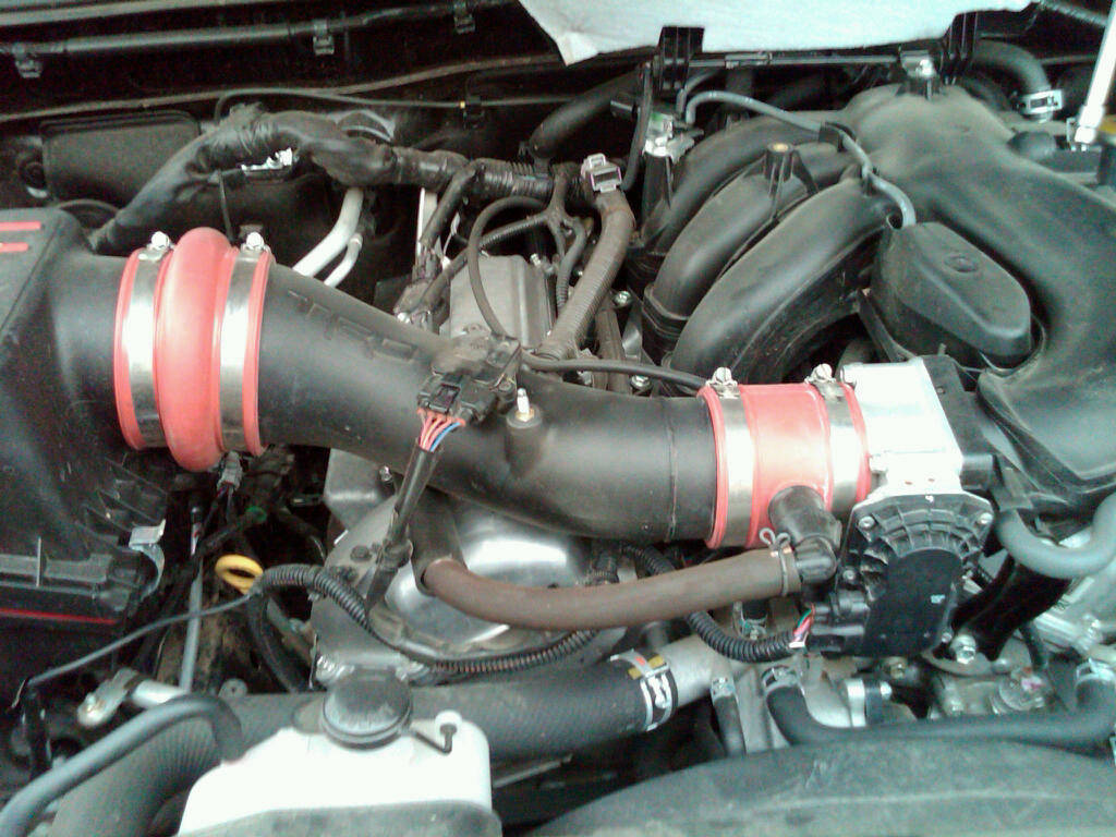

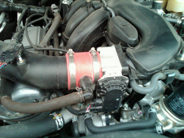

    sorry for the delay in posting the pictures, I'm not real good with computers. The areas where I see changes in the new cold air system are 1) the tube seems to have been modified to give a better angle coming into the mas air fow sensor. 2) the red gasket is of a softer rubber so as to flex when tightened and not loose its seal. 3) the air box mounting holes have been modified so the box now clears the arm of the windshield washer resevoir. The old box rode on to the washer resevoir and caused the box to seperate and cause it to have a gap abive the filter element. I have put over 1,000 miles on the new system with no check engine lights. This is everything from highway to off road with hard ac[​IMG]celeration. My buddies 2008 TRD Sport has the new kit installed and it cured his light problem also. I hope the pictures help.

    I can not really tell the difference in these changes , maybe a can try again a new installation.TKS for the pictures.
