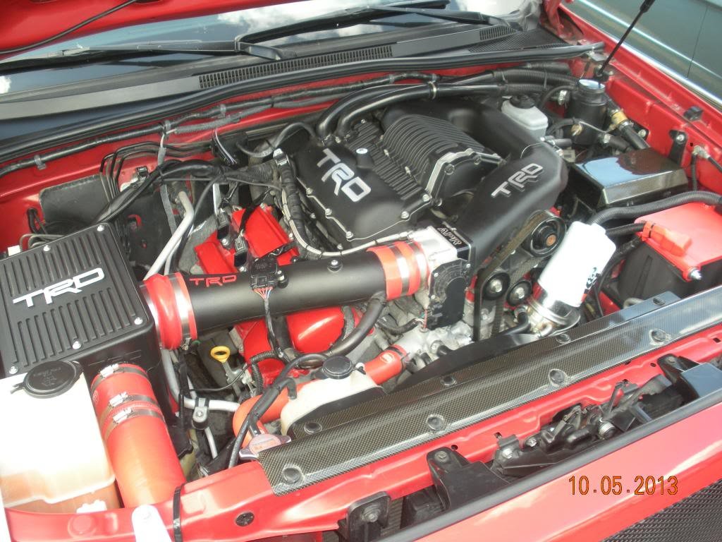

    Hi guys. I have an 05 tacoma with the trd cold air intake. My red couplers are cracked and deteriorated. I'm in Canada and am having a heck of a time sourcing a company that will ship these to canada. I've tried AFE. Any ideas? Or can someone on this site send them to me possibly. Cheers guys

    I used silicone hoses instead. These are a lot stronger and easily found on ebay.

    You need a 4" I.D. x 3" lg Hump Hose (4 ply) and a 3" I.D. x 3" lg. straight hose (3 ply).
    You can usually get them in red, black & blue.
