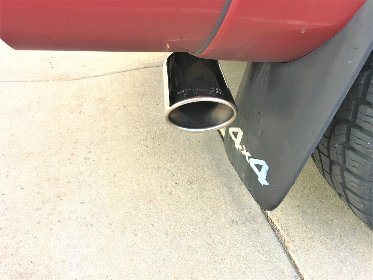

    Anyone know how to get rid of the highway speed drone that's deafening on long road trips? (oem TRD catback)
    I heard the trick is to buy a Vibrant 1141 resonator and then take it to an exhaust shop to weld it in
    Though I'm not 100% sure if the resonator is meant to address rasp, or drone
