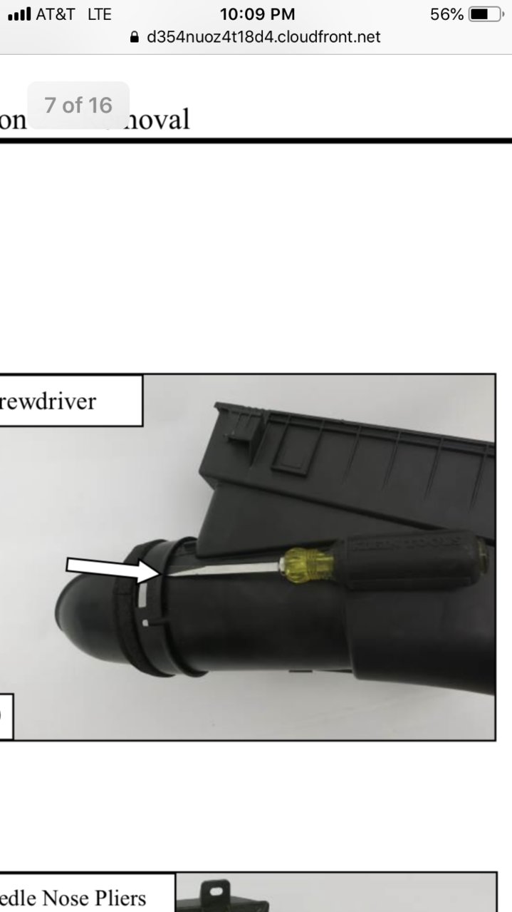

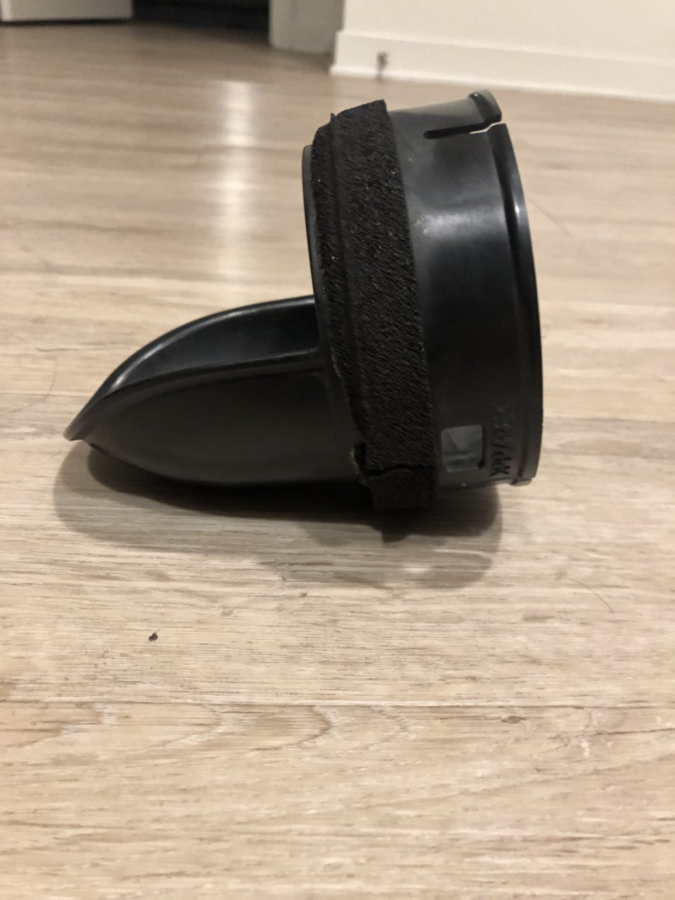

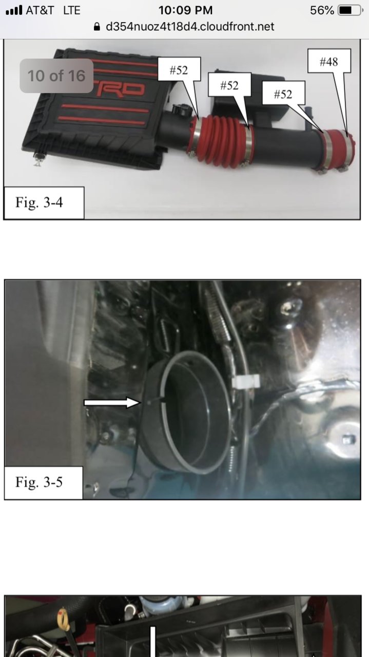

    I just installed a TRD CAI and I’m not sure if I did it correctly. Am I supposed to keep the OE Air Inlet duct in place and put the TRD Air Horn on top of it or put the TRD Air Horn directly into the fender? C22FFEA2-4BC2-4D13-8038-29531962E8D3.jpg1F42E60D-55D6-4D53-B12C-5E9263F4C4CE.jpgE9862C14-120B-40E4-B123-3AA90CD09155.jpg

    That little piece is a splash guard to prevent water and debris from going into the intake. If that’s what you’re wondering about putting on, then yes, keep it on there.

    Replacement. It seals air coming in to pull from the fender and not the warm air in the engine bay.

    No, take the factory one out and put the TRD air horn into the fender instead. As mentioned above, it's a replacement part.

    Trd air horn directly into fender and toss (remove) the OE one.

    That’s what I did. I just wanted to be sure. Thanks everyone for quick responses!
